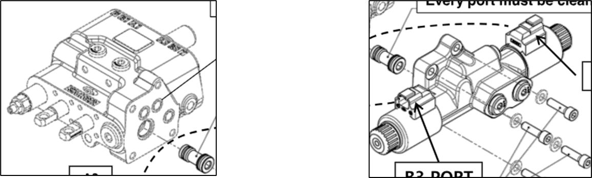

딜러에게 설치까지 맡기셨나요? 아직 딜러에게 연락할 일이 없어서 어떻게 처리해야 할지 모르겠네요. 딜러가 이런 키트를 주문해서 고객에게 전달하는 게 일반적인지 궁금해서요. 저는 직접 설치하고 싶은데, 딜러가 키트를 주문해 줄지 확신이 안 서네요. 아니면 이런 OEM 3차 기능 키트를 어디서 사야 할지도 모르겠어요. 제조사에서 딜러가 아니면 이런 제품을 판매하지 못하게 하는 게 정말 짜증 나네요. WR Long, Summit, Lane Shark 같은 제품은 온라인에서 찾을 수 있는데, 특정 브랜드 키트는 찾을 수가 없어요. 이유가 뭘까요? 저는 TYM 3차 기능 키트를 사고 싶은데, 특히 기존 로더 밸브 뱅크 아래쪽에 밸브를 바로 고정하는 방식이 마음에 들어요. 로더에 고무 호스를 케이블 타이로 묶어 놓는 것보다 훨씬 깔끔하고, 트랙터 어딘가에 별도의 밸브를 설치해야 하는 것도 불편하거든요.
Here are the kit part numbers below.
Open Station : 13815800000
Cabin : 13835800000
If your local dealer doesn't have them in stock, it might be worth reaching out to some of the larger dealers further out who ship nationwide. I know there are a few dealers out there who really pride themselves on their parts shipping business and taking care of folks at a distance.

Did you have the dealer do the install as well? I still have not had to contact my dealer so don't know how they are to deal with yet. The reason I ask is that I want to know if a dealer would typically order a kit like this and just hand it off to the customer. I want to do the installation myself and am not sure if they'll just order the kit for me. Otherwise I have no idea where to buy this OEM 3rd function from. I find it really annoying that manufacturers will not let businesses to sell these types of products unless they are a dealer. I can find WR Long, Summit, Lane Shark, etc all online but no brand specific kits. What is the reasoning for this? I def want the TYM 3rd function kit for the hard piping and really like how the valve bolts directly on the bottom of the existing loader valve bank. This is much cleaner than having rubber hoses tie wrapped along the loader as well as having to bolt a separate valve on some random part on the tractor.
I bought mine from my dealer. I found a video from Tony’s tractor adventure on the install for the T25.
/ TYM T474 3rd function kit options #23
There are several videos on YouTube, which can walk you through the process of installing the factory kit. And a few which go over the install of second vendor kits, there is one for sure which the guy installs parts of eBay.
TYM will drop ship the kit to you, but it has to be ordered and paid through a TYM dealer. A major advantage of the factory kit, is that it comes with hardlines, and the connectors, and custom brackets. And, it can be installed in a few hours.

Doing the installation is not concerning for me at all. In fact I would much prefer to do it myself than to trust anyone else. I'm very mechanically inclined and used to be a maintenance mechanic years back, therefore I would take the time to get everything perfect where it's my personal tractor. Dealers are getting paid by the job so their goal is to pump out as many jobs in one day as possible. I just don't necessarily trust their attention to detail because of this.
I appreciate the information on what the TYM part number is for the T474.
