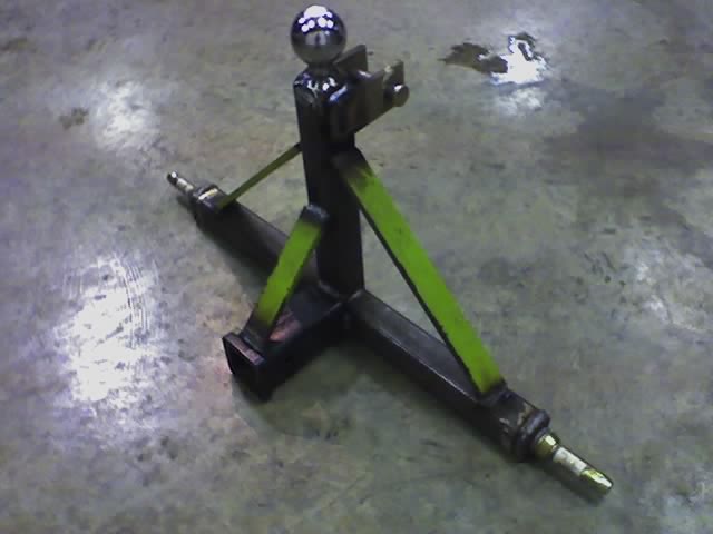

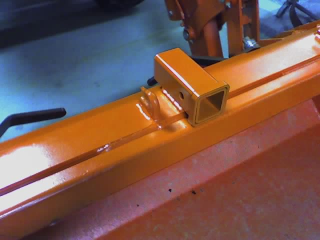

Now, to confuse you a bit, here is another option. I'll readily admit that this wasn't my idea I borrowed this from someone else. After I'd welded 3 'weld on' (if you're paying them to weld them on, don't let them weld on 'pin on' hooks) hooks, I decided to copy what I saw a contractor using. That was a hitch insert welded on the center of his bucket. If he needed a hook, he just used an insert that had a hook on it. If he needed a ball to move a trailer, he just used an insert with a ball. Here's what I'm talking about (and, yes, you can see where I'd already welded a hook on before I saw his setup. :eek:
Also included is a picture of something I welded up for the 3 pt. hitch with scrap steel, but it isn't nearly as useful as the insert on the bucket. For me, it's easier on my neck to see what I'm doing in front of me rather than behind me.

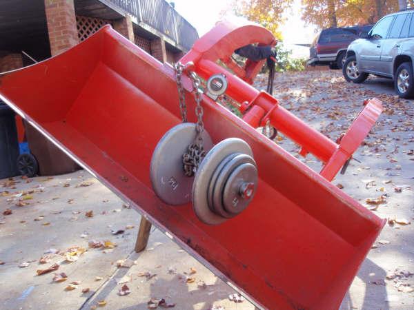

Reg, the possibility of sideways slippage was seriously considered in the design of the BXpanded hooks. Not to get into a discussion of the geometry of the system, but unlike screw type clamping systems, it is essentially a self tightening clamp. The heavier the load the tighter the clamping force. I'm attaching a photo of a quick simulation of a side hill situation. The loader is tilted 40 degrees from horizontal which is far steeper than a load carrying tractor can sidehill. (I wanted to tilt it farther but the loader tried to turn over on its side.) The load is only a little over 100 lbs but that's pretty much all I felt like handling after lifting the side of the loader.:)

I can see how clamping force could be made a direct function of load, it wasn't obvious from the video I watched that these devices actually do that.
So, , , too bad they're Kubota bucket specific, but I'd guess you have a large enough market right there without having to design for every bucket lip profile.

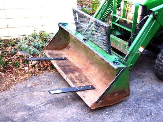

I'd go with the three hooks. Reason being is that I have just acquired a new used tractor and had some modifications made to the bucket as shown on the attached picture. Just wish I could have found the proper weld on hooks.:D
