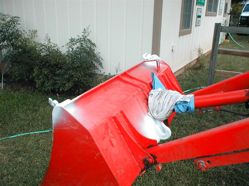

Going on 4 yrs of lifting w/3 hooks on a BX23 FEL, so far so good.....
Go for the 3.
