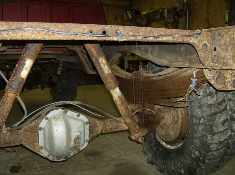

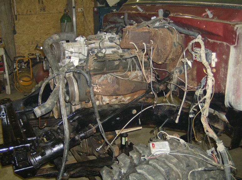

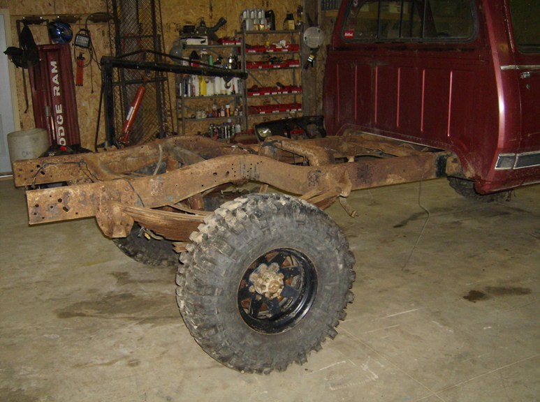

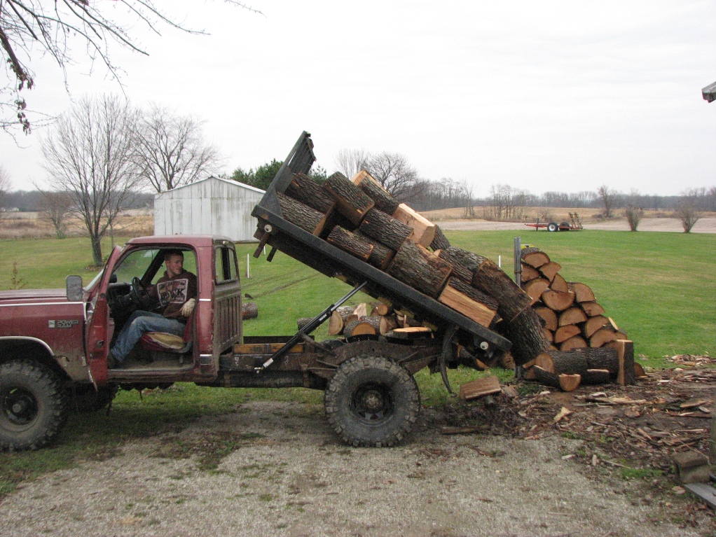

I havent been on here in awhile due to working on my latest project for the last couple of months and I finally got it done so I thought I'd share some pics.

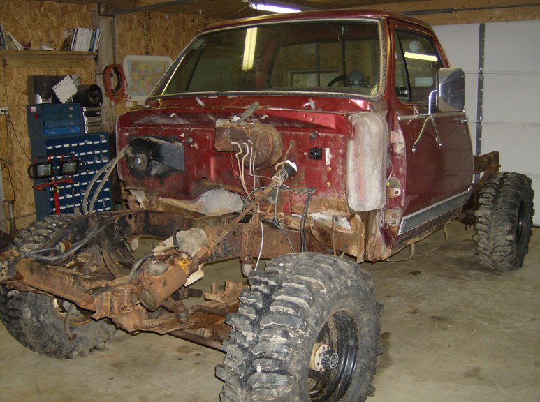

The truck is a 1985 Dodge W350 with dana 60's, 35x16x16.5 boggers, and a custom 203-205 double transfer case.
Here's how we started:
/ turning 1985 dodge into a real workhorse
#2

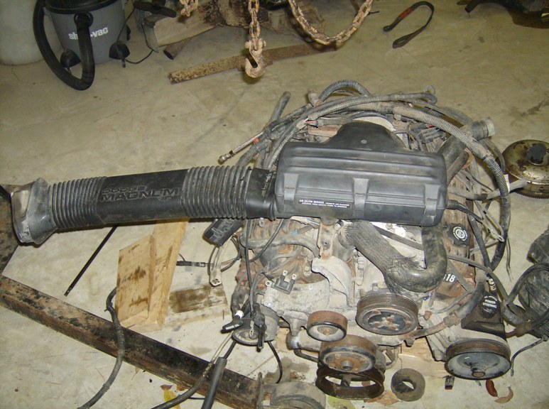

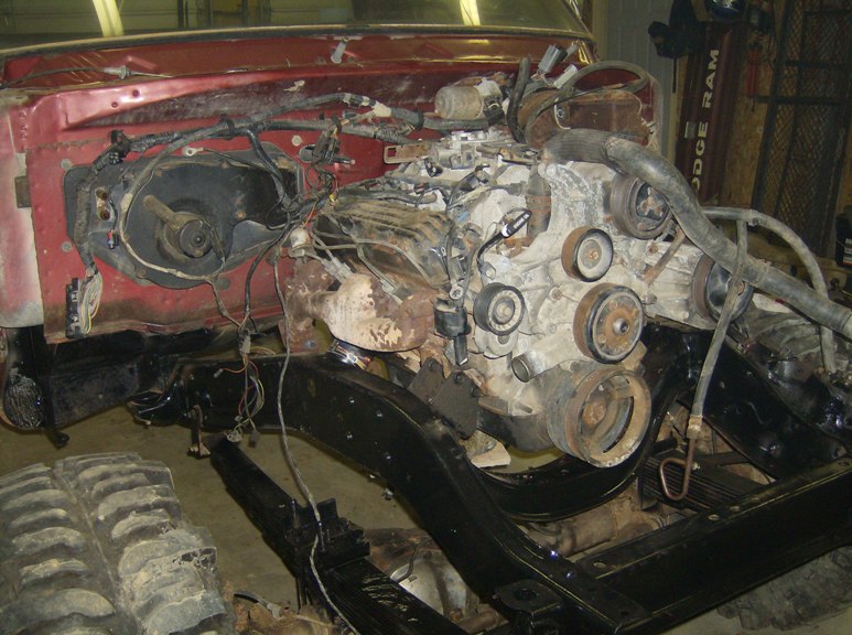

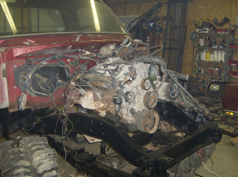

The new motor. 5.9L Magnum swap. Ahhhh the cold weather reliability of fuel injection

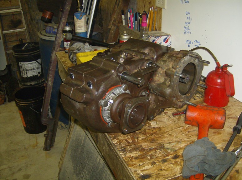

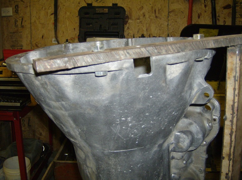

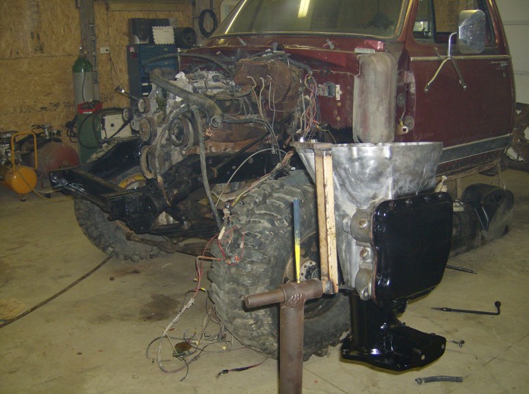

Rebuilt the trans and transfer cases. I had to notch the bellhousing for the crank trigger, and grind the weight off the torque converter because the 5.9L's have the weight on the flexplate

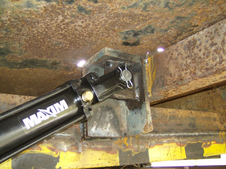

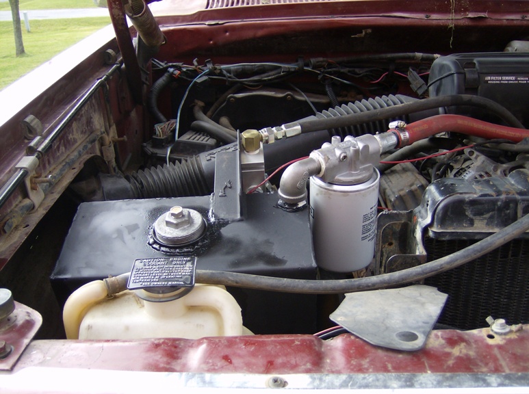

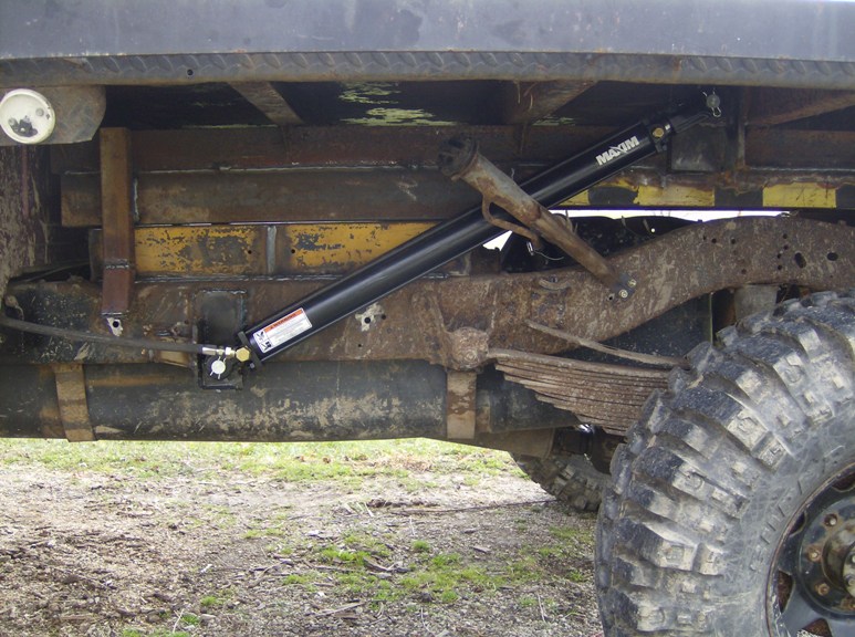

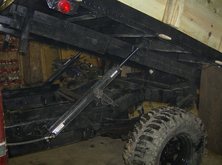

Now for the good stuff...The dump bed.

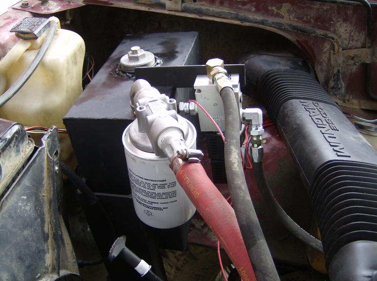

This is the under hood goodies

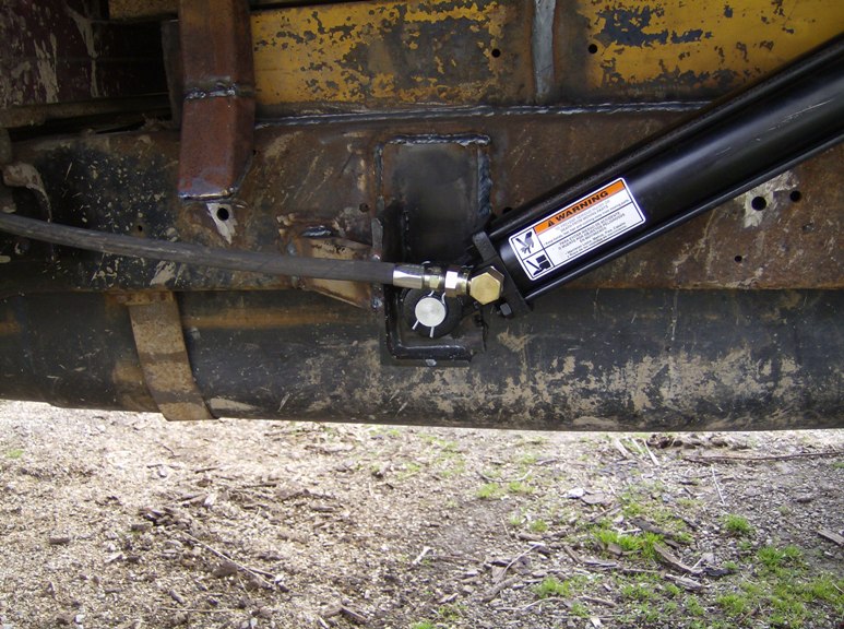

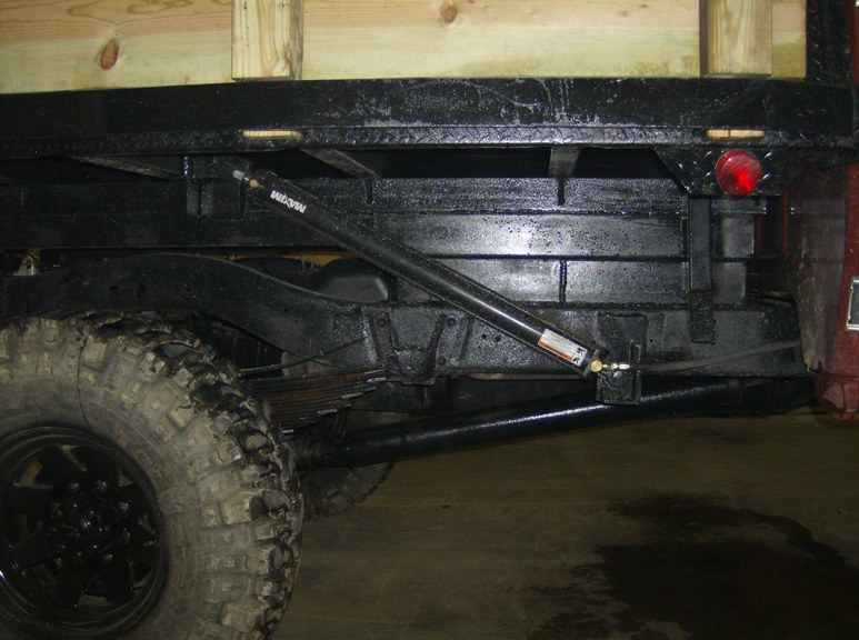

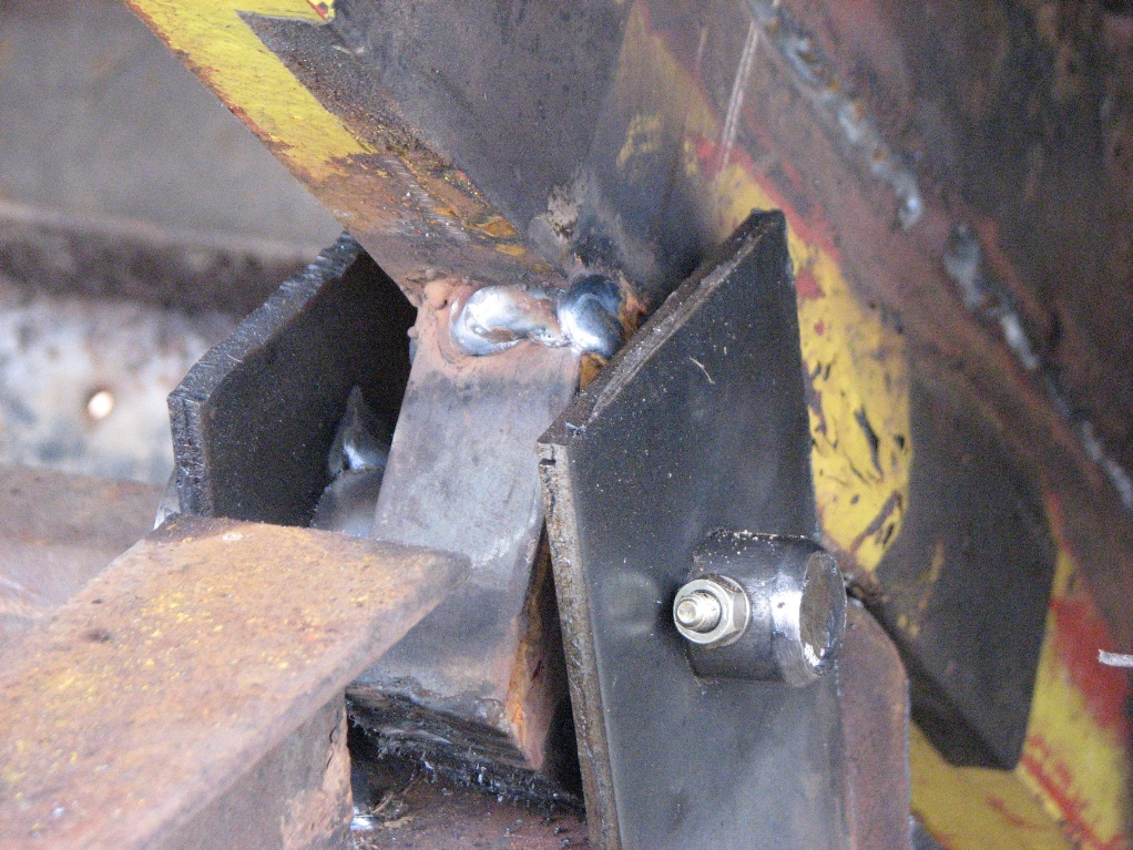

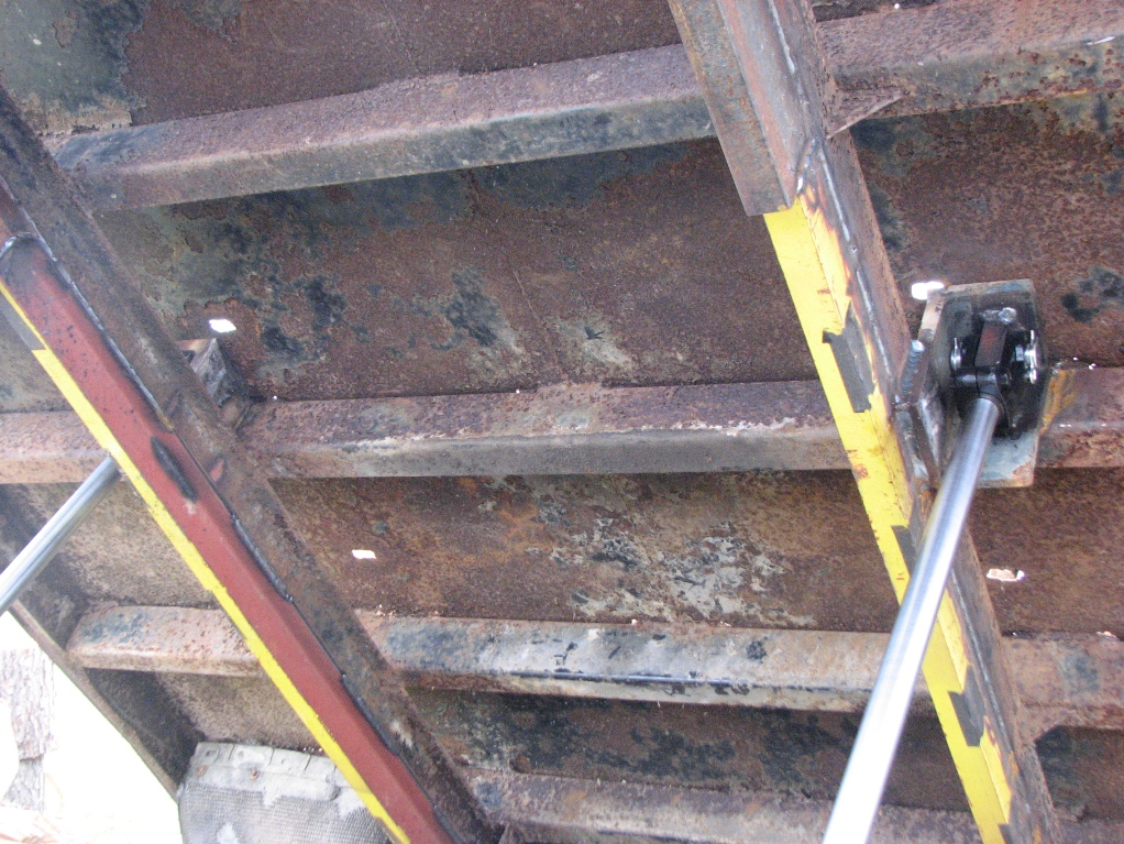

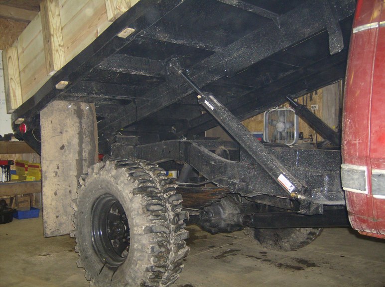

Some pics of the fab work

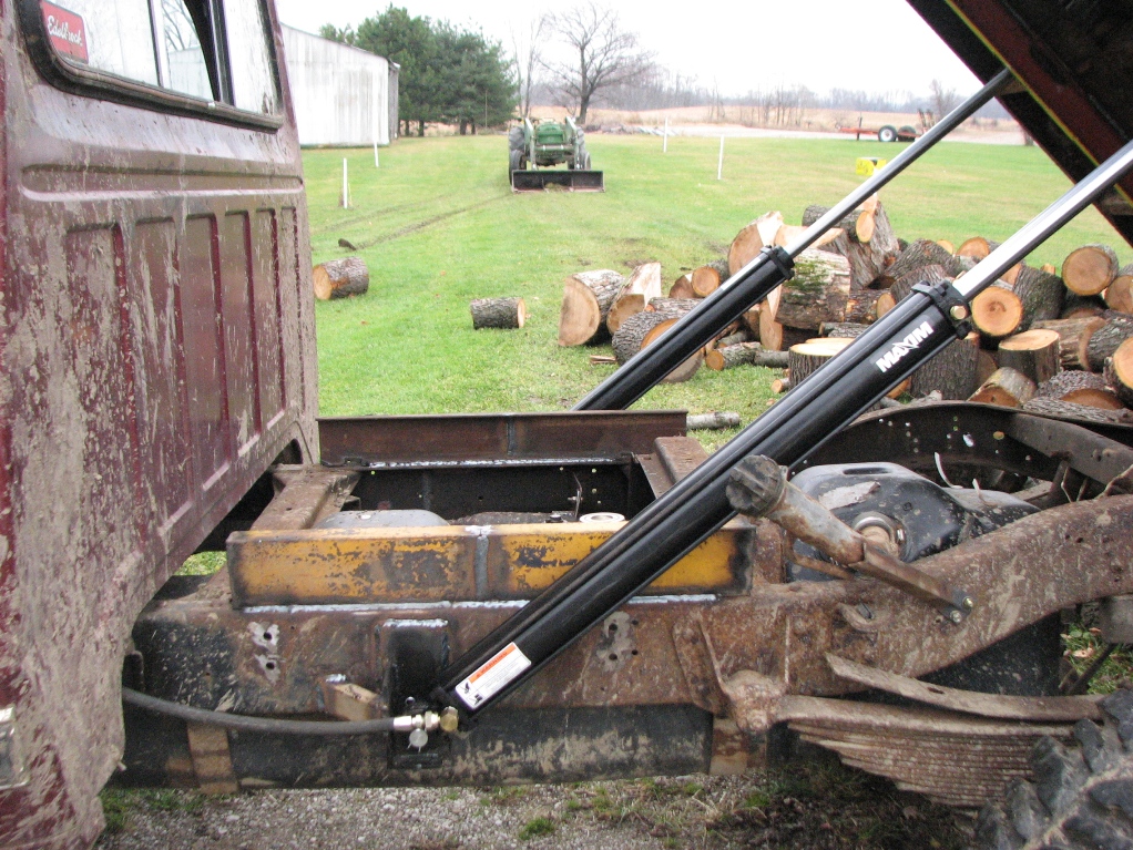

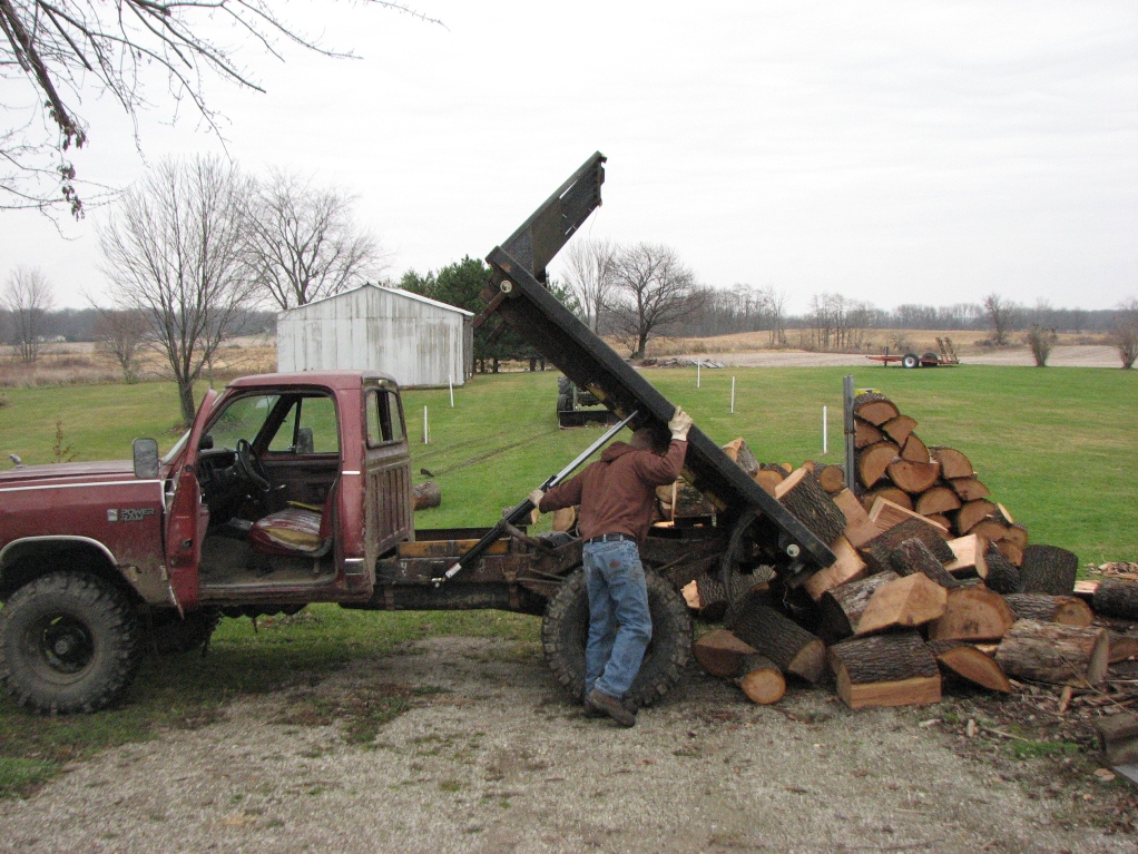

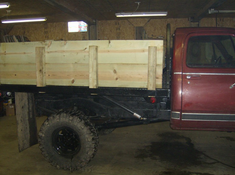

Testing it out before the paint job

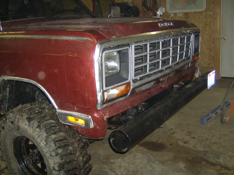

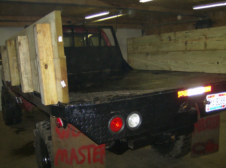

Final product, with custom bumper
#9

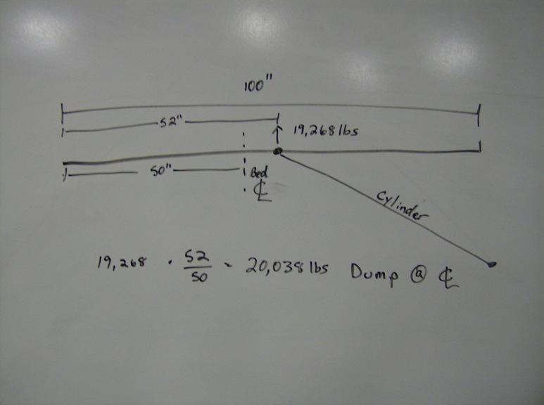

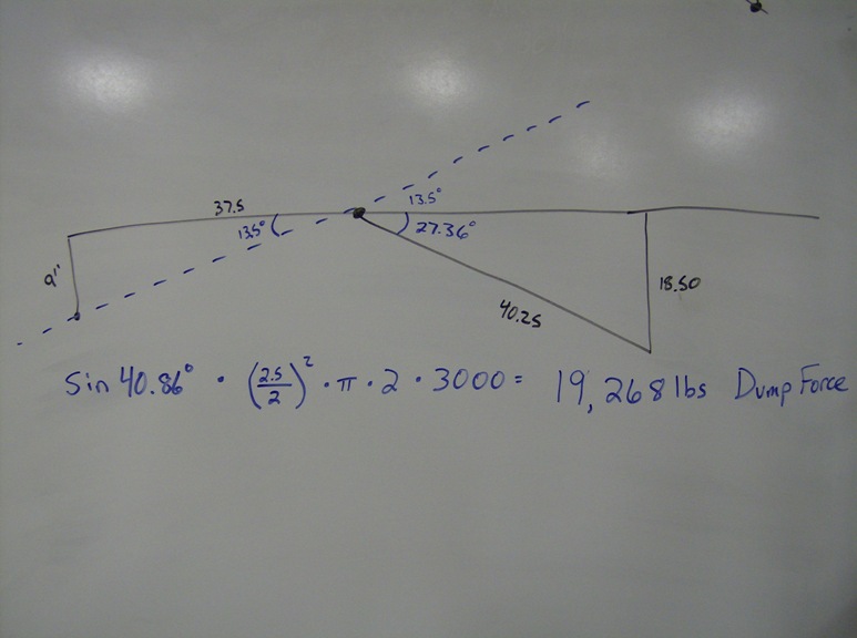

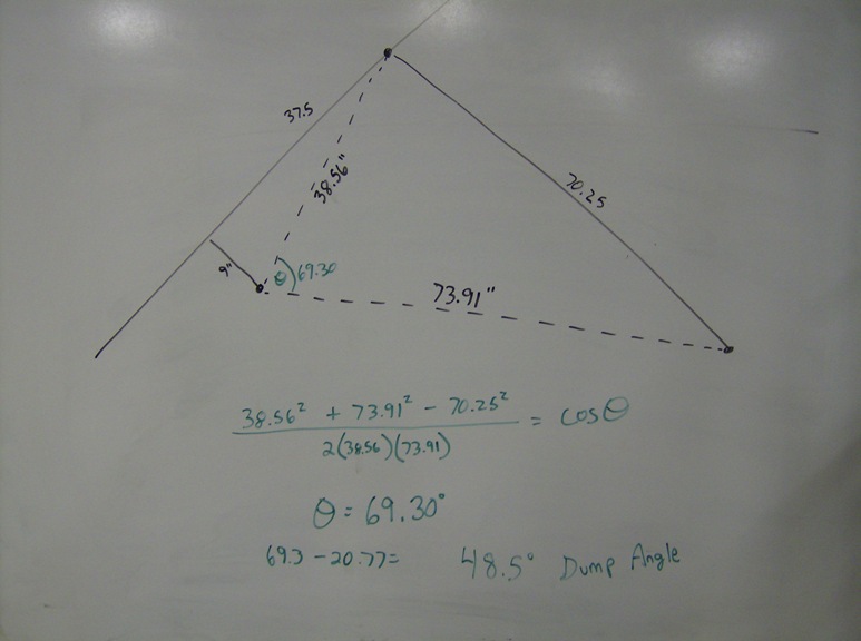

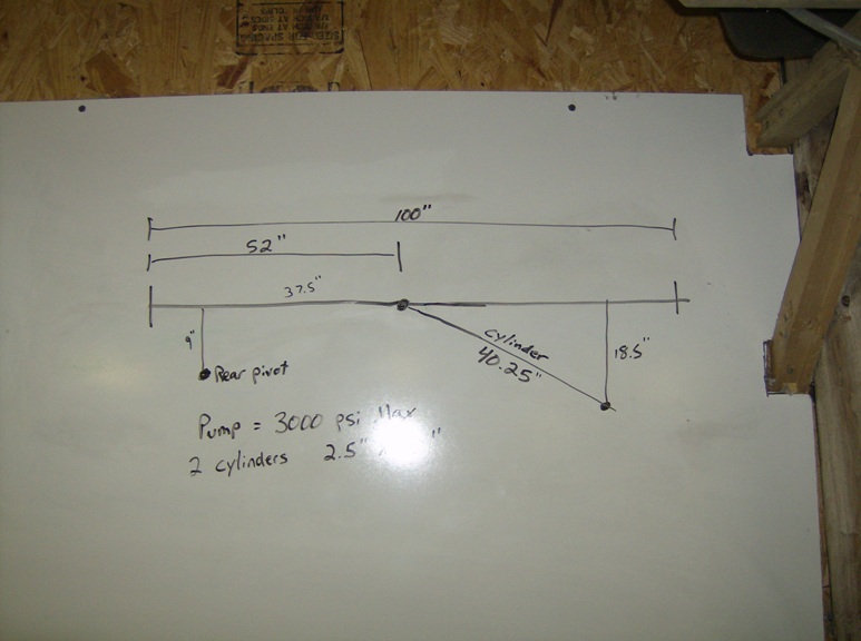

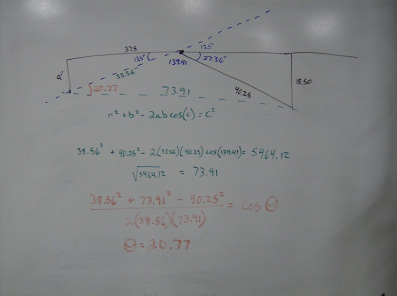

The final figures work out to be 20000lbs dump force to a 48.5* angle.
It is a bit more force than I had in mind when I was first sketching but once the fabbing started I was able to get the pivots in better locations than I anticipated resulting in about 3x's the force I really need. Which isn't a bad thing because the pump will only develop enough force to do the work, which will be about 1000psi. So I shouldn't have to worry about blowing any hoses anytime soon.

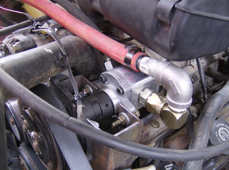

I also forgot to add that the pump runs about 4.8gpm @ 3000psi, which is 2000 truck rpm. It takes 16 sec to full raise but about 2 min to come down, due to not being a power down(which I may change because the DCV has a port for that that I just blocked) so All I would need is about another 25 ft of hoses and fittings.
The Hyd resivoir is a 3 gal that I put 2.5 gal in ( my tractor takes 7.5 gal so it works out perfect fo 2 buckets)
The pump is ran off the AC clutch so it doesn't run but only to dump so I only need enough fluid to fill the cyls.
Heres some pics of my figures if any of you other math/hydraulic fellows want to check my #'s The flash got me in the first pic they are 2.5" x 30" cylinders
