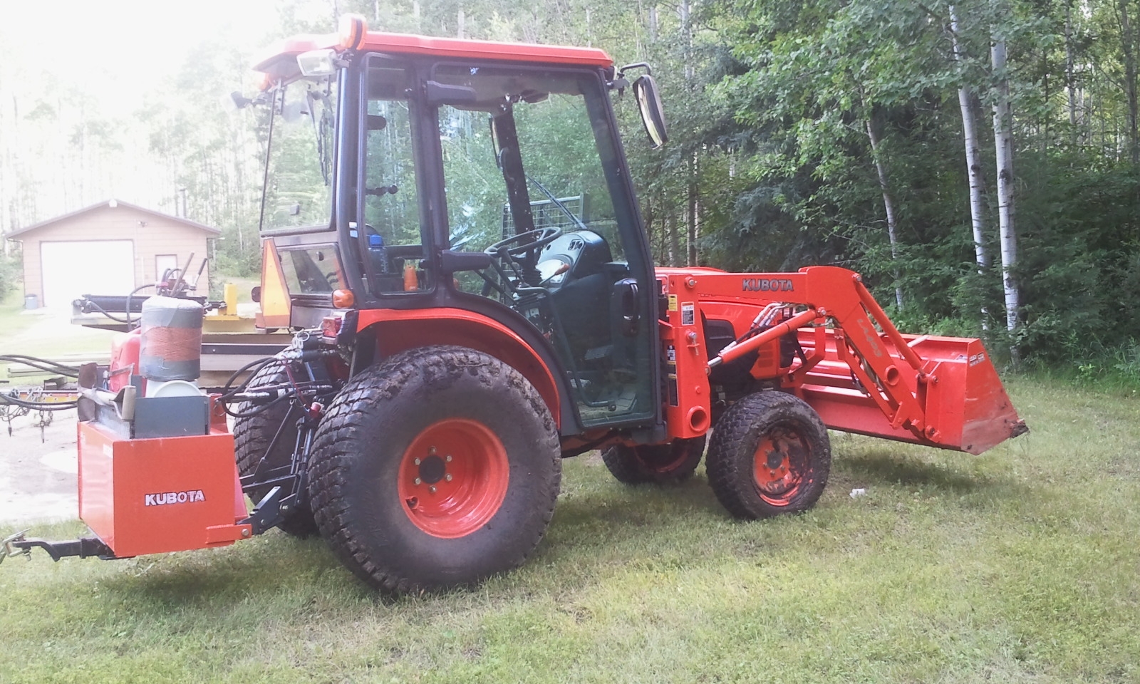

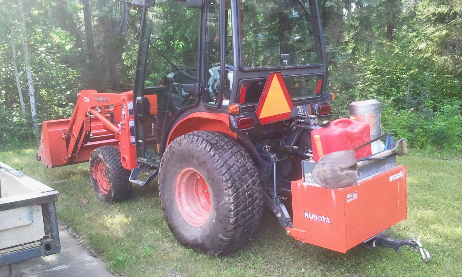

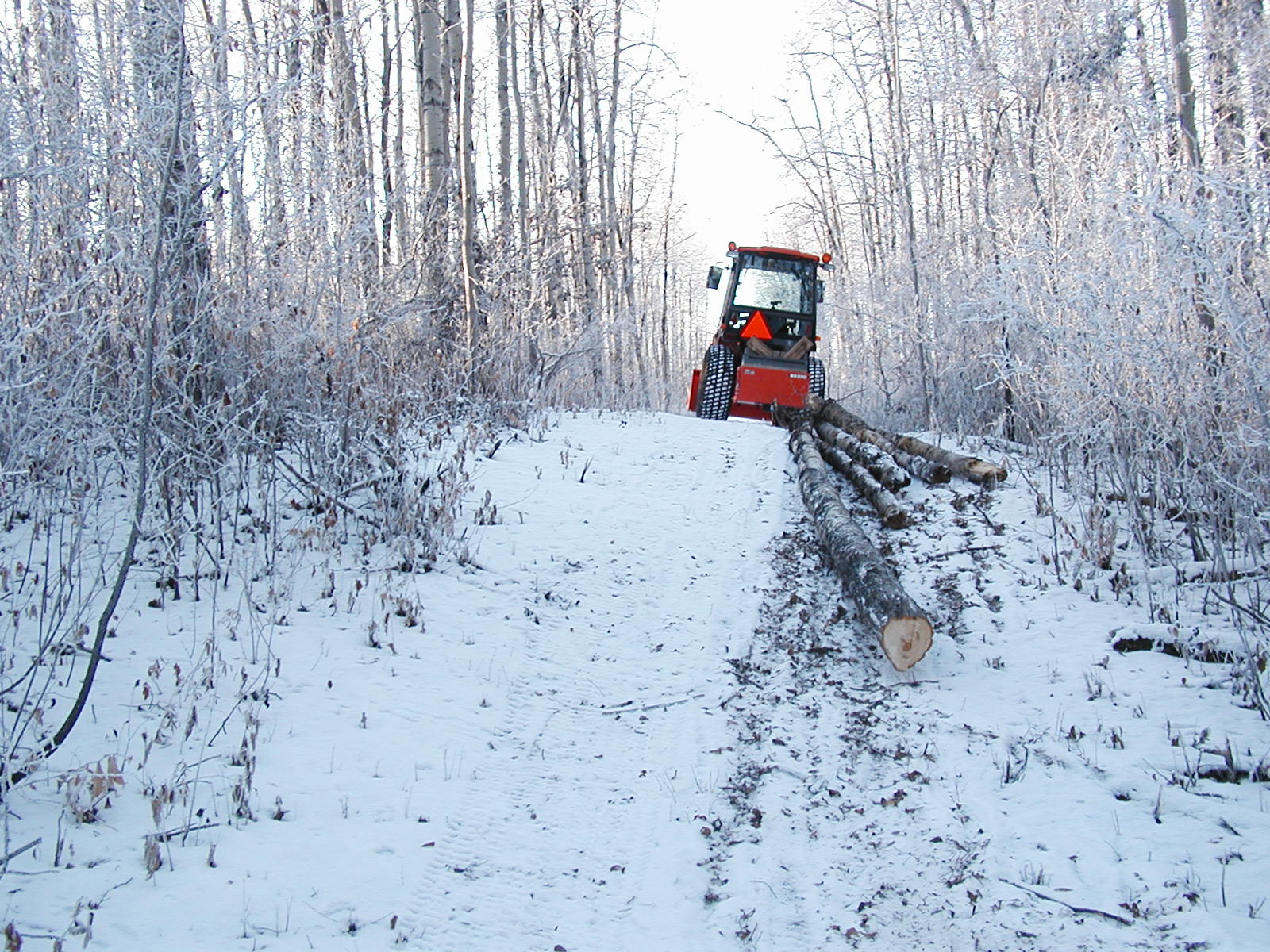

I have never had anything but turfs on the tractors I own or have owned. The reason is I think they are the best all around tire for my purposes. I have yet to get this tractor stuck despite dropping it in a hole last summer that put the cab step under water.

Dude, that's one nice looking set-up! I am jealous of that cab!
I know ag's would paddle through deep snow better, but that's the nice thing about a snowblower. You don't have to. I'm glad I've switched to the turfs. They work good.... for me.

Nice winter shot. I am a sucker for any log skidding pics.
   / Turf tires good in snow? YOU BET! #14
I agree!!!
Best time of year for logging, no brush or leaves, sap... Beautiful box setup for your saws/equipment/fuel/chains... (& Emerg. shovel, smart) and logging hook.:thumbsup:
