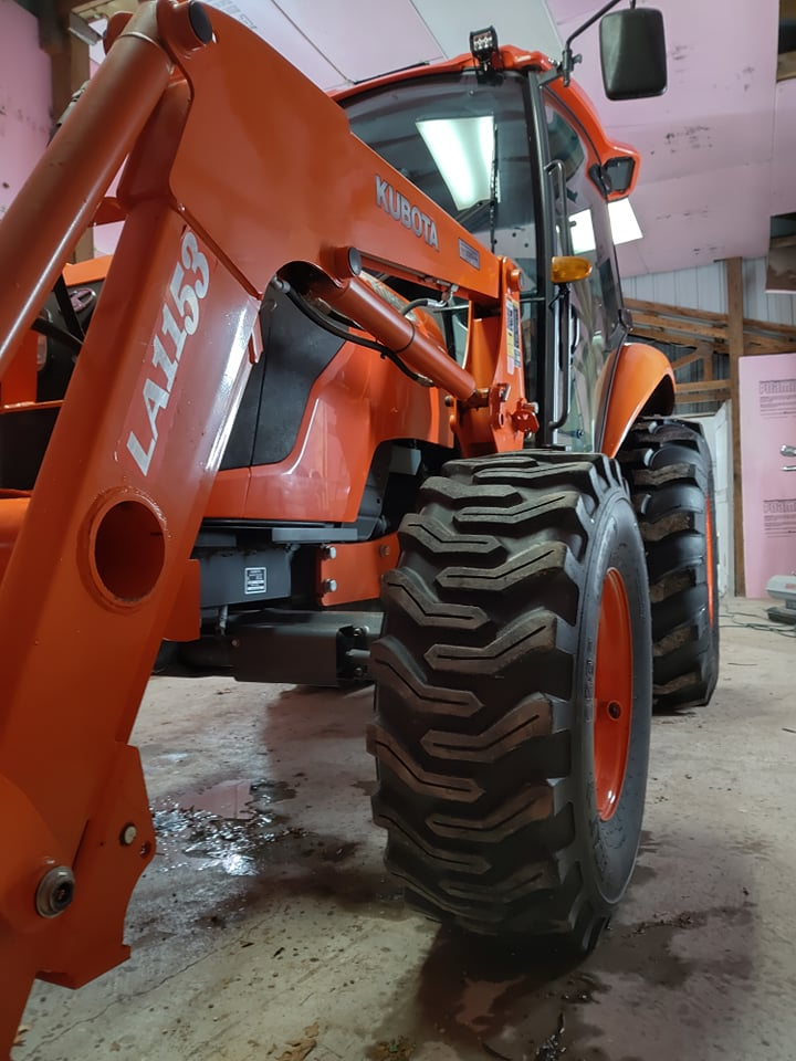

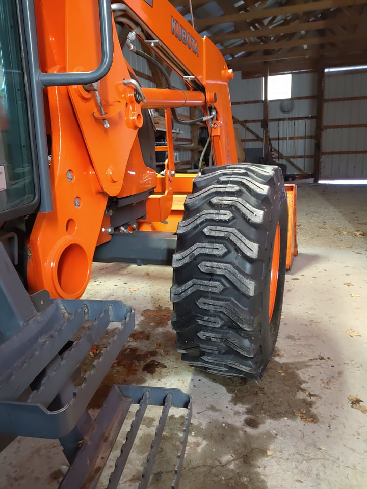

First off I have two disclaimers:
1. Only did the fronts so far.....will do the rears in a couple days.
2. My perspective is that of a first time tractor owner with zero experience.....ever on a tractor.
I found a lot of R4 tire grooving info but only on tractors up to about an L series Kubota so I thought I'd post up the grooving on my M7040 that weighs in about 9k lbs with the loaded rears and loader.
I won't have my 7' snow blower on the back till this week but I did get a chance to clear out 3-4 inches of snow from my paved driveway today.....before the grooving. There were a couple times the rear tires spun a little going up the slight slope with a bucket full of snow and I had to use 4 wheel drive going up a small berm on the side of the driveway to dump the snow. Maybe I could have just locked the rear differential. It has been about 30F today so a few more degrees and the snow may have turned wet. I'm just glad I Youtubed how to remove snow with a bucket. That's how I learned about the bucket float function! This was mu first time doing anything with the tractor other than looking like a newb.
So to get to the actual post about tire grooving a M7040. I didn't want to waste what kerosene I have for my bullet heater so I just did the grooving in 30F temps. In those temps it is a bit of work so I was able to take my jacket off. I think most people will get a feel for it rather quickly. On one of my first grooves I Had the handle of the groover just a bit to low and made a shallow groove. I then had to go back and go deeper. One word of caution if you have to do that, be extra careful not to go too deep as it will want to. From that point forward, it was super easy to have just the right dept with just a shallow groover barrel to tire angle. Doing a couple lugs and then pausing to let the iron heat up again made the job take about an hour to do the fronts.
As a poster on a green forum said (Kenny) "I'm just a lemming"......well you can add my name to the lemming list too :) However, I have researched enough to know it should make a pretty noticeable difference. Will it be as good as turf tires? Not likely. Will it be as good as chains? Not even close, but making an improvement on R4's is all I was going for anyway. How much difference is yet to be seen. As soon as We get another snowfall I'll be in a better position to update on how my experience has been. Good, bad or ugly I'll pass along how it's worked out for me.
