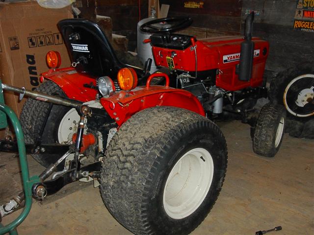

Well, it finally dried up enough to take the tractor out last weekend. I tried driving with the front axle engaged over soft dirt, and the front tires left tracks... indicating to me that the overall gearing with my front turfs is off a bit. It did go into, and out of four wheel drive without any problems though. I suspect i will have to come up with a front tire that is a bit taller.

I must add how much more stable it feels with the wider footprint. Its nearly 60 inches wide in the rear now! Its taking a little getting used to..... having to pay a bit more attention when driving around obstacles. I need to get my belly mower cleaned up now that i can drive on the lawn without digging it up.
Chris.... thanks for the 186D tire info. I assumed wrong. The 186 and 187 must not have shared the same gear ratio ! Whoda thought ??!!

Could you tell if the front tires were sliding or were they pulling. Most 4wd's have a little overrun front to rear so the fronts whould be pulling the rears a little. But if they are sliding that will not do you will not be able to control the tractor at speed.
   / Turf tires for my Yanmar
#31
I believe the fronts were dragging slightly. I'm guessing they are a bit smaller in diameter than they need to be, so they are not quite covering enough ground per rotation. I don't suspect i'll need four wheel drive alot to mow.... so i should be ok for now. When i talk Whats-her-name into letting me spend the money on a FEL, i'll be sure to get the tire diameter straightened out.
   / Turf tires for my Yanmar #32
Sounds to me like there is nothing wrong with your set up. Four wheel drive is intended to be used only when necessary. Not all time. If you are stuck use it, If your back wheels are spining use it, but not all time on level ground. Its going to mark the grass when you turn. To my knowledge you can't stop it.
   / Turf tires for my Yanmar #33
In your picture it looks like the rear tires are pretty close in diameter to the ag tires that were on it. You front wheels look way too small. What I did on mine was rather than look for a set of tires for a particular tractor, I measured the diameter of the ag tires and got turfs the same diameter.
