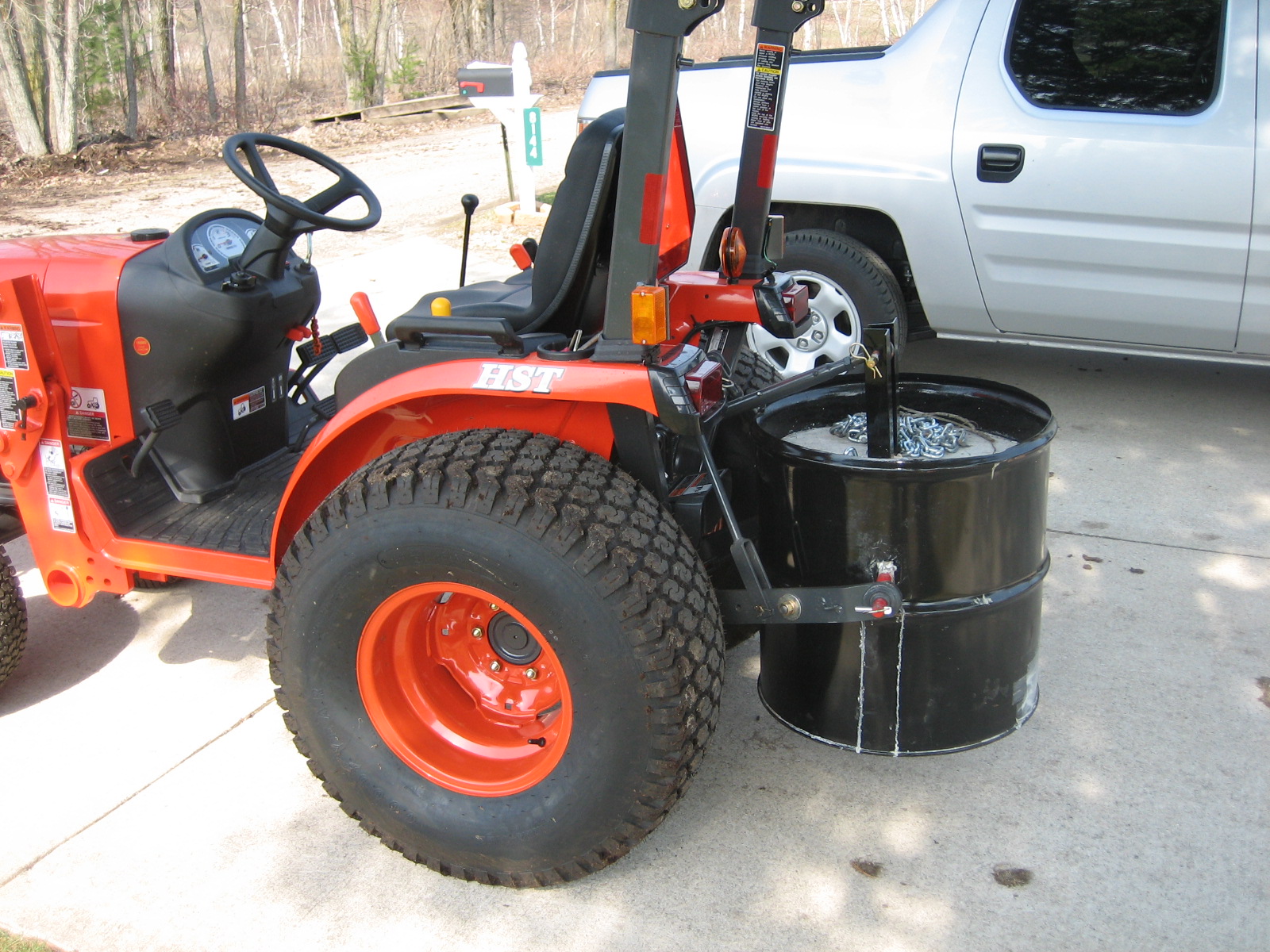

I have tires that are not R4's. I would describe them as "snow tires". See attached photo. They are filled with rim guard, 470 lbs total. They do not load up with snow, the traction is very good. It will go thru 15" of unplowed snow, loose or packed with no problem.

Thx for the feedback...I am thinking on using the tires that look exactly like
n8586m's. The dealer says they are turf tires...but anyone who actually has used them had nothing bad to say. Obviously they are not meant for plowing or gravel pit use...but they seem like the best compromise for my uses.

Hey n8586m,
I'm looking at your 3 pt weight, looks like you ran
a rod through the cutoff 50 gal drum and ran it through
the upper brace for the top link? Is that filled with
sand or concrete?? Thanks for the info, that is the
setup I'm thinking about building for my T2220.

Thumper, I used a $20 cat 1 drawbar from TSC and then bolted 1 1/2" angle for the uprights. It is filled with nine 60# bags of ready mix. The one mistake I made was putting the drawbar directly in the middle of the drum, it should be much closer the tractor side of the drum. As it is, it is too hard to attach because of clearance issues. However, once I had the tires filled I have not had to use it. I have put 21 patio blocks in the loader bucket, each weighing 40#, with no stability problems. So I would be happy to give you the counterweight but shipping would probably be an issue. :D
