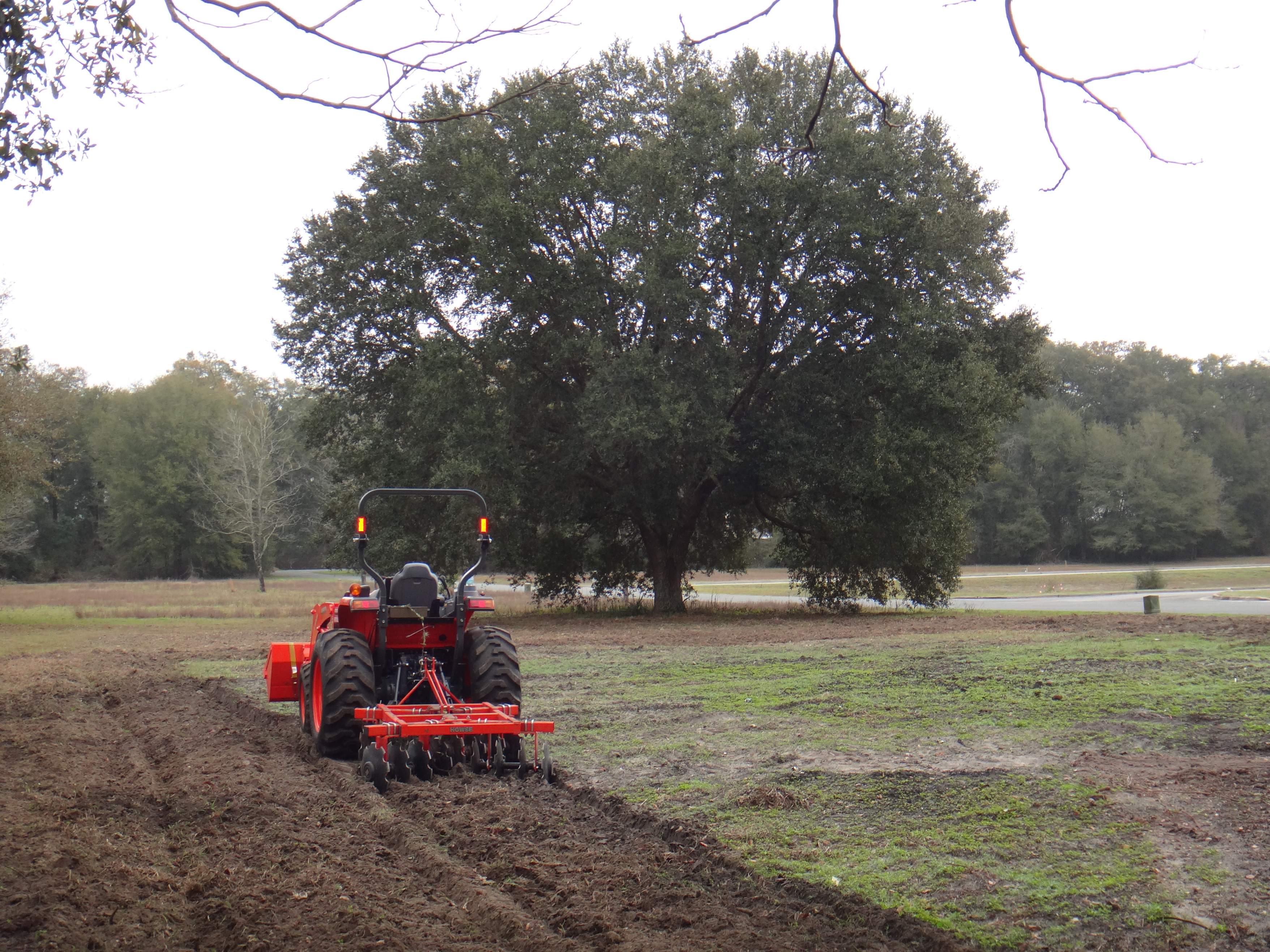

Disc Harrows with 16" and 18" pans are for gardens with minimal crop residue, mixed spring and fall each year.
Divide the total Disc Harrow weight by the number of pans. A Disc requires minimal 50 pounds of weight bearing on each pan in order to cut/mix virgin land with two to three passes sufficient for food plots. Eighteen inch pans have about 37 pounds weight bearing.
Also consider a 66" Fred Cain Ca7 Field Cultivator, a conservation plow.
Fred Cain 7 Shank Field Cultivator with 66in bar
I have both implements in other brands.
