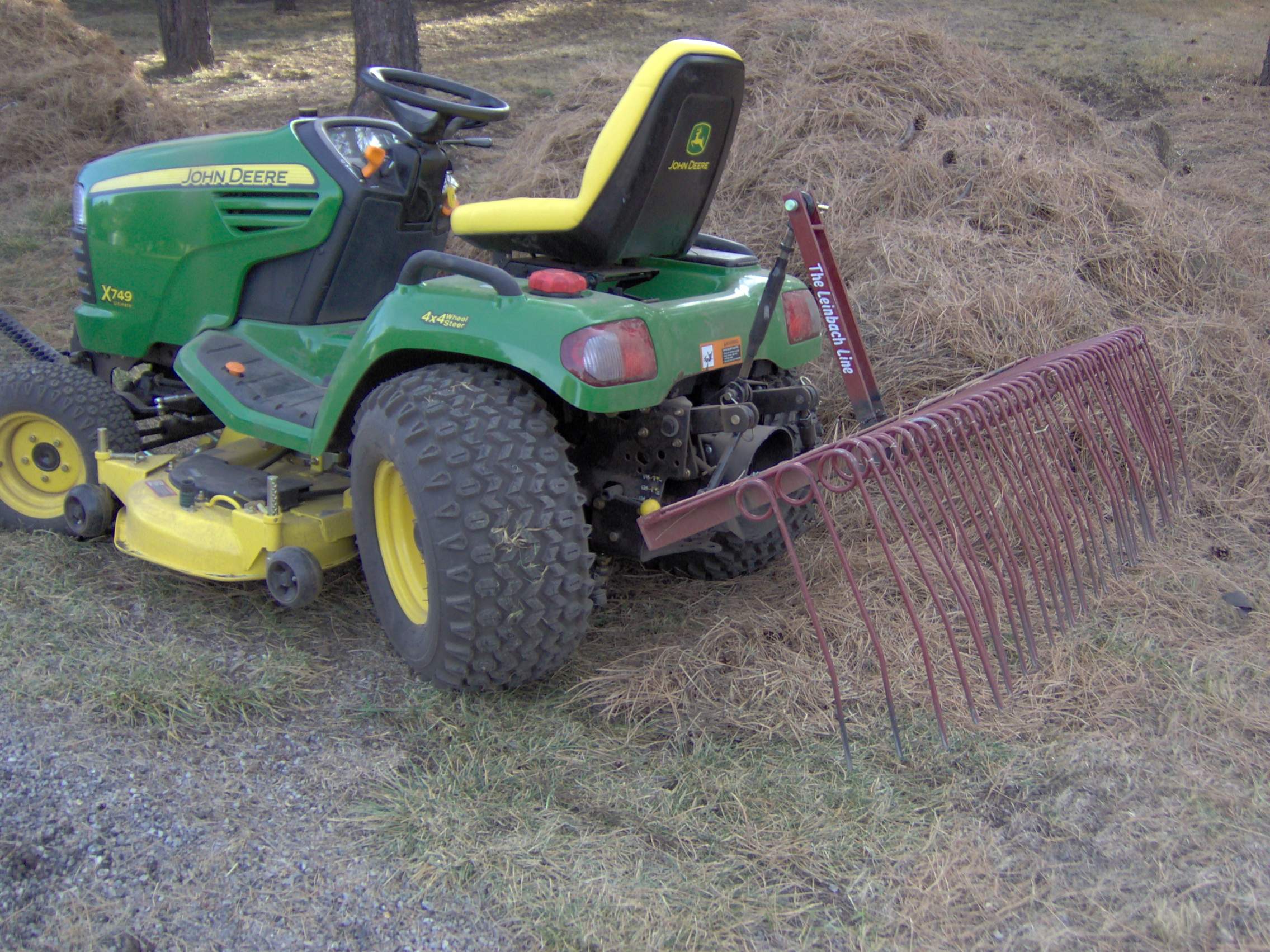

Here are some pics of my psr in action. I have it set up for the IMatch now so that adds some extra weight. I use the crap out of this thing for raking needles as well as smoothing and covering seed. Would not want to be without one.
