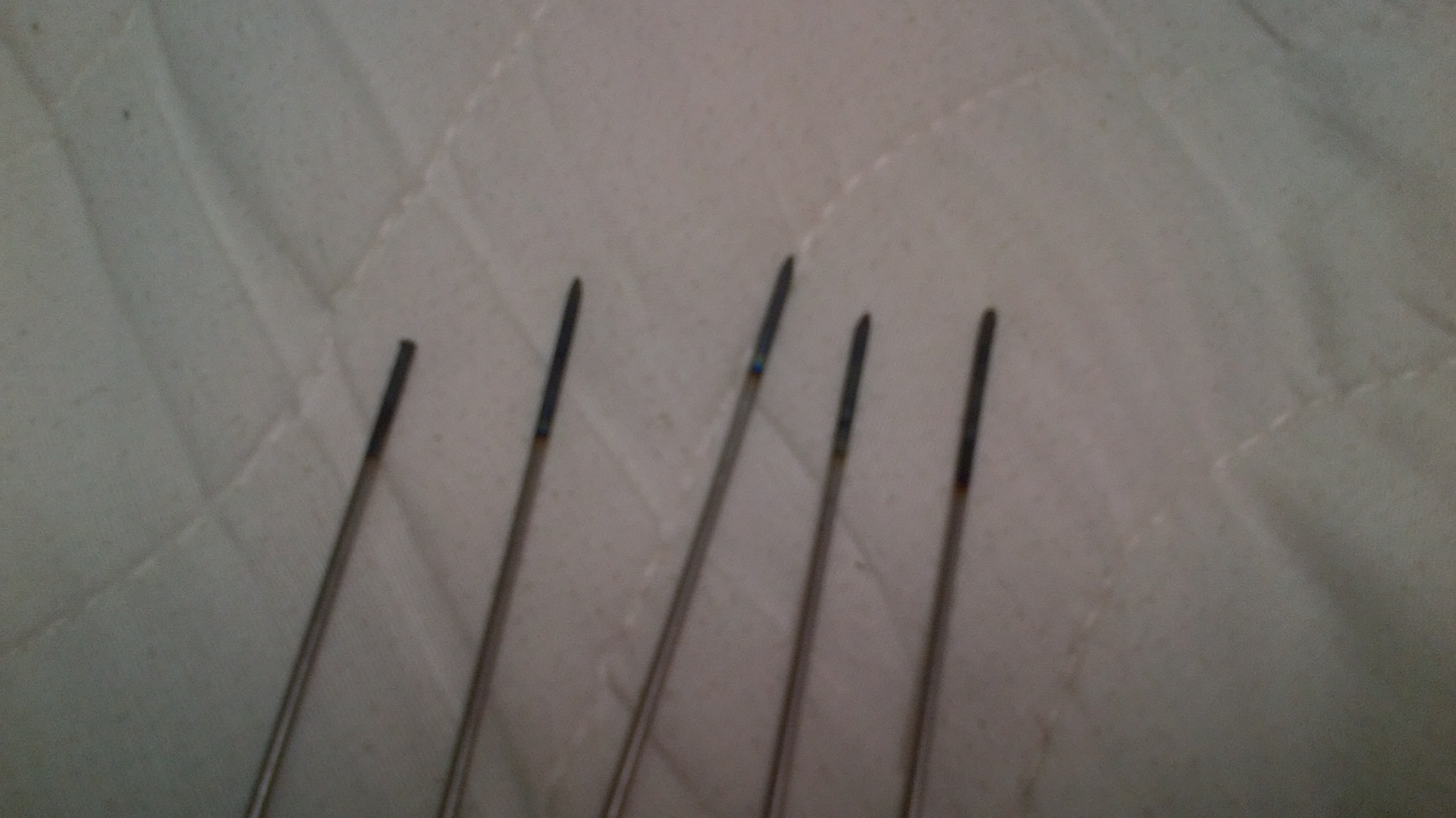

Are you using a 3/32" tungsten? How far is the tungsten sticking out past the nozzle? From your sample it looks the piece got real hot but the weld was too cold and/or you added way too much filler rod. TIG welds are usually slightly concave or flat and your's looks more like a cold MIG weld going too slow. One last thing, were you on straight polarity? The black tungsten may be from getting too hot. Lots of beginners do cut the rods in half until they get the hang of it. The long rod can make you shaky trying to feed it.
/ Tungsten sharpening
#42
I have 1/16 tungsten, but I will try and get some bigger stuff soon.
The picture really made the weld look weird. I have it in front of me, and it is concave along the whole way, and has some undercut in places. For some reason my camera made it look totally different from what it is.
I think my main issue is that I am moving way too slow.
Any suggestions on settings for 1/8 lap welds? I was running about 85 amps.
I had got the 1/16 tungsten because that's what my miller weld calculator app on my phone said was the size I needed. I guess it might be a bit off....
Edit: I was running DCEN.

I guess I was going way too cold. My miller app says 100-130.... It did seem to be going really slow....
I am going to try and get some 3/32 tungsten. Any recomendations on what type to get? I just grabbed thorinated because its the old stand by.

I am by far in no way an expert on welding let alone TIG. With the help that Shield Arc has supplied me and my very limited "experience" with scratch tig and my stickweld 250; I thought I would chime in. Some thoughts that have popped up as I have read this and things I have screwed up.
I have had some tungsten that have done what I think your photo shows and the point turns into a ball very quickly after you get an arc. Is your arc staying very stable is is it dancing and flaring out irregularly? I use 1.25 diopters for reading and stick welding but have to use 2.00 diopters for Tig. I know you have young eyes but thought I would mention it. I found that I was letting the tungsten get too close to the puddle. I pulled back ever so slightly and it made all the difference in the world.
If I remember correctly Shield Arc gave me a rule of thumb of whatever thickness use that as a starting point for how much amps. I am using 3/32". My "new" stickweld 250 runs closer to SA's V350 than it did when it was broke but I am using from 110-115 for 1/8 in (0.125) for outside corner welds and 115-120 for inside or fillets. I also quit being "cheap"/frugal and when I grind my ceriated 3/32 and found if I took just a little more off on the grind that the arc was more stable. The only thing I came up with was that there were still impurities in the tip of the tungsten from my previous screwup that had not gotten ground out. I also started "polishing" the tip post grind with about three or four longitudinal pulls with 400 grit cloth along the shaft toward the tip. I also practiced on fillets with no filler just straight fusion to see what the weld looked like all by itself.

A WP-9 is a small torch. A WP-17 isn't that big. A WP-26 is a big torch. Why not just get a Weldcraft or CK torch? Some of the house brands are actually CK torches and I've never heard of any problems with them or even copy torches. Most of the problems I've seen are from the flex heads getting too hot and failing. I don't think you really need to worry about a water cooled torch unless you're going to be doing some serious TIG welding. Learn how to TIG weld first and then add what you need. A water cooled torch isn't going to magically make it any easier. Having someone with experience will be a great help but the first thing you need to do is get the right size tungsten and filler rod for the pieces you're welding. You got the 1/16" tungsten too hot and it was too small for the thickness. It's hard to critique a weld when it wasn't done with the right equipment. If the tungsten gets badly contaminated, don't try to grind it off. Use 2 sets of pliers and snap the bad section off, then grind it to a point length wise with a fine grinding wheel or sanding disk. If you try to use just one set of pliers, the tungsten will split and then you have break even more off. Thoriated tungsten is slightly radio active. That's why there's concerns with it but it's been the standard for decades.
