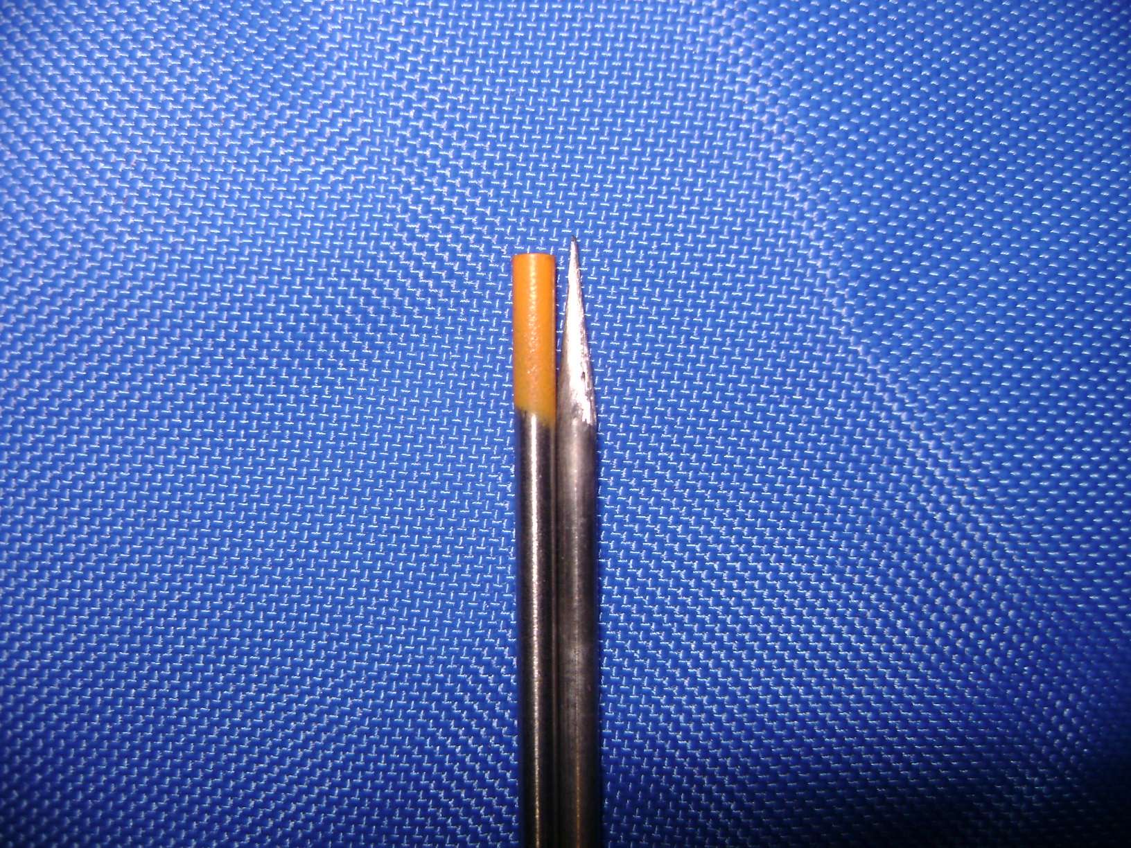

Well, I have gotten started at tig welding. I only let myself use my auto dark hood for the first 3 strikes, just to figure out how to scratch start. I am forcing myself to learn all the rest with an old school flip dowm helmet.
I seem to have figured out the scratch start fairly well in the 10 minutes I have played with it. I can comfortably start and stop the arc with a flip down helmet now.
I just stopped to resharpen the tungstens. That 120 grit blue zirconia belt sure works well.
Time to go try some beads.
My logic for starting with a old school helmet is that if I only learn with an auto dark, I will be screwed if I ever have to tig without one.... Most people in my shop classes cant even mig weld without an auto dark..... LOL

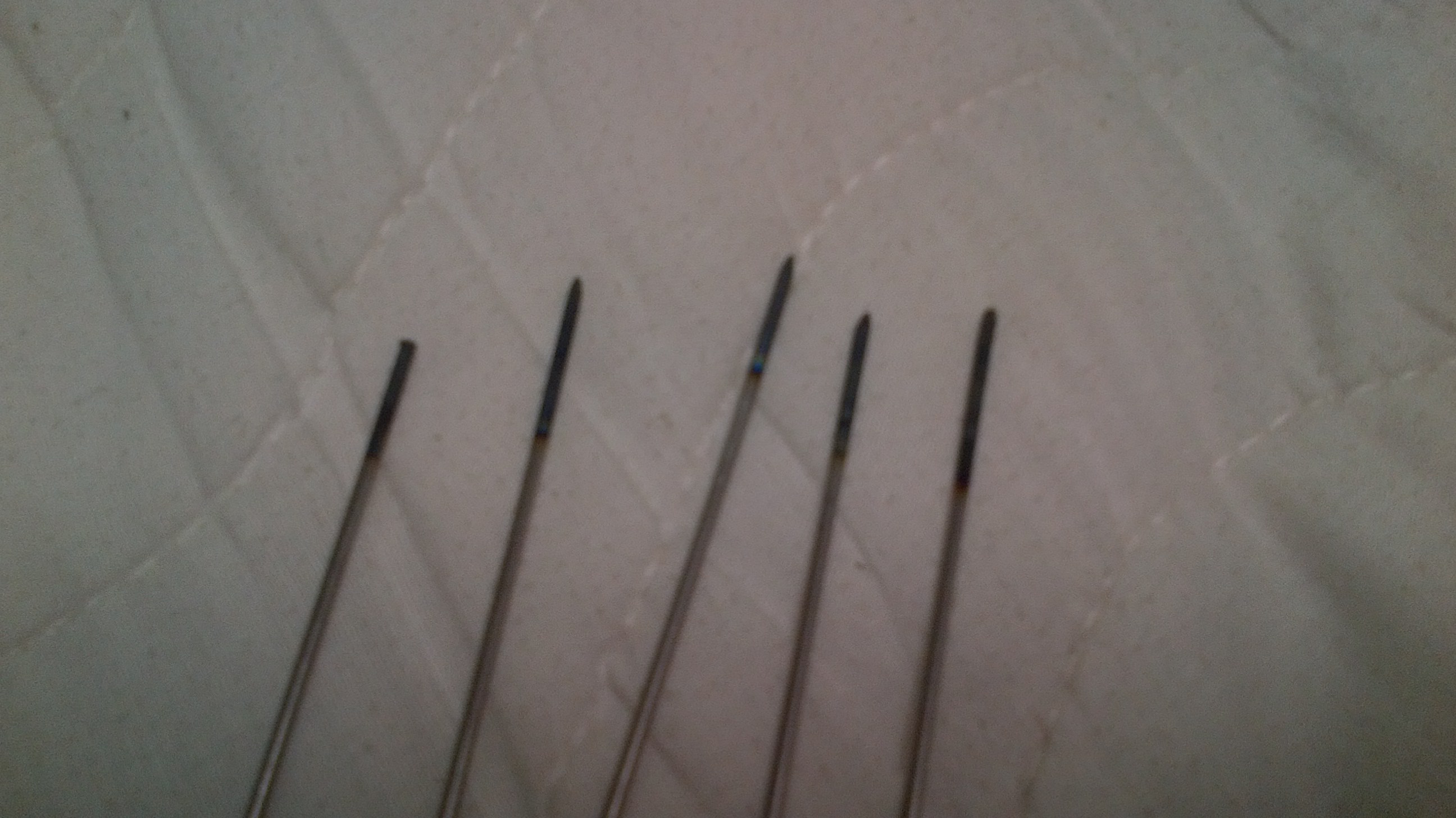

I have gotten ok at starting and stopping, but I am having a real hard time running a bead.
Both the tungsten and the (horriffic) bead are black. Its the color you get with a gas weld.
Does this mean I am not using enough argon? I am using 7l/m (15 cfh).

100% Argon? not C25?
No wind or breeze, AC vents?
Super clean metal? No flux and no AC mean no cleaning action.
Using TIG filler and not gas rod?

Well, I ground and sanded the metal until it was shiny, and wiped it down with lacquer thinner. I have painted stuff dirtier than it was.... I would eat off it.
Anyways, I got everything (plate, rod, tungsten) 100% clean, made sure the torch was put together correctly, checked all of the connections from the tank to the torch for leaks (there were none), and set the flow to 15cfh.
It welded a bit better, but the tungsten still turned black. The bottle says 100% argon on it, and the rods are labled as tig rods. (they were from our version of harbor freight, so I can't be sure) I have some blueshield brand er70s2 tig rods I can try as well. I doubt it is the rods though, as the tungsten turns black just starting the arc.
I have heard you can get a bad bottle of argon? It would be normal for my luck..... LOL
I am using a #9 tig cup.
No fan, indoors on my bench.
Anything else I could be missing?
I am also having a hard time seeing the puddle well. The old school helmet seems slightly better than the auto dark. Any tips for that? I can see where it is, but it seems really fuzzy. Could just be my helmet needs cleaning.....

Just for fun turn your gas up to 20-CFH.

Anyways, I think I have figured it out. I turned the gas up to 20cfh, and found that if I was really careful on the startup, I could make a bead, and have the tungsten still shiny.

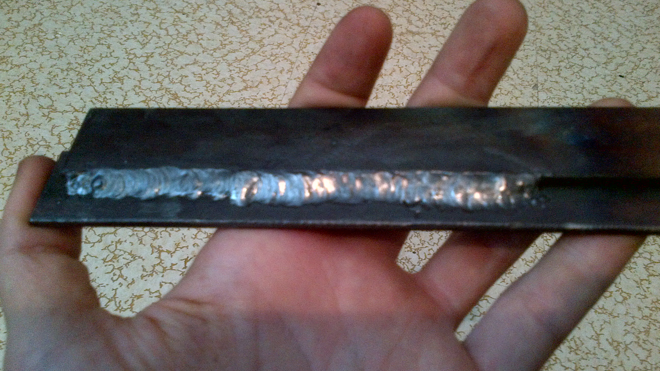

Okay, here is my first ever tig weld. I need to figure out a better way to get pictures.... It looks Far, FAR worse on the picture than in person. In person, it isn't too bad. I went back over half of it to wash it into the toes better. The part nearest the end of the plate is as welded. Tomorrow I am cleaning my shop, then I will be trying to do some daily welding practice.

The as welded part doesn't look to bad. Being as it is the very end of the weld, and you don't have a foot pedal, I'd say you need to turn the amps up a little bit.

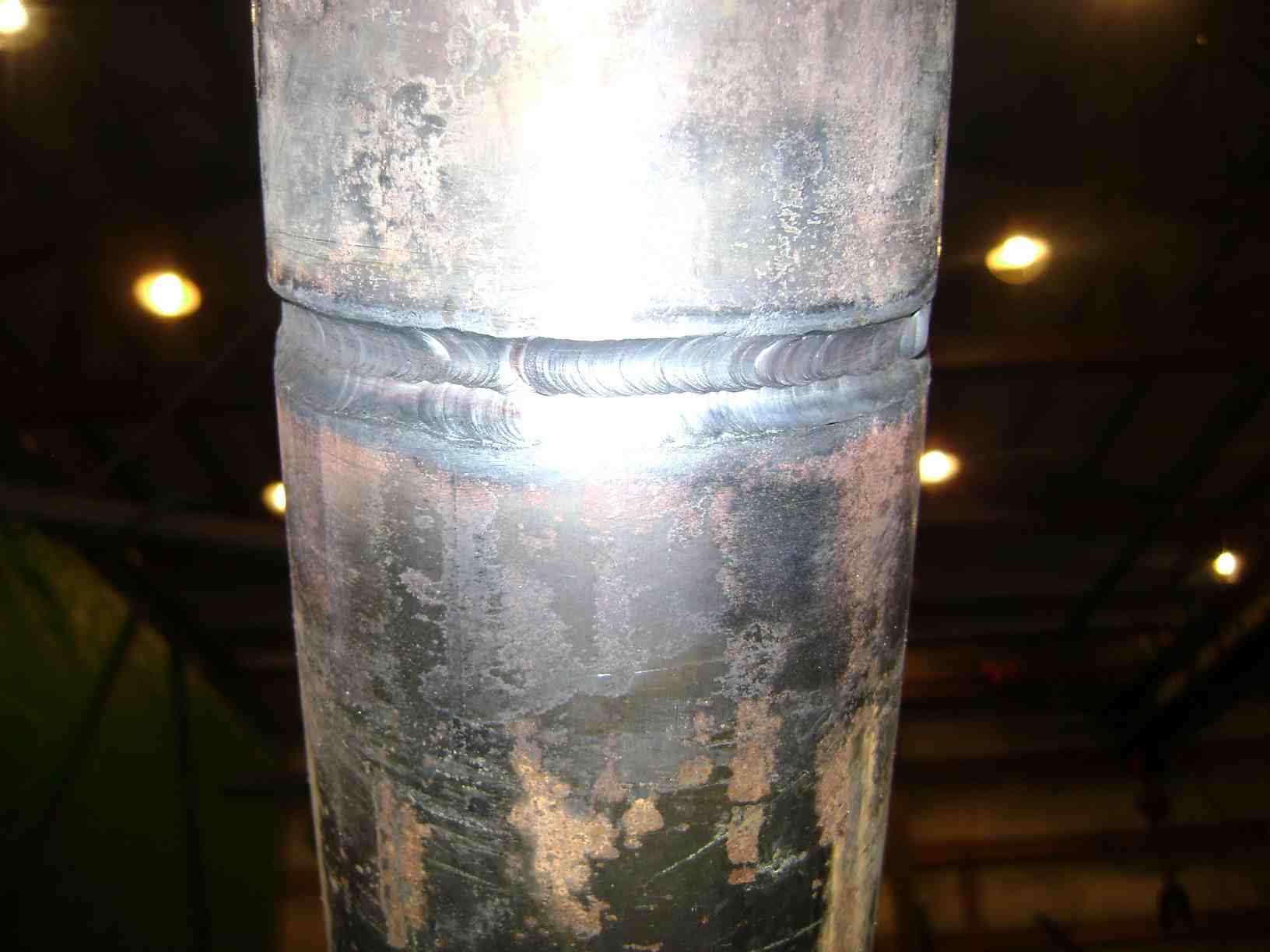

This is the bottom, (overhead) of a 6-G Tig weld I made sometime ago. See how the weld flows into the side walls more so than your weld?
Remember now when Tig welding 6-G pipe, you have to know how to weld with both hands!

I think I was at about 80-85 amps, and it was 1/8 steel.
The one thing I am having a hard time with is feeding rod while welding. I can dip fine, but once it gets short, I can't seem to get my self to feed more out while the arc is going.... I know how to do it, I just can't get my self to do it..... LOL

The picture really did make it look a lot different. On the picture it looks like it sticks way up, and didn't touch the corners. In person, it is concave most of the way, and has some undercut along most of it. The corners are mostly rounded over. I think my main issue is in feeding the rod. I think I need to work on moving the torch as well.
I have to say, being decient at stick welding made this a lot easier to get going at.
