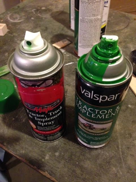

Their suggestions for mixing the hardener were 16:1. So I mixed 1 pint of paint with 1 TBSP (1/2 ounce), and just enough thinner for the desired viscosity to properly atomize the paint. Results sucked. So with experimentation, I had MUCH better results mixing about an extra TBSP of hardener. My mix ratio was closer to 10:1
Maybe it is possible that this paint is really picky and you need the absolute best conditions and perfect mixture to make it work??? But the point I am making is, using valspar, BPS and others, never had to worry about a thing. And after reading pleanty of negative reviews on other forums saying basically the same thing I am...........tells me it isnt just me.
Sounds like you did everything right and had perfect conditions and mixture. But from all the reading I have done, people having those good results with Majic are very few and far between.
One thing I learned in 35 years working in aviation is proprietary chemicals are always different in some little way.
Another thing is the dryness of the air. I have an air/water sperarator on the wall feeding the regulator and a moisture trap, with crystals that change color when moisture is present, down from the regulator. Then I have a disposable moisture filter screwed into the gun's fitting. I put new crystals in the trap the night before and the next day they had changed color, indicating moisture. So moisture can be present even in a warmed shop.

What rattle cans did you use for that repair?
I have yet to find anything in a one-part rattle can that resists gasoline. Other than marginal results with high heat stuff after its baked on.
I buy the Kubota brand rattle cans. Well worth the money and seam to resist gas.
They may seem to resist gas, and some paints are better at it than others, but all one part finishes lack the ability to resist gasoline, (especially with ethanol in it), to any great extent.
In fact, even some low end 2 part systems do a mediocre job of resisting gasoline.
In this case, you do pretty much get what you pay for.
/ TSC paint sucks #69
I have not found anything that affects Imron.
hugs, Brandi
