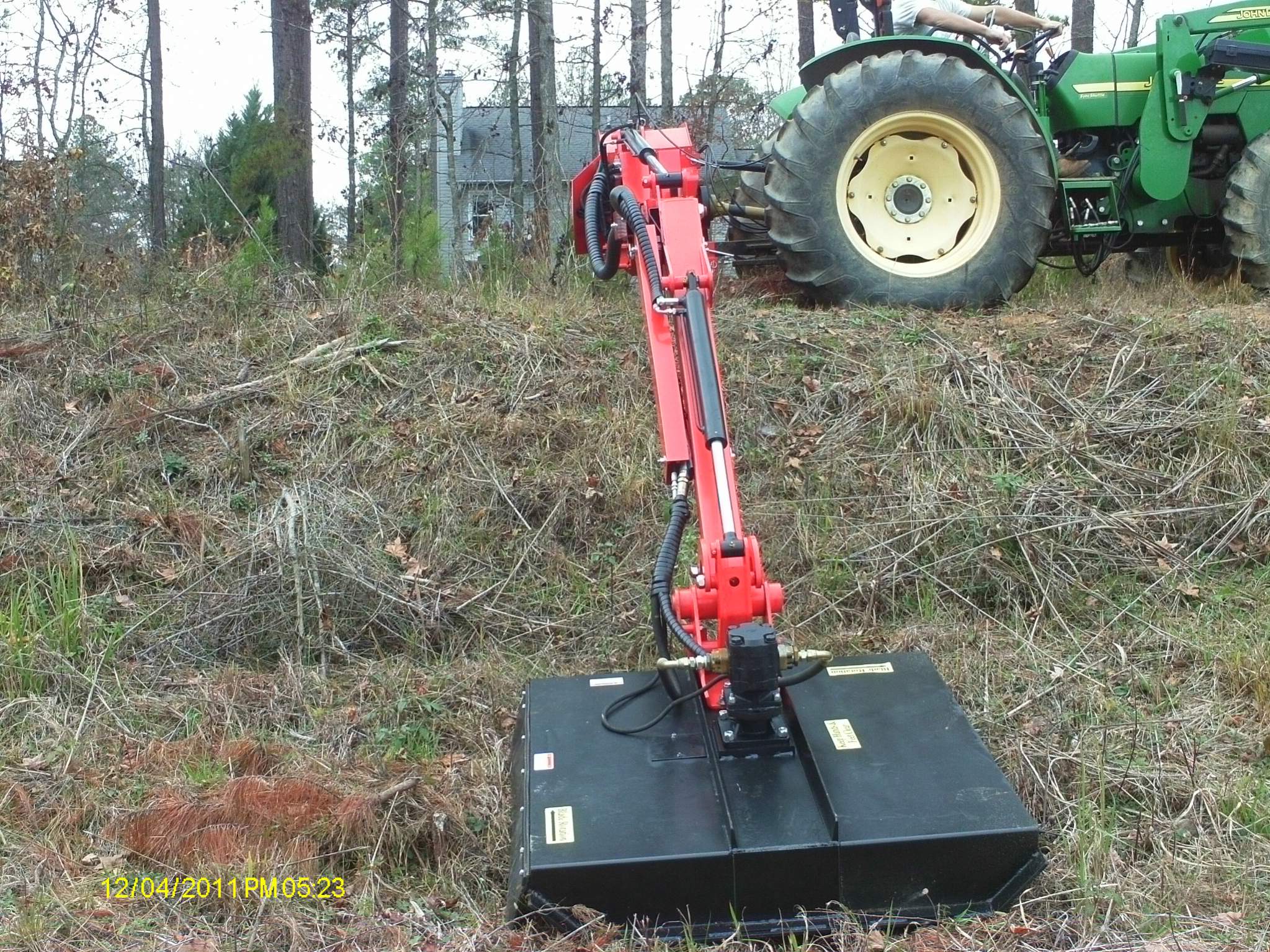

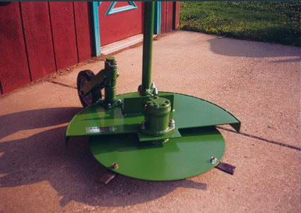

Here are some pic of a hyd blade attachment. Don't know all the particulars.
