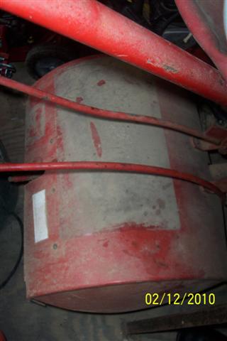

I have a higher serial no. on my kohler engine than yours, CR 172, and yours has slightly different operating labels than mine. So I think you have an earlier model than mine.
Mine was shipped to me in July, 1982.
According to some of my papers, the tiller serial number for tillers shipped after July 5, 1971 is on a tab on the transmission case, right side above the wheel axle. For tillers shipped before that date, the serial number is stamped into the top left hand side of the motor mount (to me it's the part that houses the belt.)
My unit used to have a label with the tiller SN where the white residue of the tiller is in the attached photo. There was one big label for the operation of the controls that peeled off years ago.
The available engine options when I bought mine included a 6 hp Tecumseh, a 7 hp kohler, or 8 HP Briggs with or without electric start. There is a note that only tillers having tiller serial nos. 384172 and up made after March 6, 1979 can safely use 8 hp engines.
