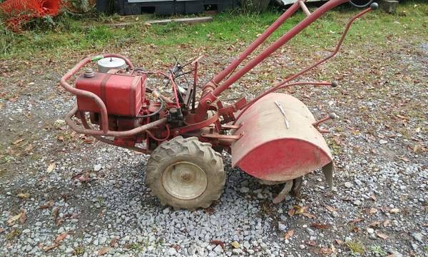

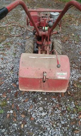

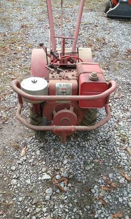

Can someone tell me what the approximate year of this tiller. Is has a 8hp Briggs & Stratton motor.
/ Troy-Bilt Horse ID #77
I know this is an old thread but that tiller above looks like a Horse model. I inherited one almost identical except the decals on the tiller cover look a bit different and mine has a battery electric start. Mine has a serial number of 679766 (bought 1983 by my Dad). On the tiller cover mine says Horse Pro, but when I look online I don't see any listings of the 'Pro' only like the Horse III model.
On mine the Model number is not readable, looks like it was very poorly stamped. I can barely make out what resembles 2 digits, neither are readable. The rest looks blank or never stamped. I have all the paper work but Dad never recorded any model or serial numbers.
When I searched the Legacy tillers at the Troy Bilt site, my serial number comes in a group that lists out the HORSE III 8HP model, but it doesn't actually give the model number. I wish I could get that Model number as it's called for many times in parts searches but I just don't seem to have one.
