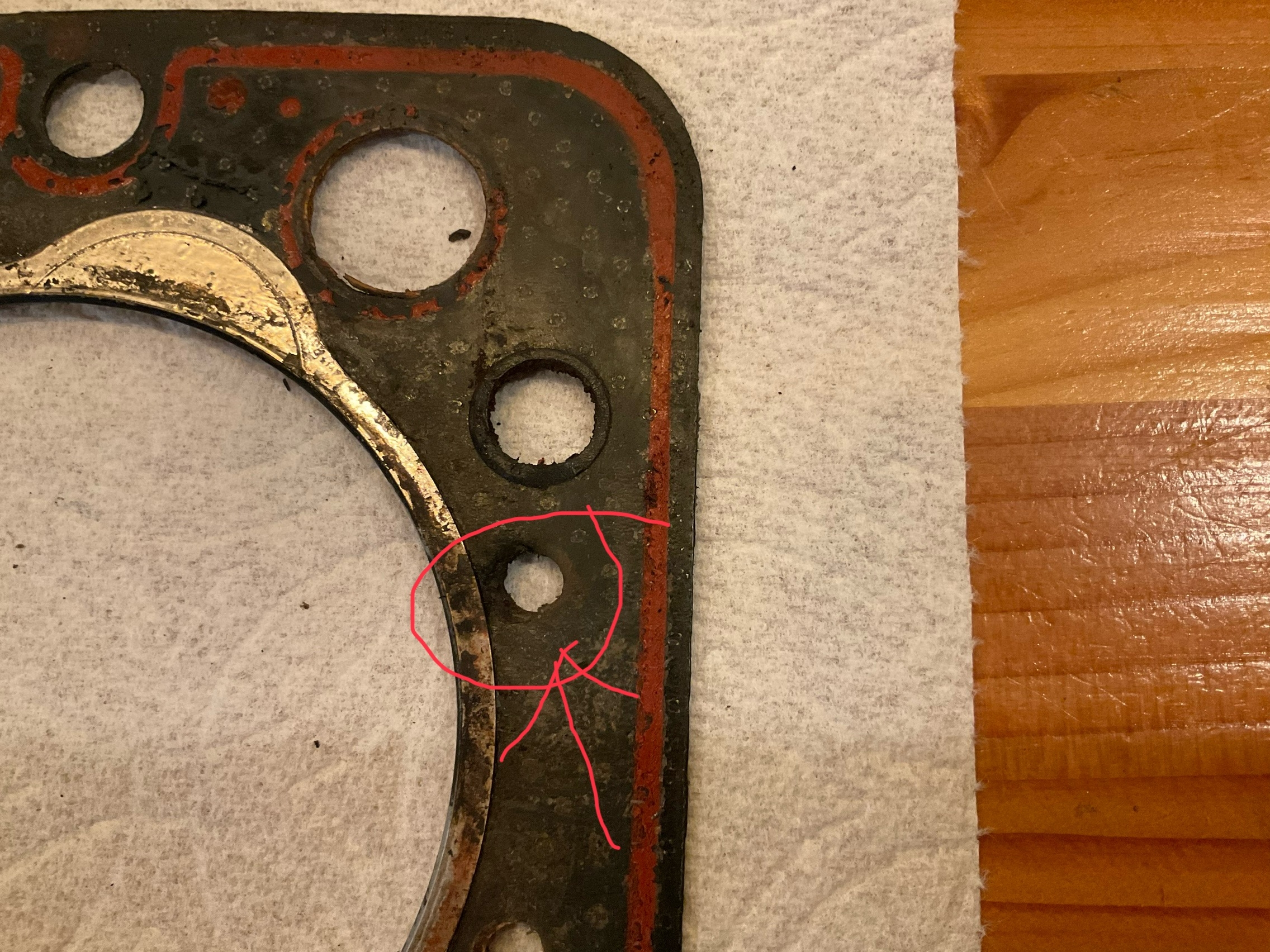

I had the same bubbling problem last year on my CK25,
My mobile man brought his radiator tester determined it was a head gasket! Replaced HG, thermostat, radiator cap and miscellaneous gasket's and all hoses (20 years old) 1370hrs! It runs great!!
