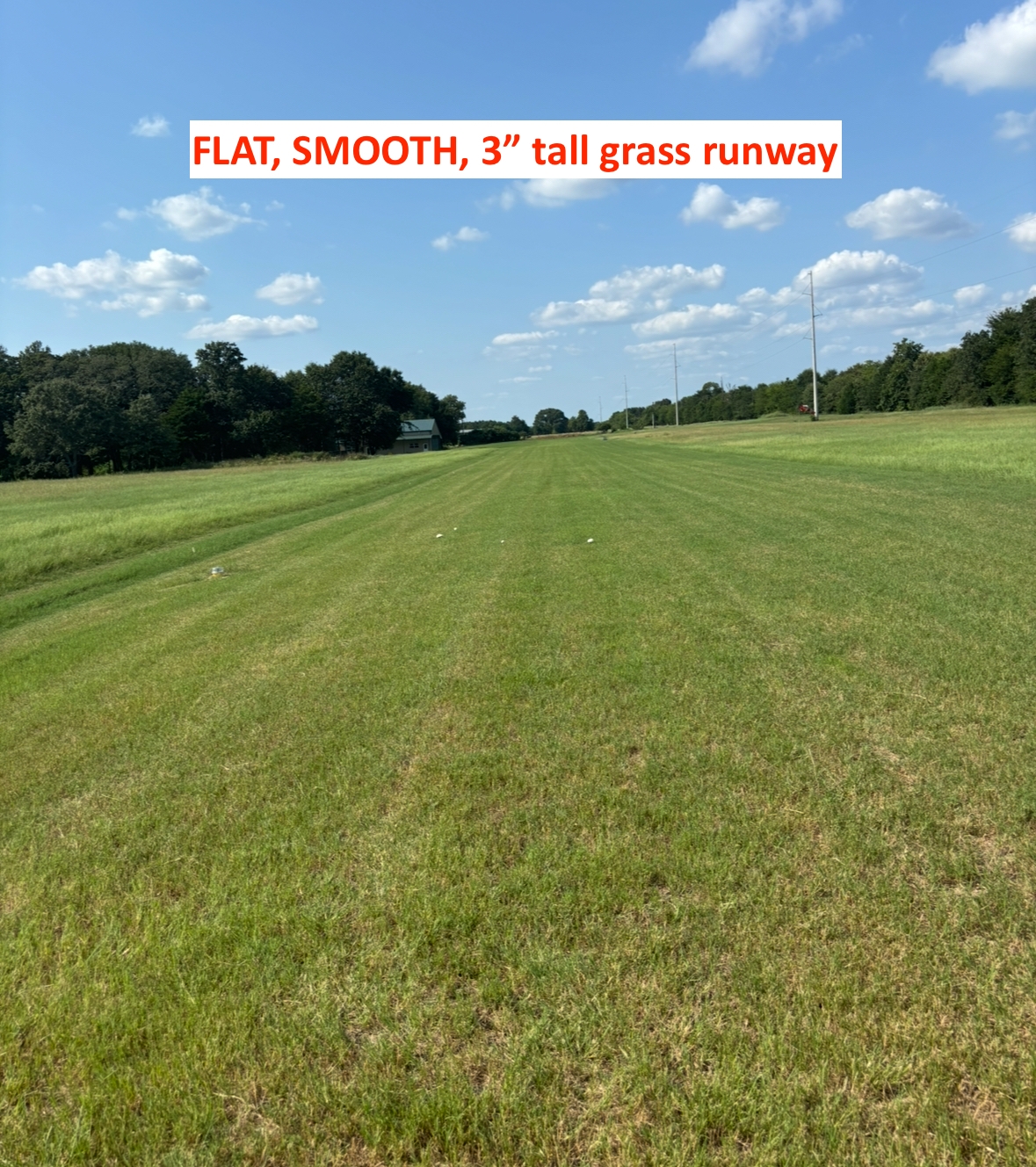

I know he asked before he knew what I was cutting so it's probably academic now, but if the tractor and 10' mower can't handle 5" to 6" grass, then it's not worth it.
Is this a rough cut mower or a finish mower?
We don’t know how the mower is configured. Is it set appropriately level front to back so acting somewhat like a mulching deck recutting the clippings.
Type and moisture of grass. There is a huge variation in how some types of grass cut vs others and same with moisture content.
I could be 100% mistaken but seems like might be expecting a little to much from the tractor since simply dropping a gear and the problem goes away.

I only use it for the Coastal Bermuda runway. The Coastal Bermuda hay fields are done with bigger equipment.
It was the clogged radiator fins, all good now.
