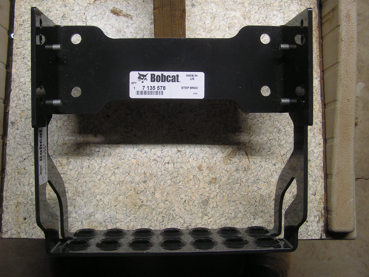

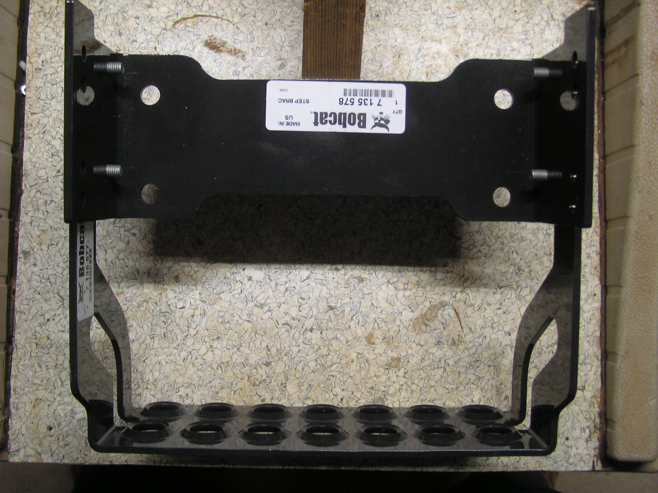

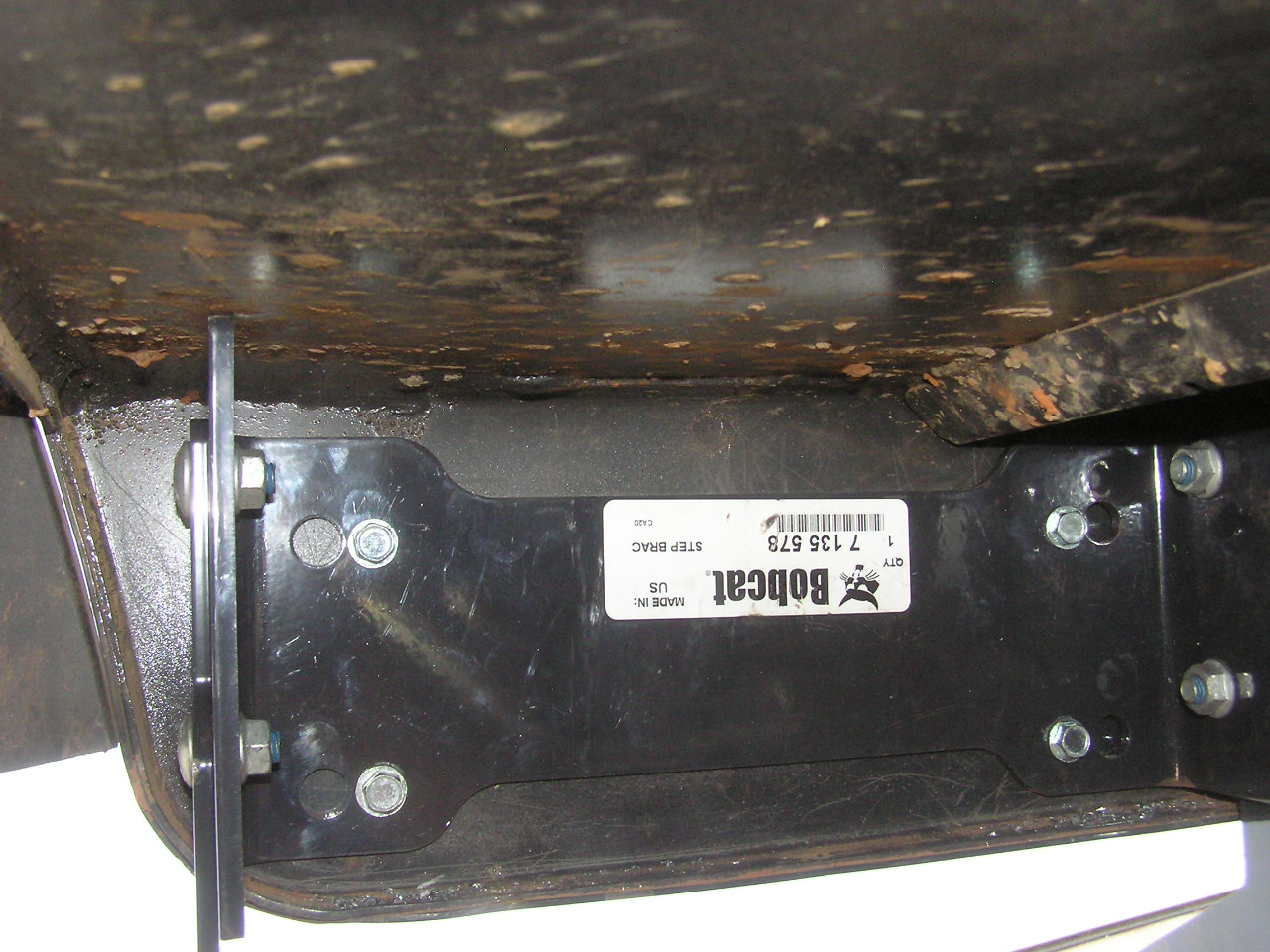

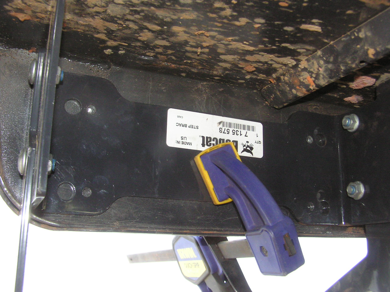

Here are the installation instructions for the step. This should have been in the box with the parts or dealer could have printed theses out for you. The holes are drilled through inner wall of cab only then clip nuts slipped over the holes for the bracket.

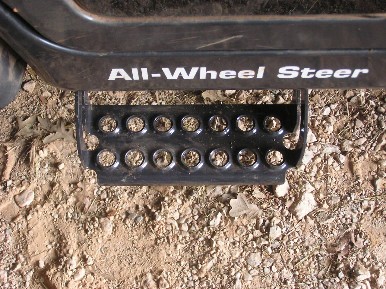

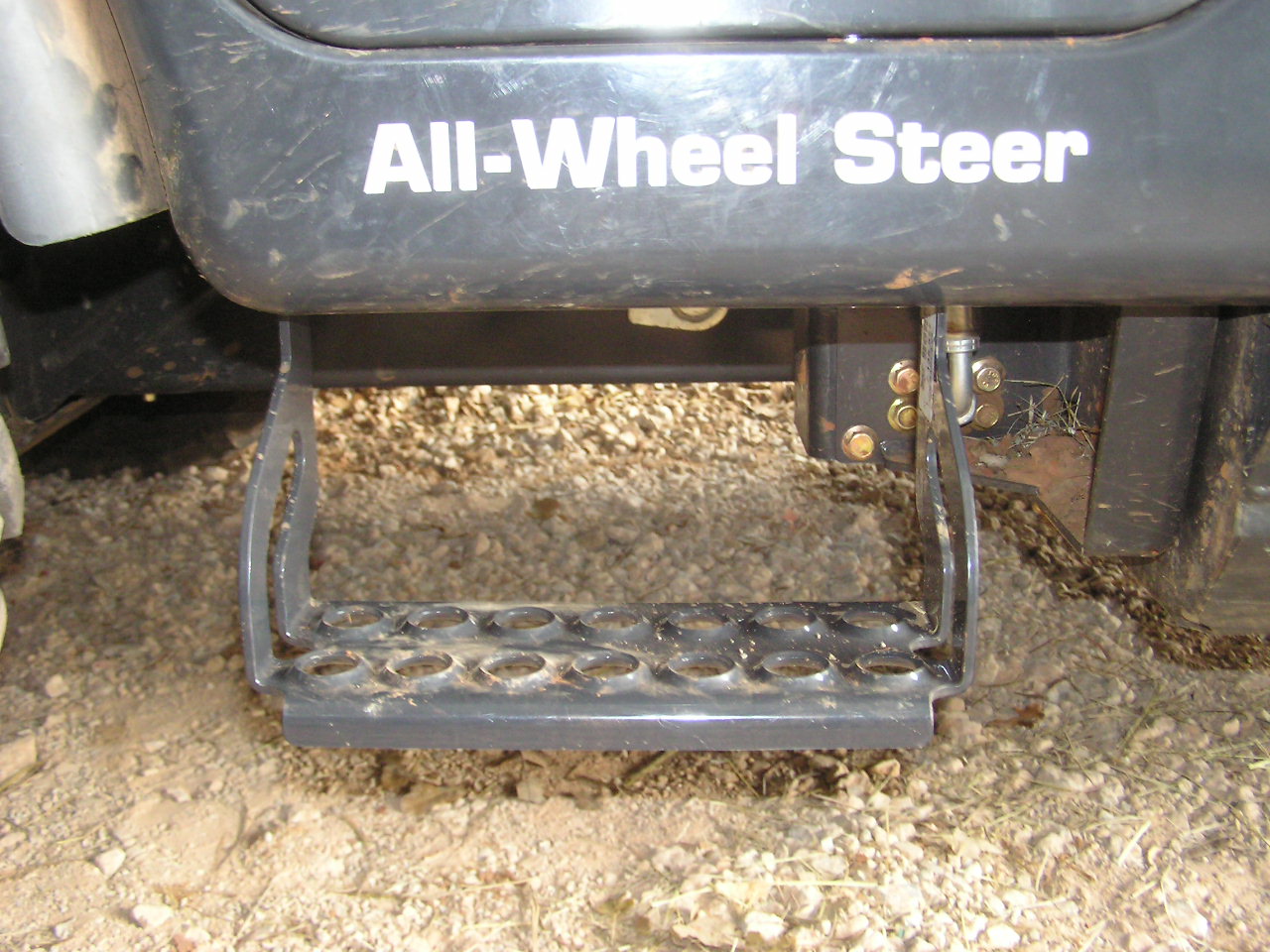

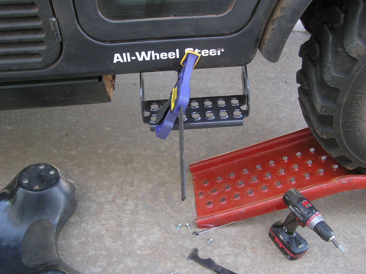

thanks both came through for me.. Dealer e-mailed me and of course you guys always come through!! a bit of a pain to do as they don't give you measurements for the smaller 1/2" holes (outside ones) so I transfer punched them using the mount then made a template to overlay to do the larger center holes then took a carbide bit and squared off the holes so they fit nice.. thanks as always!!

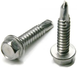

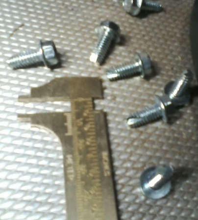

I am going to order the step kit and wonder if instead of clip nuts the bracket could be mounted with self drilling sheet metal screws like these?
   / trivial question about the step kit #14
I'm not liking the 4 extra 3/4" holes either to get those clip nuts in. I would rather go with quality riv-nuts.
