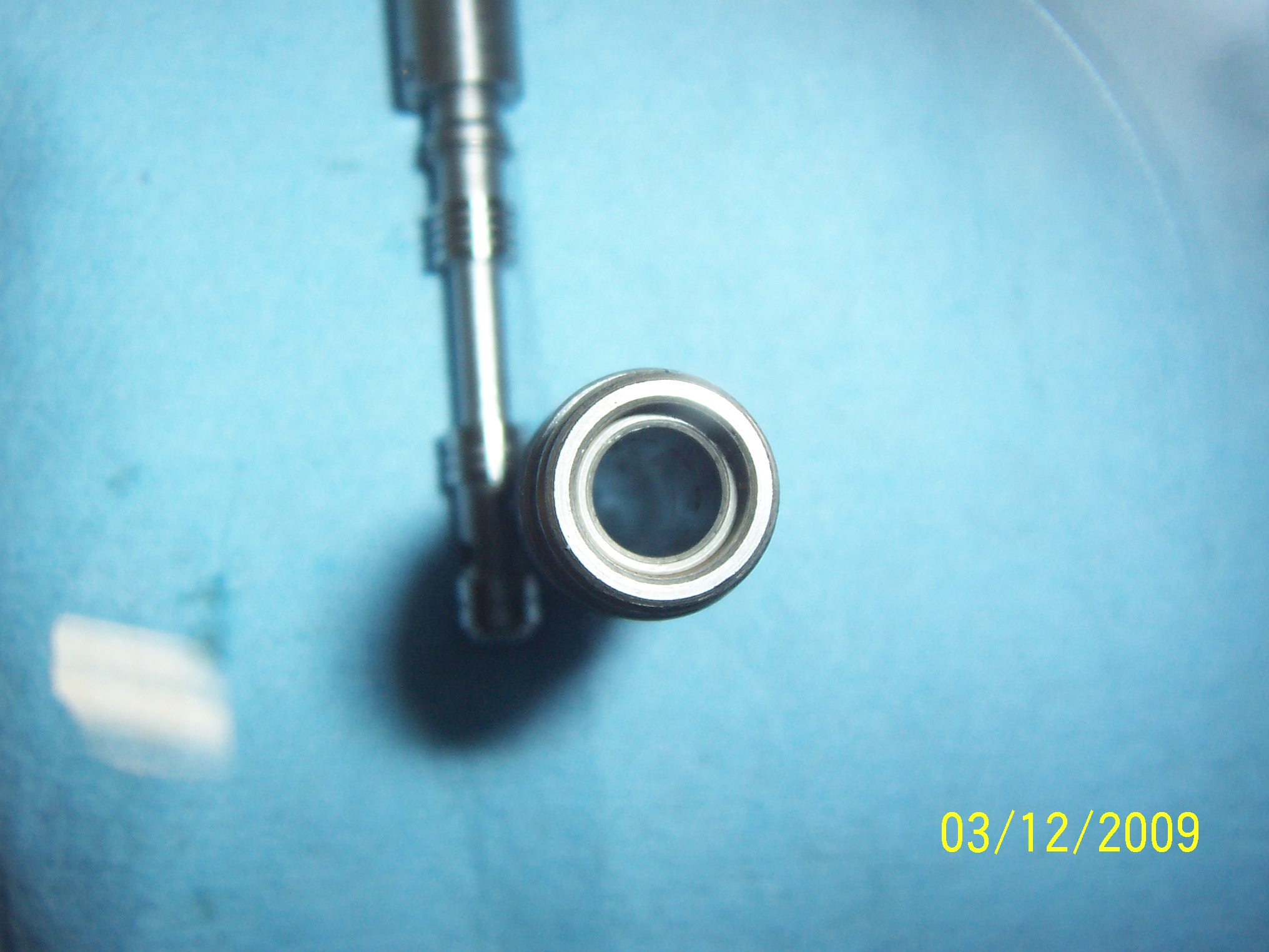

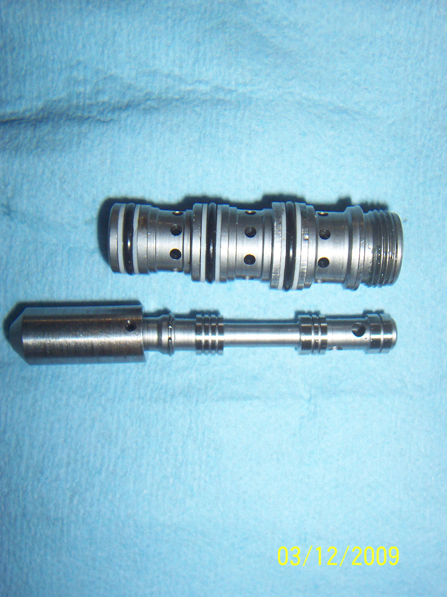

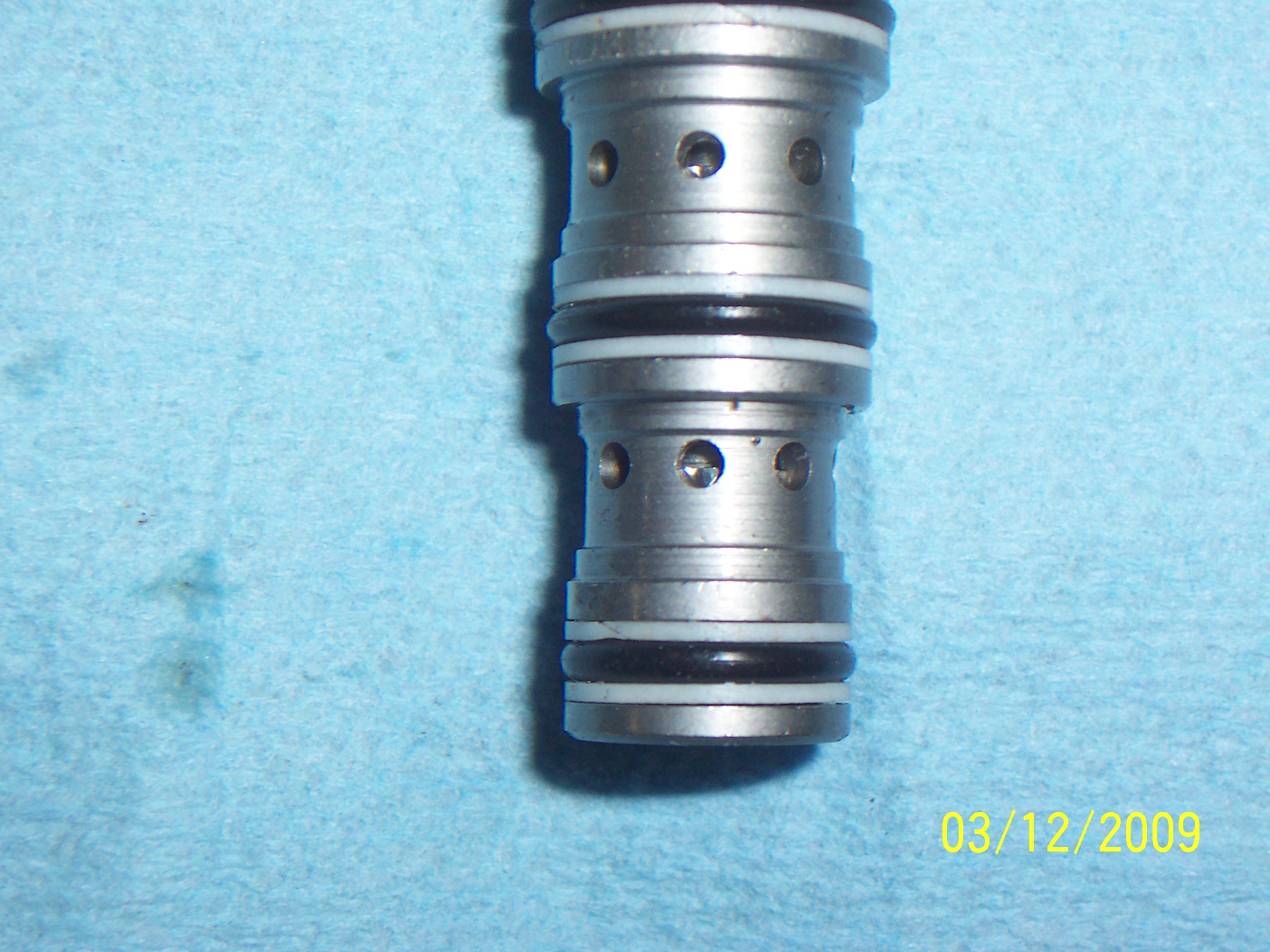

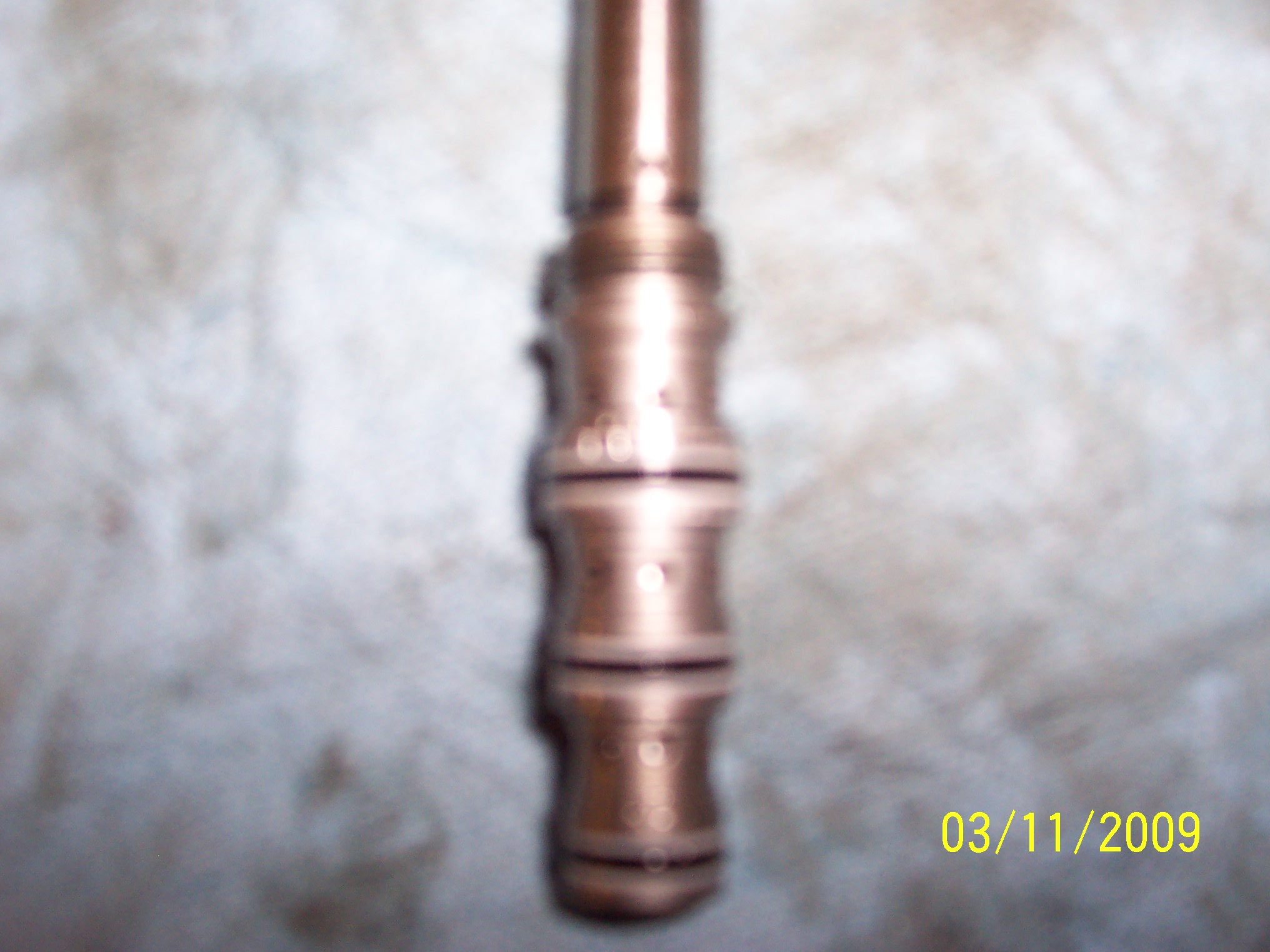

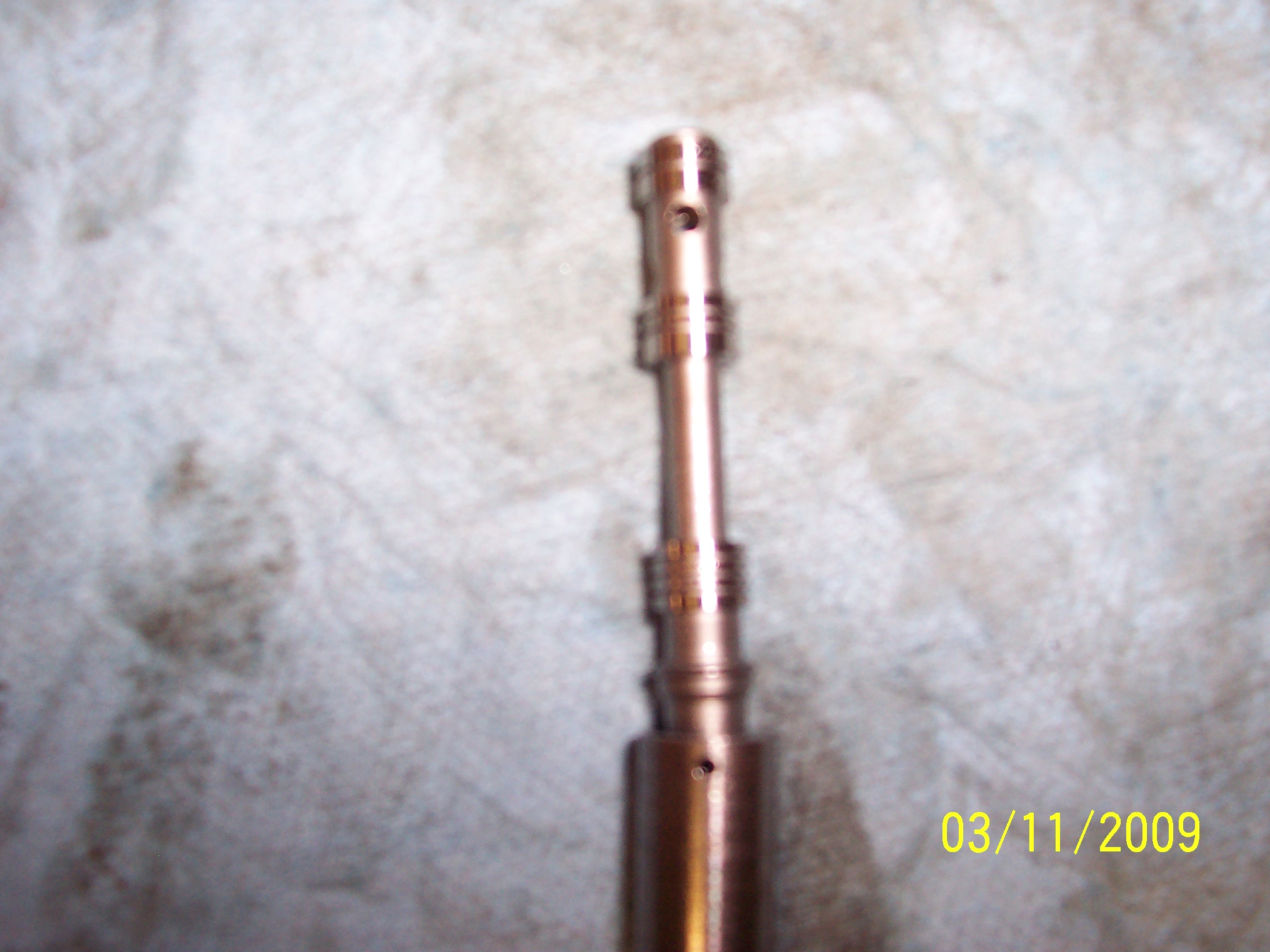

I haven't got back to working on it yet. I have kind of been waiting to see if anyone else had the same problem or if it was just me. I think there is a flaw in the first spool valve. When I get a chance I am going to the Cat dealer and see if they stock the first spool valve and see if I can compare them.

When you disassembled the valve, did you notice if the 3 selectors are the same? Interchangeable?
I was hoping they were but they are not. That would have been to easy.
George, the first circuit is prioritized so you dont have to have power to it to use that function.
I would like to find out who the manufacture is so I could contact them with questions. I think this valve is fine for single cyl. aplications but I dont think it will take the flow of two cyl. With work,racing and yard work my time has been limited.
