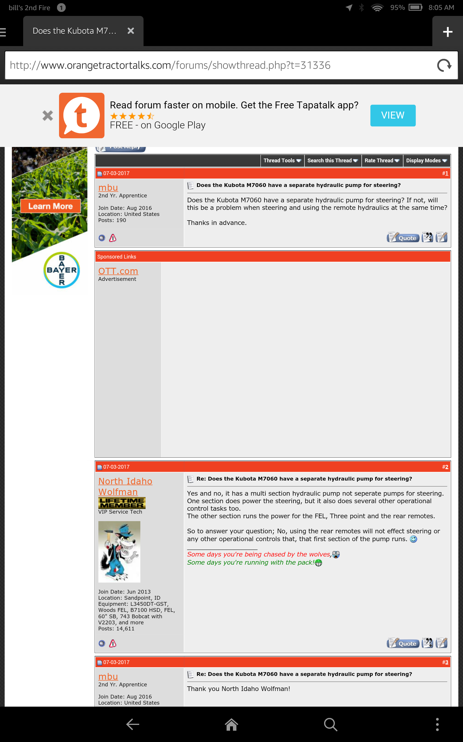

Rngrr.....
The M 7060 hydraulic spec is in the website brochure. Tablet would not download it for some reason, 16.2 gpm is stated to be available at the remotes and mid-mount loader circuit constantly. See screenshot.
OTHER POSTER: The MF 4700 is in A larger class than the 75C. It also is 100 per cent built, assembled in China. Doesn't mean good or bad, it is what it is......
There were issues W/ initial shipments but don't remember the specifics. Zetor does produce a competitive model but dealer network somewhat suspect.
Considering $$ and quality, OP should be quite satisfied. However w/ anticipated road travel, kubota is faster.
I would try to swap the bias ply tires for radials before signing the deal. Tire wear and ground contact footprint would warrant the switch.
