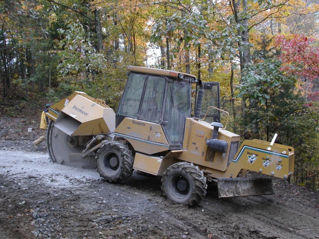

Got rock?

Thats not fair!!!! We're tractoring here............
