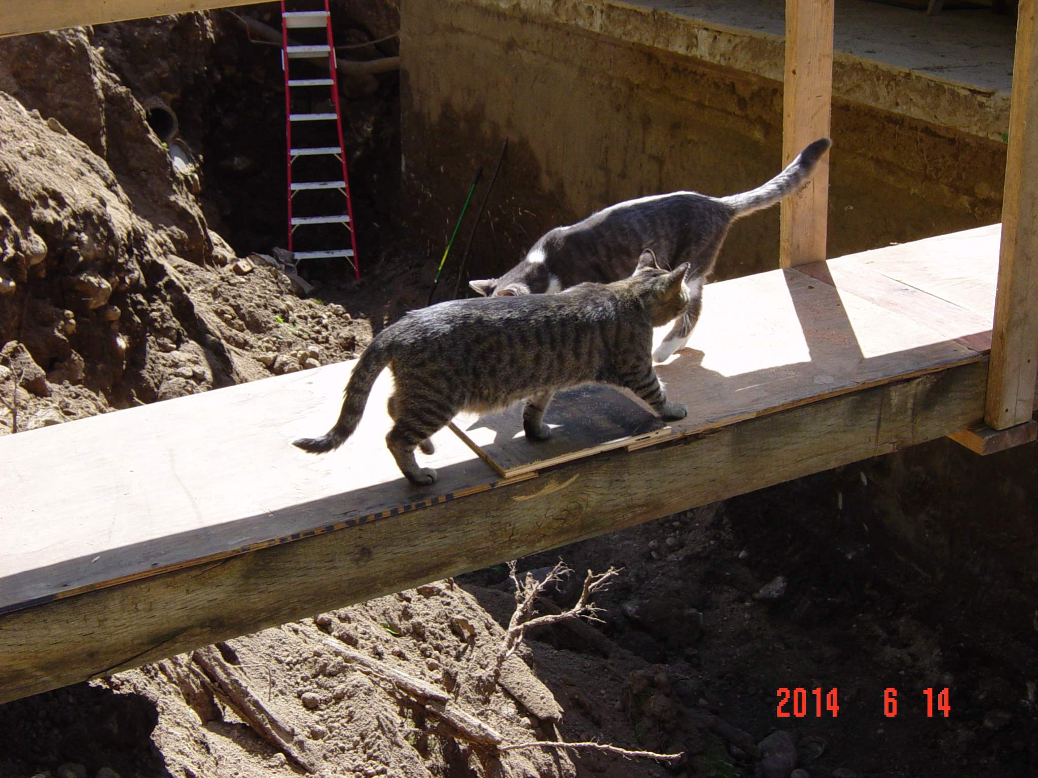

Not sure of your setup from the pic but I have dug a basement under an existing house with an excavator and tracked bobcat. It was not as fast as if it were just out in the open but I did do it. I agree to fix the water problem up the hill but I would also fix it where it comes into the house. Ed
   / Trenching beneath an overhang #13
I like that answer because it'll be easier to do part of the job. The rest is complicated by a boulder that's as wide as the middle third of the cottage. It sticks up about 8" above the ground, and goes down farther than I've cared to dig. Any suggestions about how to handle that?
The reason I think he boulder doesn't go all the way to the foundation wall, so I can put a drain at the X, is that groundhogs dig burrows along there.
If the boulder is that big and goes into the ground far enough then tie onto each side if it with a French drain. The boulder itself can stop the water above it but you need a way to drain the water away from it.
