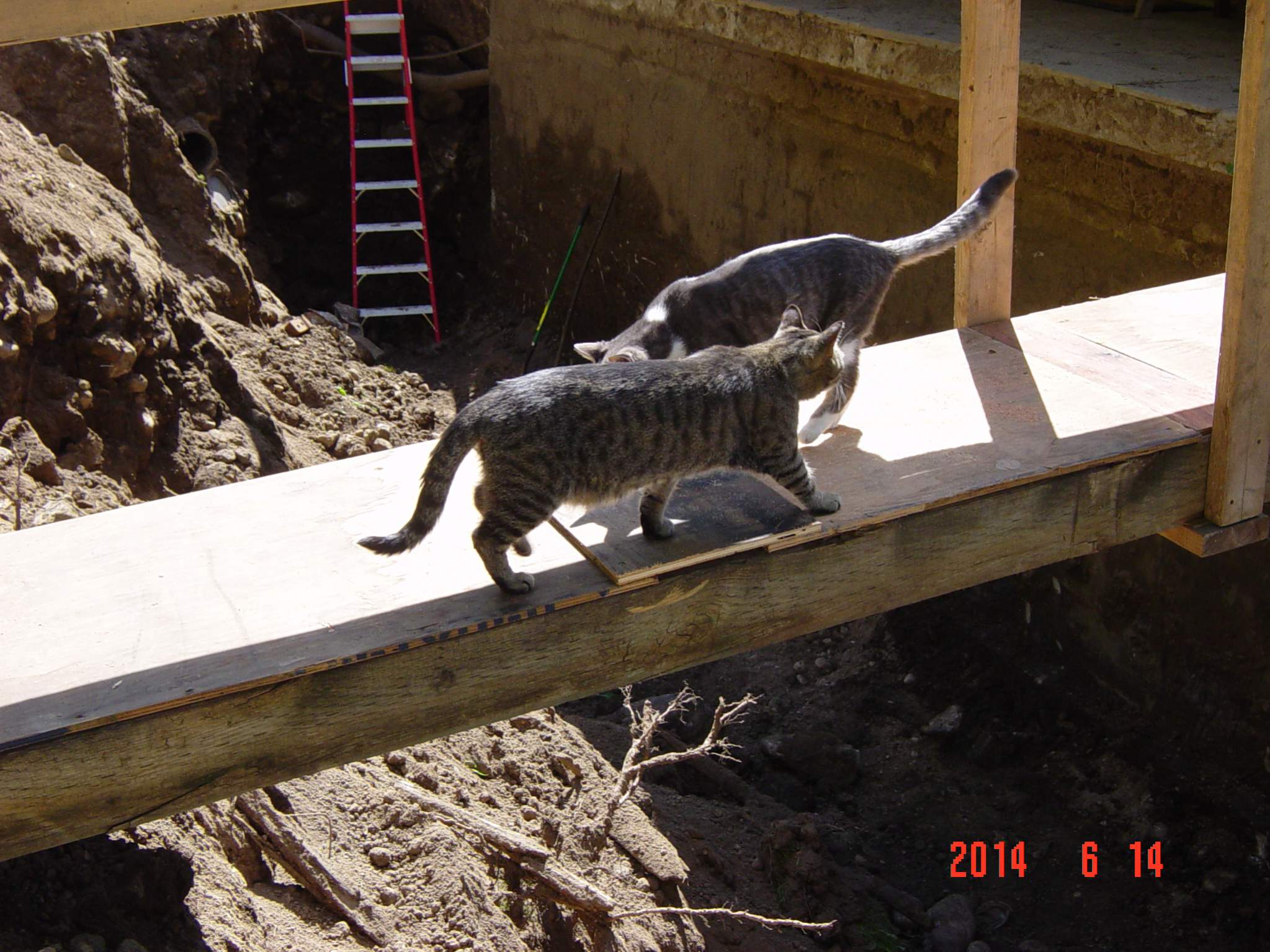

I saw a documentary once saying how cats helped build the grand coulee dam.
I excavated my foundation last year for waterproofing and other features. What a nightmare!
And I have to say, the Cats were of little help.
