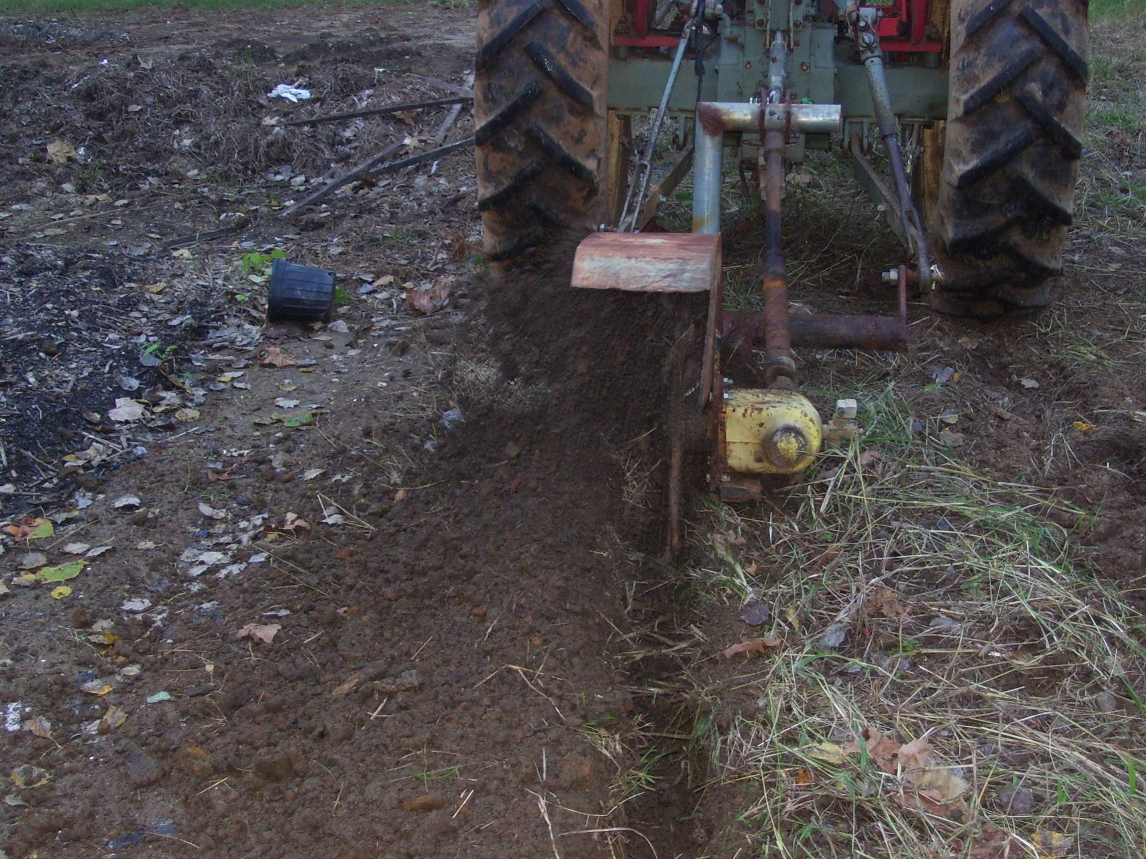

   / Trencher
I finally got around to getting my pics taken they arent really good the camera didnt focus. I plant to get some action shots later this evening. I have taken the chipper teeth off because when I got into clay they didnt cut and just acted ugly. I used the teeth I took off for hard liners to cap off excavator teeth. I have a few more tiller teeth on some junk tillers I will use to make it cut better. right now it does good Ive trenched over 2500 feet with it. and this comming spring will use it alot to lay drip lines for my greenhouse and tomato patches.

   / Trencher
The soil is thrown out of the trench, it hits the top and rolls out the side in a windrow. It does trow a bout an inch back into the trench. I have a crumber bar that goes o nthe back and has a spring on the hinge to hould it in the trench. It holds all the crumbs and as they build up they get thrown out by the wheel. Ill have some inuse pics later. sine the teeth have worn down alot it only cuts 8 inches. I was in alot of sand with cchips of sand rock and it really wore them down. I have 3 more tiller heads to ct make blades with Ill hard surface them. The larger the tip diameter the less RPM s youll need. We dont have big rocks here and it will throw out most sand rocks. I cut most any thing with it in the soil. It had a slip clutch wi a spring and a set of clutch teeth but to run it the rotation im using it in I had to tack it shut.

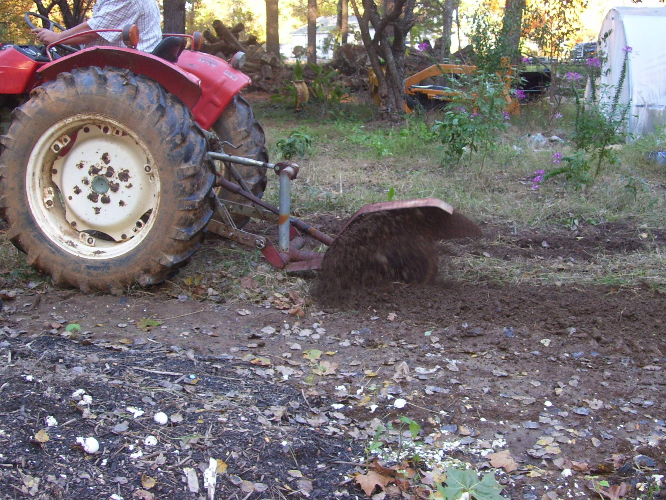

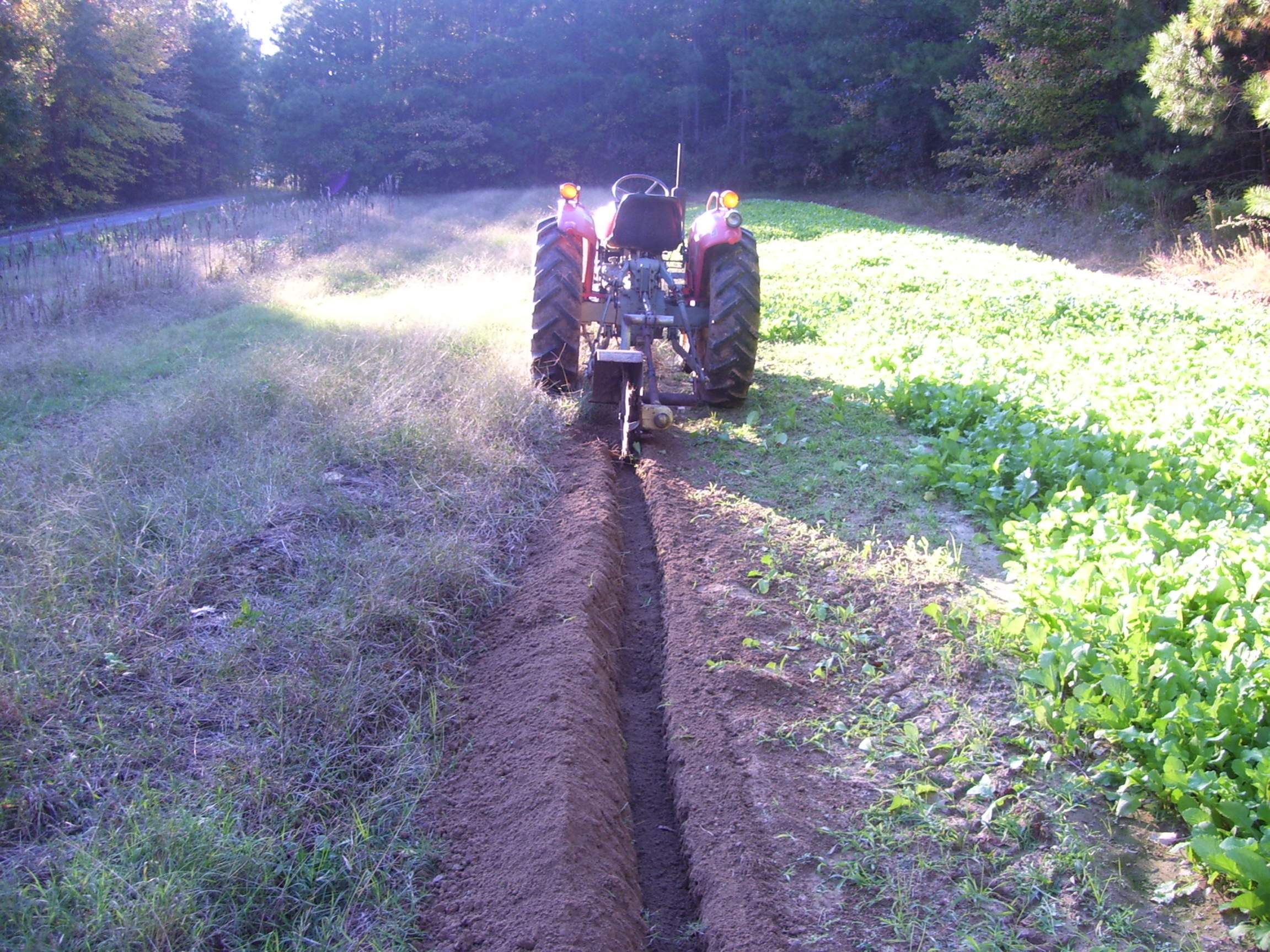

   / Trencher
Heres a few action shots of my trencher My wife took a few mud clods to the head, but hung in there for TBN. The fist one I was in soggy clay trenchin a slot for adding compost to the row to help with winter drainage. Then theres a tail shot and then a shot in some well drained topsoil in another garden I was just plying in to show the piling action. I picked up another tiller head I will add a few more teeth on it a little later. I need to find the crummer bar or build another one. its throwing about an inch of material back into the hole but its easy to remove with a shovel but a crummer bar will hold it and let it build up iand the wheel will take care of it.

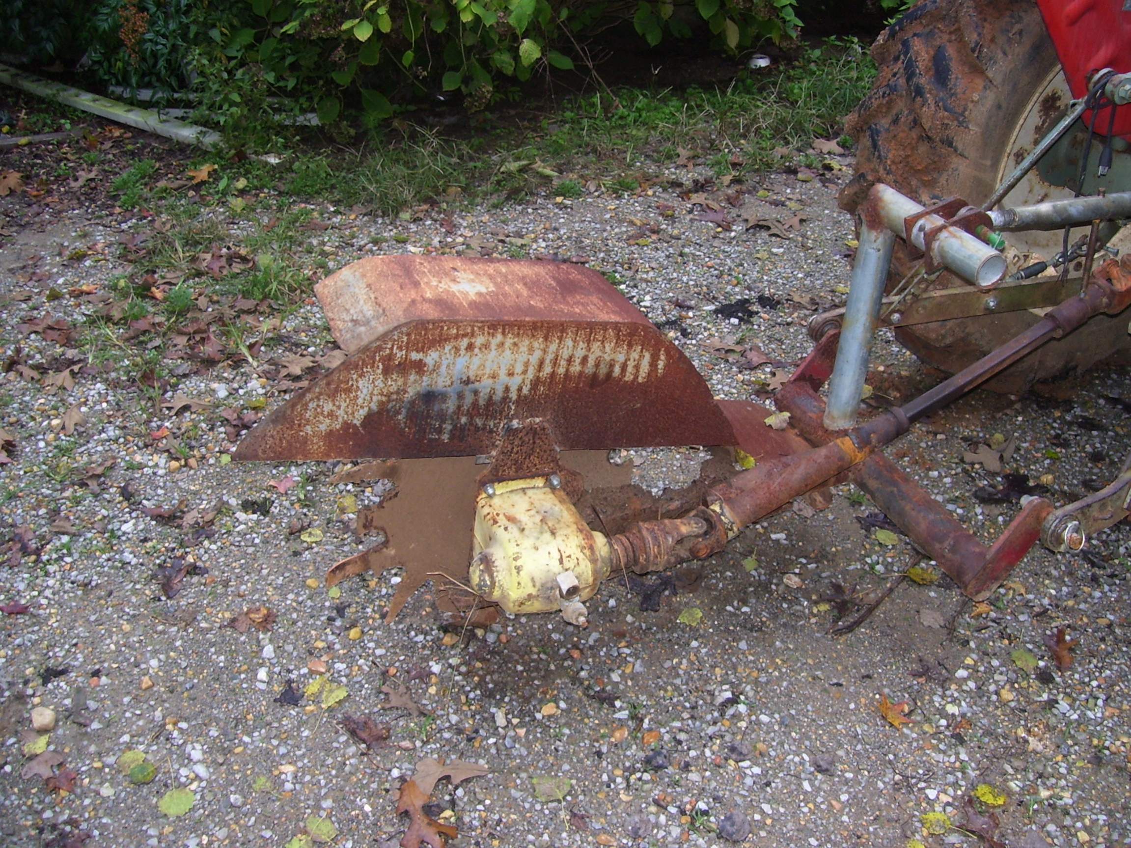

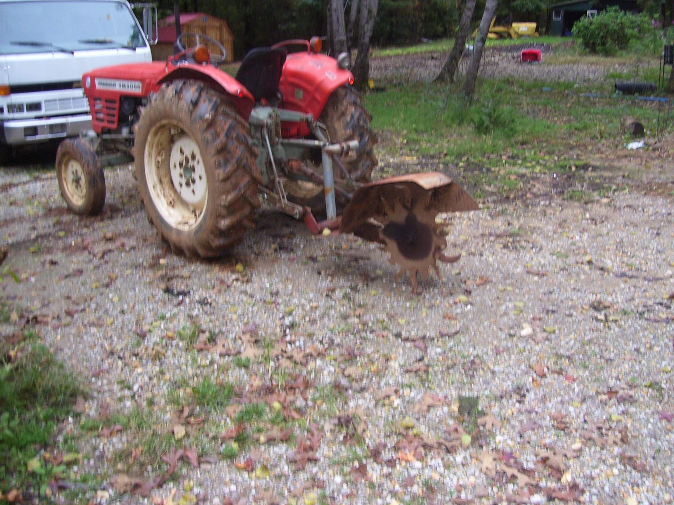

   / Trencher
#9
The tail shots

   / Trencher
#16
Thanks Don, it didnt turn out as clean as Id have like it to, I had to throw it together. the shroud was some corrugated RV subframe from a notch they put in the frames. the gear box was almosst free and the pipe was salvaged. I wished id have used a higher speeded box. I went on the principle of a saw blade course tooth pitch for soft material and a higher speed since I couldnt go Higher I need to add a few more teeth. I really basically use it on the place but have done a few jobs with it. One thing if you build one and use a cotton picker spindle box the hub thats splined has a shoulder that runs into the bearing , its actually the inner race. And the outside is toothed to fit the stripped drive. I took it off and the shaft flopped around. I drew the temper out by heating the teeth cherry red with a torch and let them cool. Then I turned them off int the lathe till they made a nice mount. I wanted to add the new teeth to it this week but after work Im helping a friend set up and repair a boring auger on an old Lima crane.
