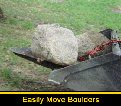

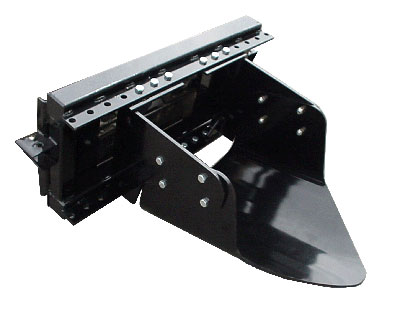

This is what I am talking about.

J_J, how thick is that spade. I could build something like that pretty easily.
   / Tree spade #23
Bob, They really don't say. They only state heavy gage steel. It does weigh 41 lbs. I am guessing 1/4 in. but 3/8 in would be stronger. They have about 5 different versions.
Here is a link.
Quick Spade
   / Tree spade #24
J_J, thanks for the link. It looks like for many things (like trenching) this is similar to a back hoe or minihoe, but it would not have the leverage of the curling backhoe. For taking out a stump it would be able to work around the tree and cut the roots. As an add on to a bucket I would see some advantages. Do you have any thoughts on this.
   / Tree spade #25
Bob, It would be good for those operators that do not have a mini-hoe. It is light weight, easy to install, and can dig faster and deeper than a human.

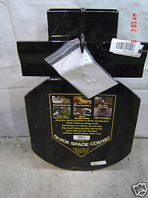

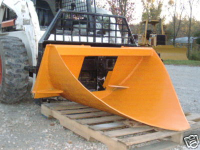

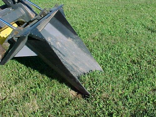

   / Tree spade #29
Moss, if you want to try the tree spade I made for my 425/refine ideas, contact me. I built mine from the frame rail of a semi tractor ( high carbon heat treated steel ?} similar to the picture JJ posted. Works fine up to 4'' hardwoods, after that the tap root is to much for lift capacity of tractor
