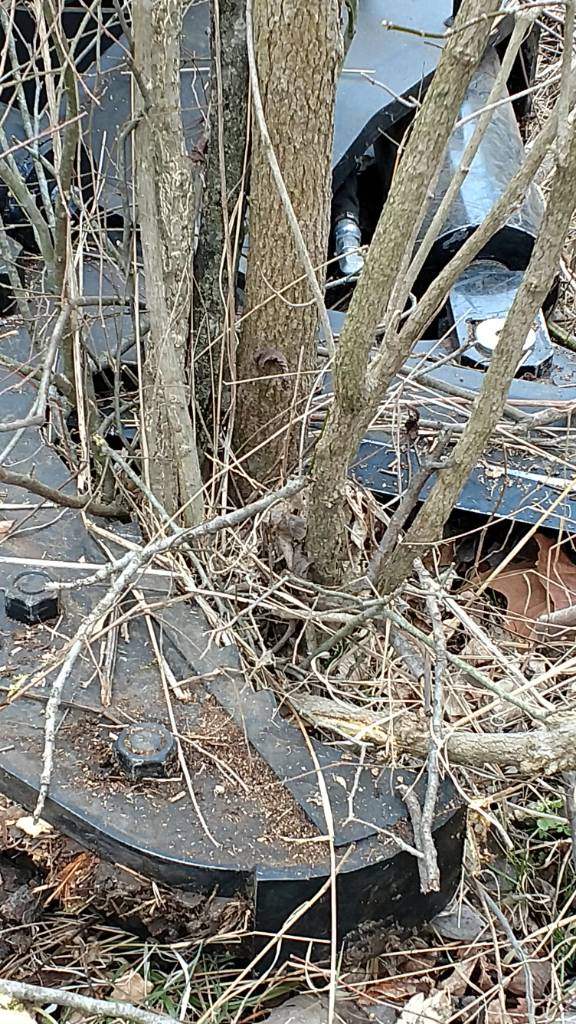

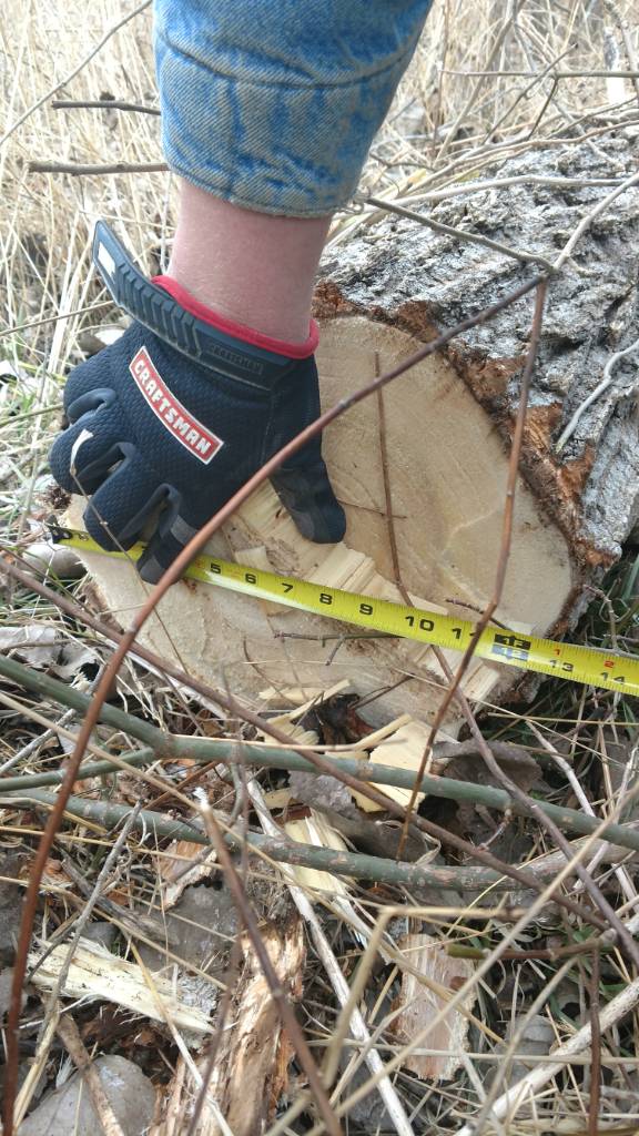

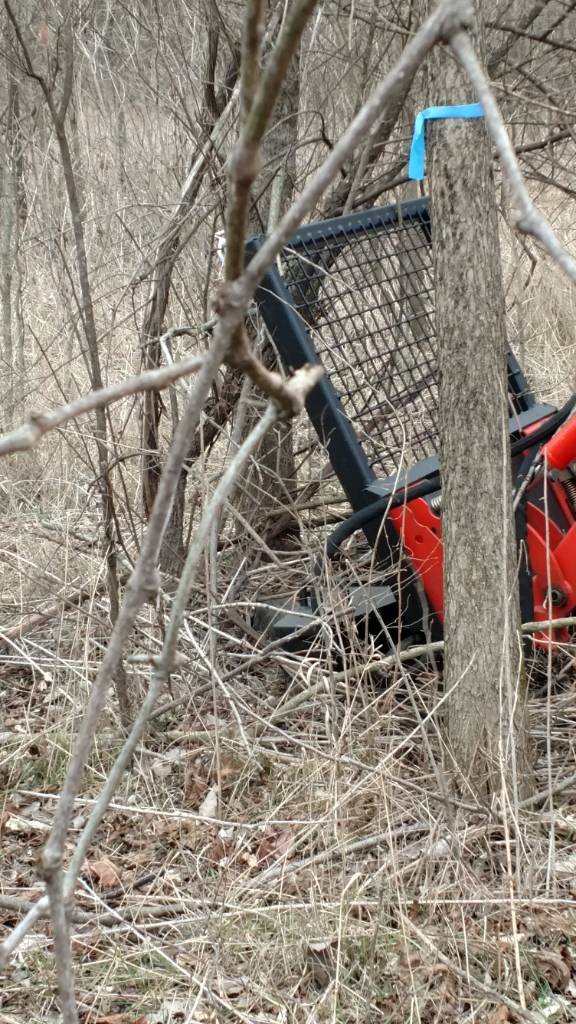

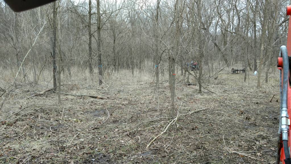

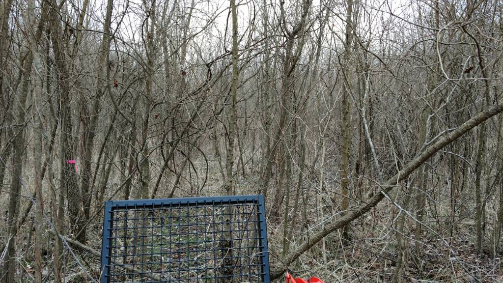

I got to use the tree shear today and I found it works great on my B26TLB Kubota as it handles the frozen ground with a little slime on it very well and it was able to move in and out of the trees I wanted save. With 7gpm to my loader 3 valve and about 2300 psi I was very impressed about 3-5 seconds to cut a larger tree and no way to tear it up with this machine.
Largest tree I could get it around was about 14" cottonwood and took and extra bite to get it but it did it. On the larger tree's I would cut them several times to make it easier to remove them with my grapple. On small groups of trees I could cut 3 or 4 at once. I attached a few photos but have not figured out how to do video. IMG_20180120_132025714.jpgIMG_20180120_115717548.jpgIMG_20180120_115721436.jpgIMG_20180120_104918830_BURST001.jpgIMG_20180120_110646158.jpg

Has to be selectively cut we planted them in rows 15-20 yrs ago and didn't keep up and keep cottonwood from coming in. We looked at using a mulching head but don't have a high flow machine. We have a really heavy landpride brush mower but most of this is larger than it wanted to handle.
