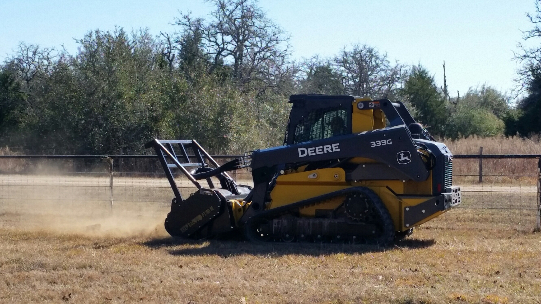

Good to have a neighbor with a mulching head. 5 stumps in 15 minutes.
