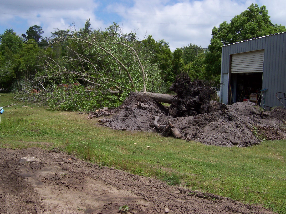

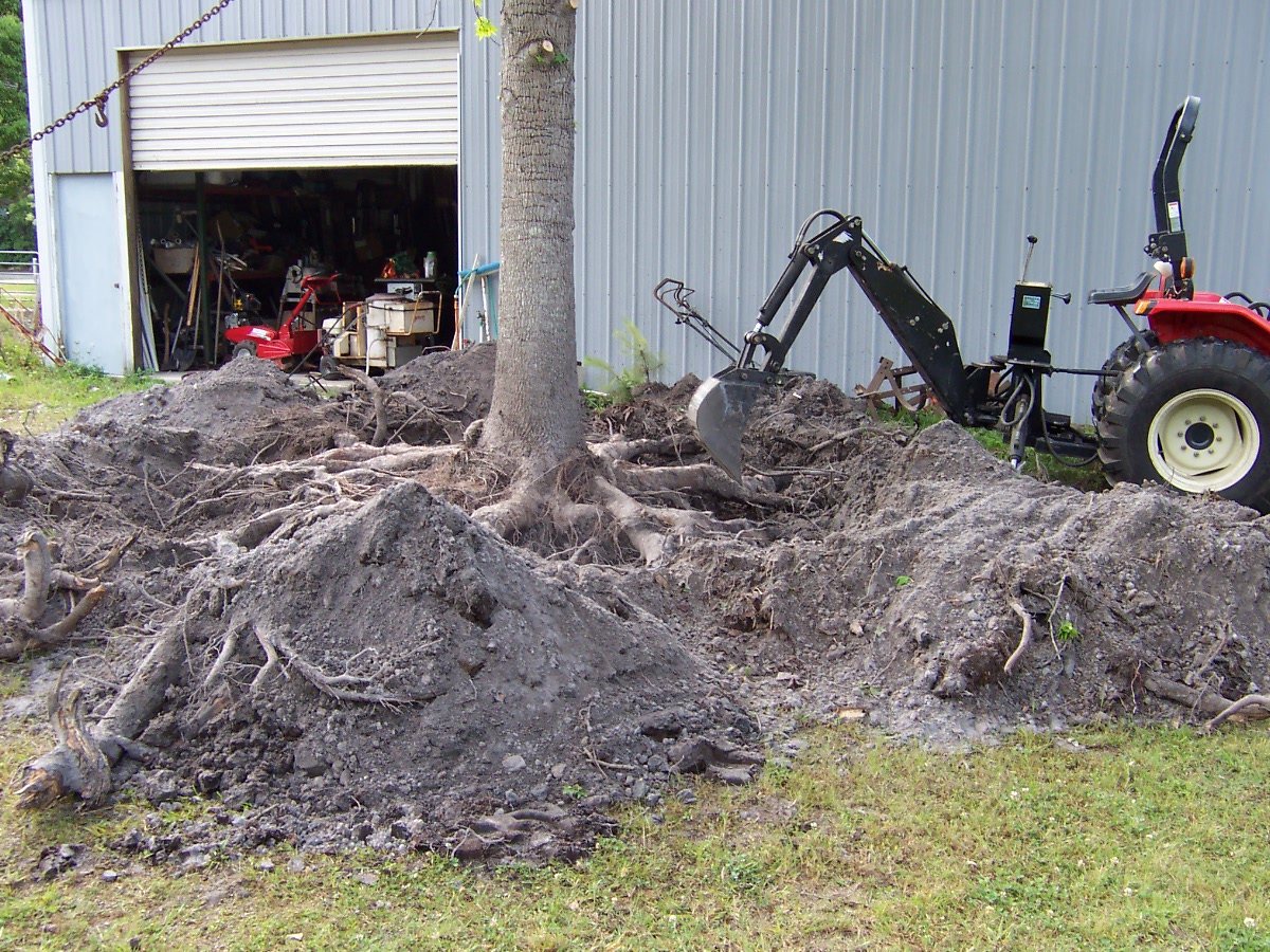

I wont debate the dangers of taking down a tree. It's very dangerous no matter the method used and common sense has to be used. I don't do it on windy days. There is never a rush to get one down, and if I have to wait a day or two, that's just what I do. On small trees, then cutting the roots on two sides is all it takes with my full sized loader/backhoe.
For bigger trees, I have to cut the roots all the way around and even undercut the tree some. I've taken out some pretty large trees this way. It's nerve racking, but so far, I'm still alive. Sometimes I've even had to turn my four sides of cutting into 8 sides. Those big trees are really stuck to the ground and fight you every inch of the way.
When my neighbor had a Cat 315 excavator on his land, he just pushed over most of the trees he wanted out. Rarely did they have to cut the roots, but when they did, it was only on two sides. More power, more weight.
