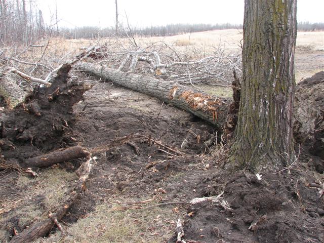

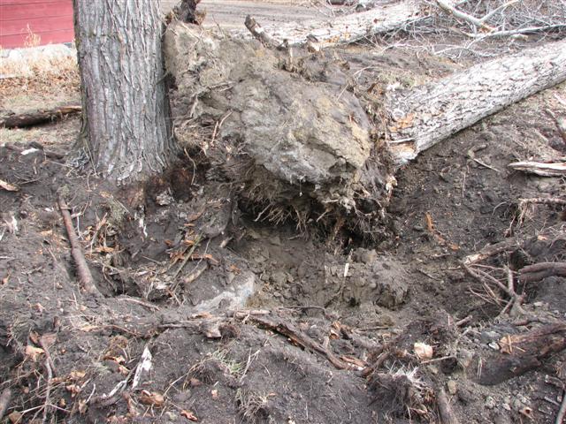

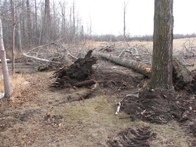

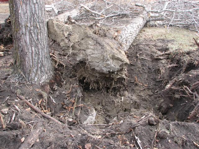

Montana R28
I had seen a fellow on this site that had removed trees by using his hoe. I have a 30 hp tractor with a hoe attachment I was not sure if it was big enough to do the job. Especially digging through some of the roots. My trees were close to 75 feet tall 60 inchs plus in diameter. Basically I dug all around the tree then gave it a push with the tractor. At first I was going to use the hoe end but decided not to as if I had to move fast there was to many things to lift, move contract, jump off hoe attachment, jump onto tractor, put in gear and drive. At my age I am not as nimble as I was once was.
After I was turned around I used the bucket pressed up against the tree to topple it. Here are some pics of my exploit.

/ Tree Removal with a Backhoe #2
Actually, this is a trick that I learned on TBN that has worked out very well... Only difference is that I throw a long and sturdy rope high in the tree before digging. I dig then move to a safe distance and pull tree over. This way I don't need to worry about moving quickly should things go wrong. I also get great leverage on the tree by going high. The only downside is that I need to find spare "dirt" to fill the void left by the rootball.
60 inches in circumference my booboo.
This is a great way to remove the root ball. Took me a little longer than 15 minutes to dig around the trees as the roots were rather large. My little hoe could only chip away at the larger roots. Although I was surprised at how easy it was to cut through the majority of them. Next time I will use a long cable to pull it over.
I had perfect conditions, nice sunny day no wind, it worked excellent.
