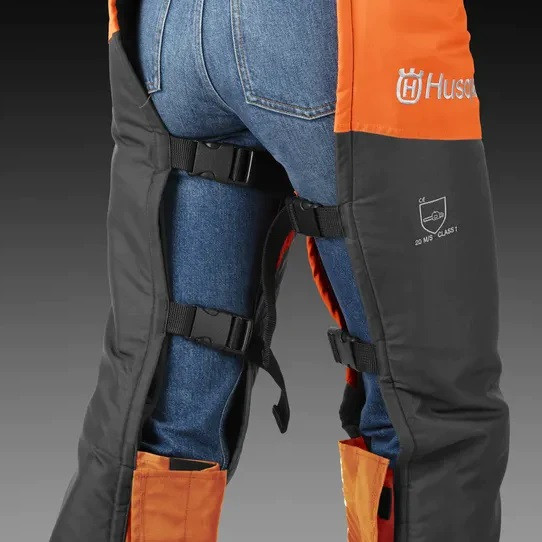

Yes, all of the chaps I've owned have been for over pants, and the wrap style you're considering for summer use have adjustable straps that go around the legs to hold them on, open in the back.
Those straps around the backs of the legs look incredibly uncomfortable. Never liked the feel of straps cutting into my skin all the way back to playing football with shoulder pad straps.

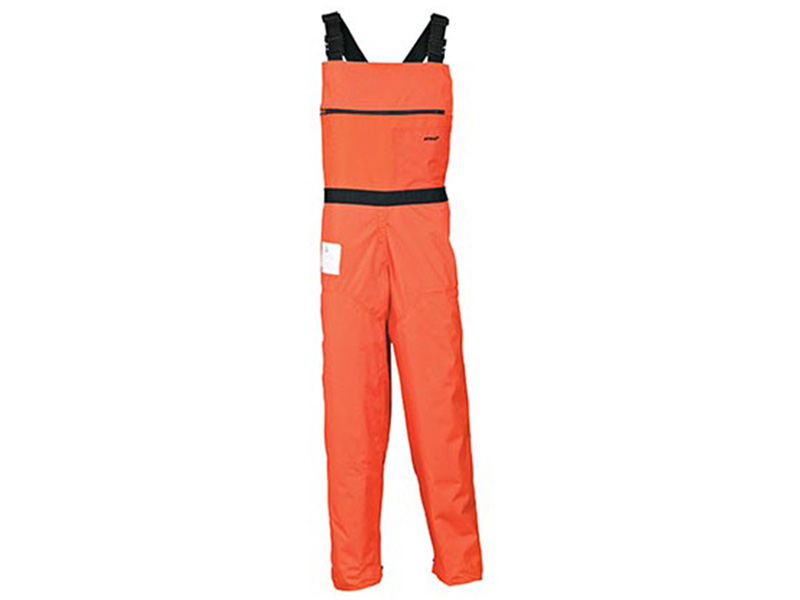

I usually wear skidder's chaps, which are full pants with a bib, that zip up the back with built-in belt and crossing shoulder suspenders. They are without a doubt the most comfortable and best protection, but they are hot. Great winter pants, except when you need to piss in the woods (gotta drop bib front and try not to dribble on it), but not a great pair for hot weather.
Those look like what I would wear in winter to replace my coveralls, but I bet they ain’t cheap.
I should do something though. Maybe the lighter style with the straps over my coveralls. Sounds like a hot, sweaty confined feeling.

The chaps I’ve worn for years have the straps on back. They have never bothered me. They are hot in the summer though and I only use a chainsaw in the summer if I have to.
/ Tree cutting accident #364
Same here. You had mentioned wearing them over heavy weather pants, and I was picturing some insulated snow pants style get-up. Over something like that, I'd bet the straps wouldn't bother anyone, which is the only reason I showed them. But these are actually what most wear, even with shorts in summer, and most seem to prefer them.
I think I paid $115 or $125 full-retail pricing for mine, 10-12 years ago. I suppose these could work as regular daily coveralls, but I usually prefer un-insulated denim coveralls for playing mechanic, I get too hot in anything else. Only time I don anything insulated for regular daily work is when I put on my Carhartt bunny suit for snow blowing. :)
There's a lot of good info in the link below. I know a lot of guys prefer the Husqvarna full-wrap chaps, so definitely check them out, too.
