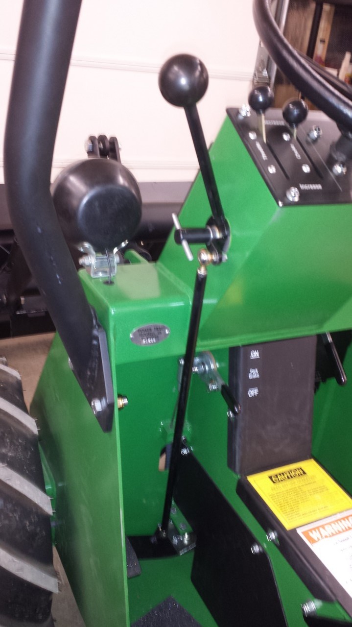

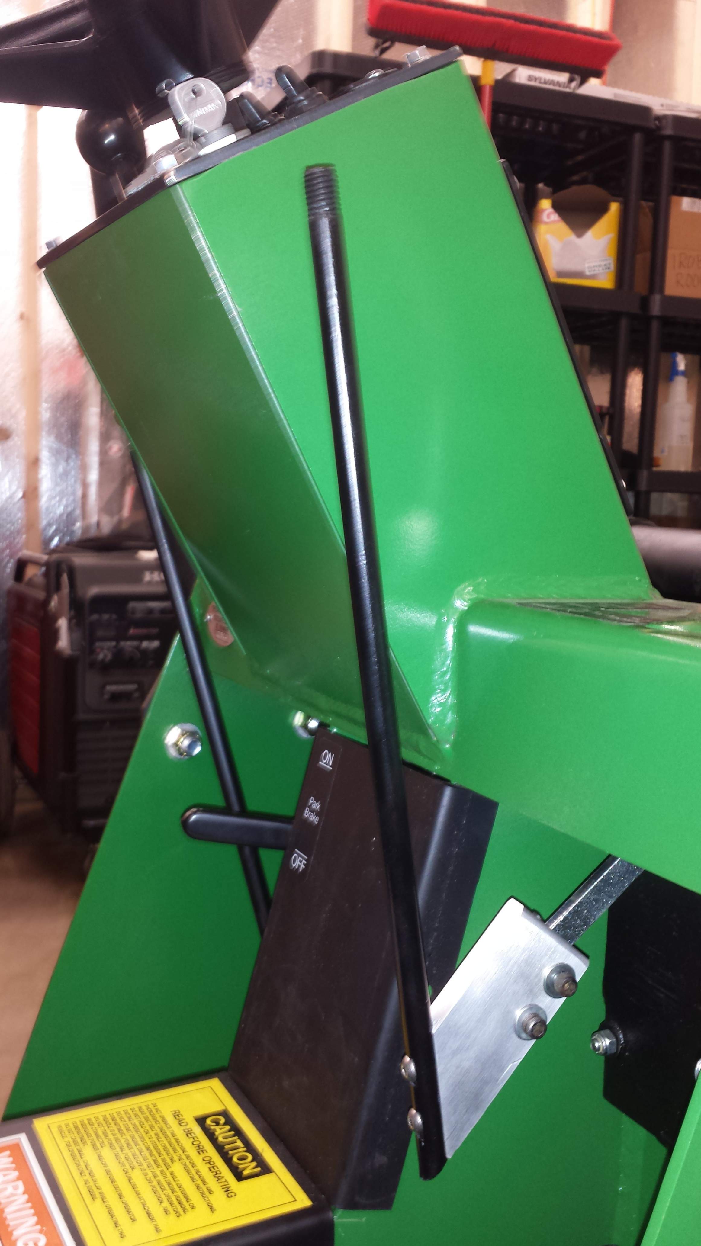

Josh and a few others, I think you wanted to see how they were going to make, or mount the hand control I had put on the 425.
They put a long skinny handle on it, (of which I didn't like) so I put some threads on it, and mounted a knob on the top of it, was a lot easier to use your palm of your hand to control it.
The "T" handle on the side of it lets you put more tension on it, and if you turn it all the way off it will let anyone use the treadle to drive the tractor. Came out pretty good, now to get some seat time in, and they are calling for nasty weather the next few days, but will let me learn more about things.
View attachment 417278 View attachment 417279 View attachment 417280
/ Treadle to hand control conversion on 1430 #130

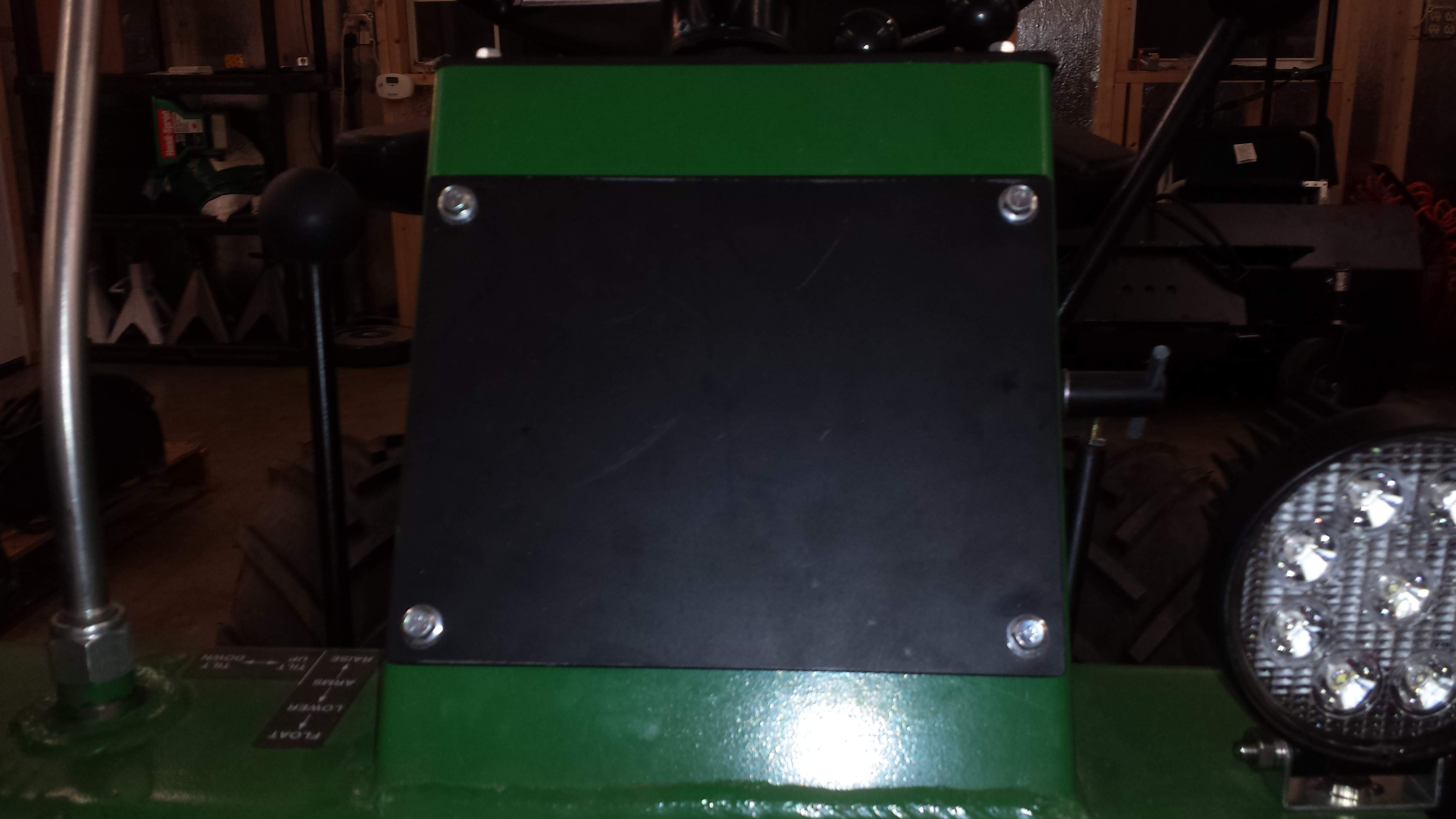

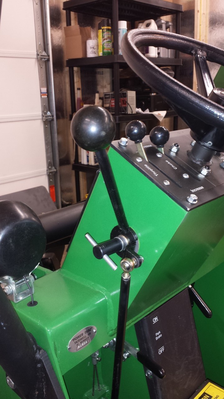

Here are the hand controls I came up with.
#131
Nice job on making the hand controls, but I only have one right hand, and reaching across with the other hand when you are trying to go into something slow to fill a bucket or other things is going to be hard to work both controls on the right.
Also, what are you going to do if you want to sell the machine, that is why it is so hard to sell the older tractors, with the hand control for forward/reverse, as everyone wants the foot controls.
If the control was like the Ventrac and you could pull it to the side, while going back and forth I could see that being on the right side would be useful.
Just my 2 cents, and after 30 some odd hours on mine, I am glad I put it on the left.

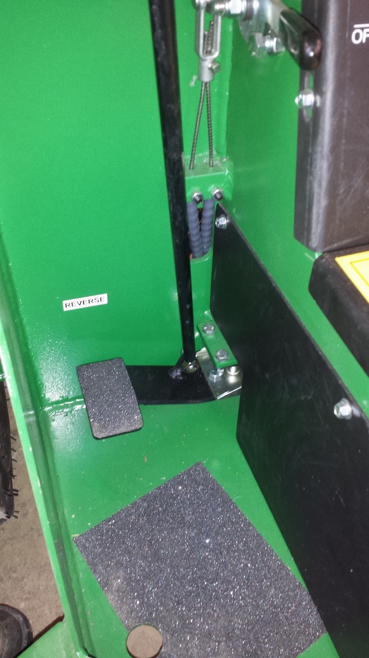

The treadle peadle (hey, that rhymes! :laughing:) I took off by just simply removing two 5/16" bolts, and then I made another out of a piece of 3/8"x 1 1/2" flat stock. I recommend that for you because you and I are sort of in the same boat, and not having the stock treadle there is so much roomier.

Josh- thanks for the picture of the bellcrank-pushrod arrangement inside the steering column. Genius. Seems like maybe that approach could be adapted to the aux hydraulics quick attach lever. Positioning it right next to the loader arm control would work out well.

Josh, I thought you had cut the stock pedal down. I know that I will have someone that I ask to move the machine around (when I am too tired or lazy to get on it, or to put it on a trailer to take it someplace) and think the treadle will be better for them to use, that is why I left mine on there.
I put my seat all the way back when I jump over to it, (long legs, and big feet) and then slide it up, and I have about 2 or so inches between my front of the shoe and it. Some times it might get in the way, but not that often, so I will just leave it on there.
