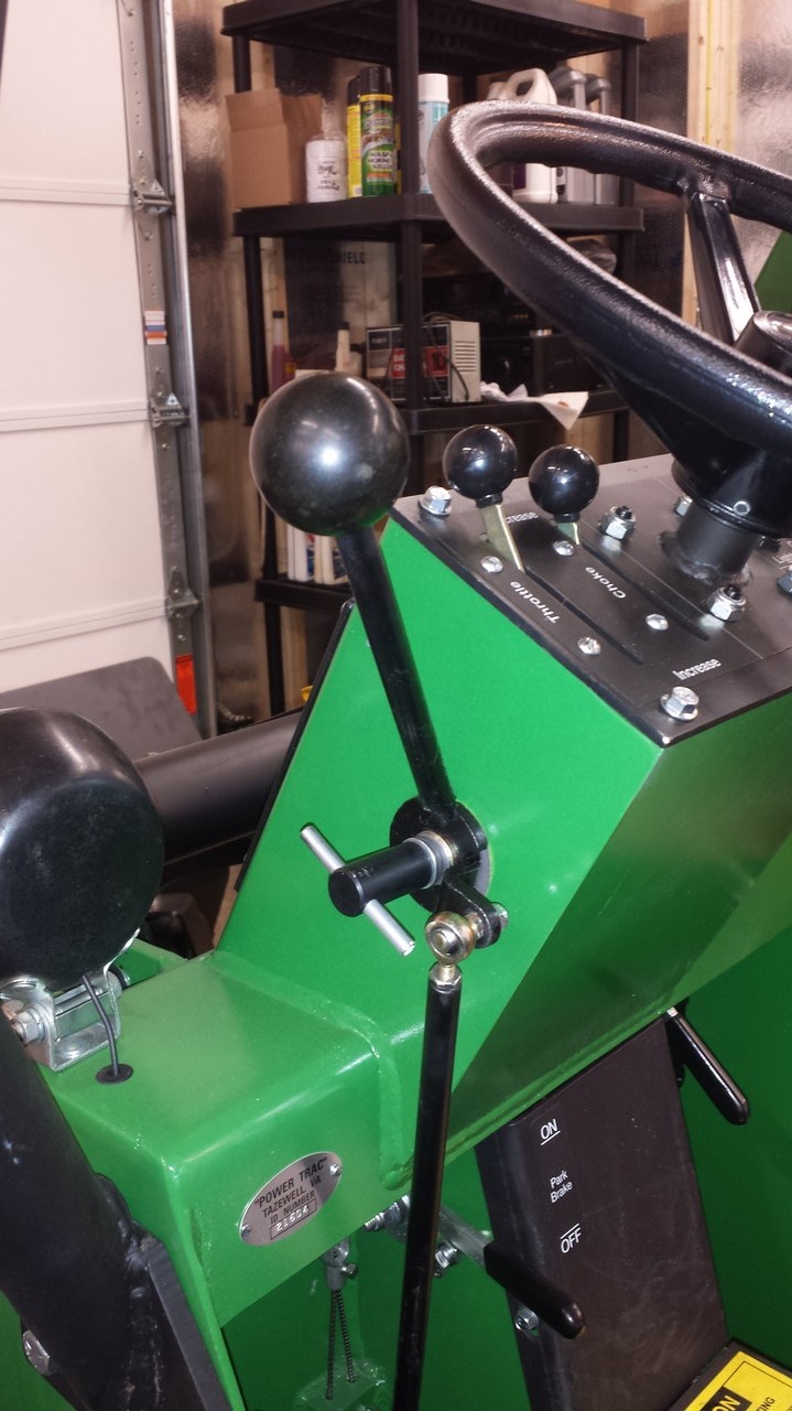

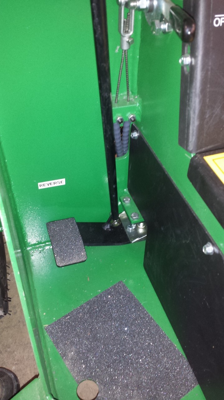

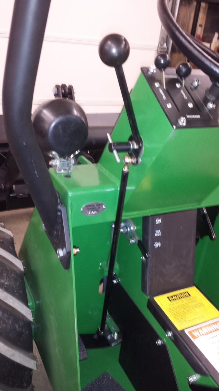

Josh and a few others, I think you wanted to see how they were going to make, or mount the hand control I had put on the 425.
They put a long skinny handle on it, (of which I didn't like) so I put some threads on it, and mounted a knob on the top of it, was a lot easier to use your palm of your hand to control it.
The "T" handle on the side of it lets you put more tension on it, and if you turn it all the way off it will let anyone use the treadle to drive the tractor. Came out pretty good, now to get some seat time in, and they are calling for nasty weather the next few days, but will let me learn more about things.

So push goes forwards and pull goes backward? Pretty slick! :thumbsup:
   / Treadle to hand control conversion on 1430
#80
Yes Moss, we tried to keep it as simple as possible. Has some washers, and the springs style or curved ones under it to put a little tension, and I put a bit of locktite on it, so it will act like a nylon nut, and won't come loose and stay where it should.
