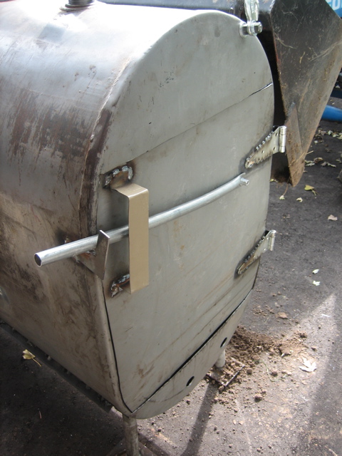

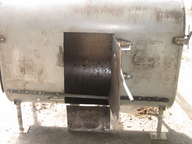

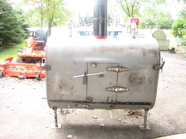

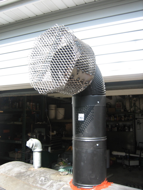

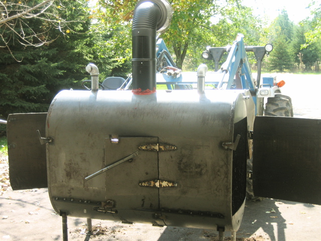

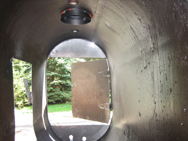

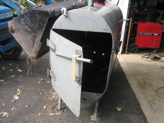

Made from a 250 gal fuel oil storage tank. Both ends open so you can put in a lot of long brush. The spark arrestor has 3/8" diamond shaped holes. In the middle, a lower door opens down for ashes and an upper door opens out for smaller stuff.

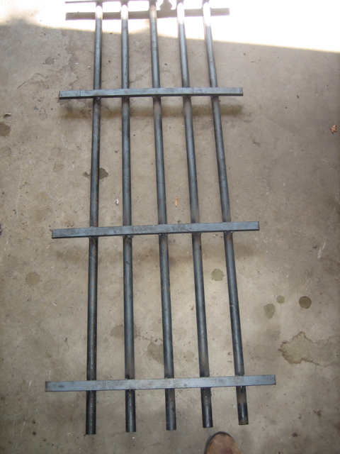

/ Trash burner, Ember arrestor
Grate is plenty heavy so it won't blow away

OK, that looks real good, but since we never see those fuel oil storage tanks in this part of the country, I was wondering about the thickness of the steel. Do you have to limit the size of the fire to keep the steel from getting too hot and warping? And with both ends having doors, why did you bother to cut a door in the side? Just curious.
/ Trash burner, Ember arrestor #11
I'm thinking like bird, once you get that thing fired up those doors are going to curl like potato chips, I see you made the latch's to accept alot of movement so maybe you'll be ok.
My Polish relatives are always making smoke stoves for meat and even well planned and built they still warp all to ****.
Good luck and let us know how it work out, I do know a guy who made a stove out of a tank but he framed the door with heavy steel, he's been burning all kind of junk in it for years heating his large shop.

Bird, I'll have measure the thickness but I'd estimate 3/16 th " It's thicker than a 55 gal drum. The center door helps with cleanout and smaller boxes etc. the bottom burned out of my 55 gal so I laid it on it's side and fed brush from both sides. I was impressed how well that worked so I scaled it up and corralled the embers better
Hopefully with the thing on stilts, more surface area, less water inside and ventilation that'll slow the rust.I used an air chisel to cut out the doors. Very slick and incredibly noisy.
You'll notice two hooks high just off center to avoid the chimney for carting it around.

I'd guess that 275gal tank is probably made of 10g sheet (just a hair over 1/8" thick). Those doors, & the surrounding areas, are going to warp like crazy.

Those are pretty straight cuts for an air chisel, Ive never used one but didn't think such clean cuts were possible.
