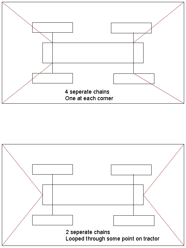

Gary,
To secure my tractor to trailer, I use two chains, one in front and one in back. Each chain stretches from left to right and loops around something on the tractor that is fairly mid-line. One binder per chain. Could you elaborate on how to properly secure a load using two attachment points? I've just been trying to use common sense (a commodity in short supply), but have never had any pointers.
OkieG
   / Transporting my Tractor #24
I'm not sure what you mean by left to right. I hope you're attaching opposite corners on your trailer (like right front and left rear). If you are, you ought to be ok.
I've seen equipment chained from the mid back to an attachment point on the left side of the trailer then looked at the front only to find a chain at the middle there running to an attachment point at the left side of the front of the trailer. At least that one will never slide off the right side of the trailer. /w3tcompact/icons/smile.gif
I still prefer the four point attachment with each axle near the wheel being on one end and the attachment points on the trailer being 3"-4" outside the attachment point on the axles and far enough away from the axle so the your chain or strap is at a 25-30 degree angle from the trailer floor to the axle.
   / Transporting my Tractor #25
Gary,
I apologize if my descriptiion was unclear. The way I have been attaching chains is one chain at the front of the tractor and one in back. The one in front keeps the tractor from sliding backward and the one in back prevents forward motion.
One end of the chain in front will be hooked to a tie down point at the front left side of the trailer, then threaded around the bumper or through the stiffener pipe of the fel, finally hooked to another tiedown at the front right of the trailer. The rear chain is placed the same way, except, of course, at the rear of the trailer, threaded around a suitable part of the back of the tractor, with each end of the chain connected one to the left side of the trailer and the other to the right side of the trailer. Each of the two chains is tightened with a binder. Then, I set the parking brake on the tractor and away I go.
The right front to left rear tiedown technique doesn't register. Sorry for the confusion.
OkieG

   / Transporting my Tractor #28
To all:
Attached is a drawing of two different methods that I've heard described. One is four chains and the other is two chains. Which one do you use? Two chains or four chains. You might have to scroll down to see the second example.
   / Transporting my Tractor #30
Your drawing of "2 chain" depicts the way I do it.
OkieG
