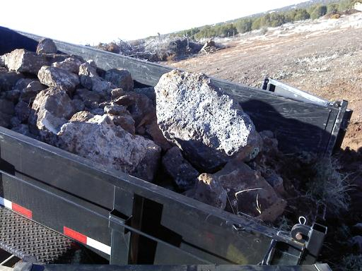

I would use sand bags, 4 or 5 per boulder, placed to inhibit movement. I use feed bags to help me move them easily. 60 to 80 lbs. of construction sand will do it, I think. Best of luck!

Do keep in mind that when driving on a public highway, you come under the rules and regulations of the DOT. Last time I checked, ANY load must be secured against movement. I told you how to secure them a ways back. You can either heed my advise or wing it but be apprised if you wing it and something happens, not only will you be liable for damages, you'll probably be ticked for an insecure load as well.
Your choice. I KNOW what mine would be.
Sage advice. Now to the second part of his question; what's the best way to do it. Your way is probably best... something about having done it commercially makes yours among the best.
Unless they are square, getting a normal chain to stay on a boulder will be a challenge. Some good suggestions above to do that... and others not so good. The suggestion of using biomass to help hold them in place would reduce the excess weight vs gravel or stone.(wood chips from a tree service would work well.)
In that case he would want a tarp as others suggested, to keep debris from blowing. Then a decent set of chains around each boulder... the chain link fence mentioned above would be a good way to hold the chains where you want them.
A cubic foot of granite weighs about 175 lbs.
The other thing not mentioned is that an object that big is going to make the trailer do funky things if it shifts. If we could plan when we were going to crash, it wouldn't be called an "Accident."

I think I agree with 5030. I like 5/16 chain G70 and binders on most things. Of course straps and chains must be labeled (G70 or Strap weigh rating). Not all straps are not equal. But none of this makes any difference unless you are stopped or in an accident, then everything seems to make a difference. I have never been stopped and inspected with a load, but I am careful to secure that best I can. In the end, do what YOU are comfortable with. I have an L4701 that I haul as far as 250 miles. The more I haul it, the more caution I use to be sure 4 pt tractor and each implement are secured.
Good question, rocks or boulders are difficult to capture. If possible, add another rock to see if you can pack against the sides to prevent lateral movement. Then maybe a piece of sheet stock (maybe 3/4" plywood) over the top and then chain and binders.
That said, it sounds like overkill. But in an accident, it might look just right. Best wishes, Larry

If you don't strap down a boulder and do get seen by a cop you will indeed pay a very large fine. No doubt about it. And in hauling boulders, the only thing that works are chains or rated straps over a safety net or with a pallet crushed on top of them and chained or strapped so they are securely restrained. You can also put a pallet under and pallet over if it's a biggie or really round. The pallet will mold (crush) itself to the rock and I've never seen one even try to move this way.
There is no "sort-of" OK or "pretty secure" when hauling big rocks because rocks are either 100% secure or 0% secure. Give them and inch and they'll take a mile. And if one ever did get loose, it will cause tremendous damage and/or loss of life so be prepared to lose everything you own and everything you will own and then plan on wearing stripes for a while.

/ Transporting boulders #77
I want to transport some boulders about 50 miles. I have a 5x8 heavy duty dump trailer that should probably handle 2 or 3 of them. How in the world do you fasten them down for transport? Or not bother?
The sides on my trailer are high enough where the boulders could not possible fall over the sides or the back. It's more if I was in an accident-- those boulders flying around could do some serious damage.
I don't have D-rings in my trailer ....
It depends on what size you are talking? Boulder is a subjective measurement! What diameter are they? With diameter you can figure average weight! You can then figure out how many to load! After all this your question is easier to answer because if straps on one boulder you use two one going over it to tie down behind it other over it to tie downs in front of it! If its a row if them pushed to front if trailer then just needs something to keep them from moving backwards! You may be surprised how many you can actually load before overweight!
/ Transporting boulders #78
About 3 feet across for each boulder. My trailer is rated for 3,500 lb payload. I don't know how much they weigh so maybe 1 or 2 max?
Retired Landscape Contractor. I have hauled a lot of boulders. Your 3' round boulder is over 2 tons. Beware: 3 1/2 foot is probably double that. Truckers don't like hauling boulders. When they do they often have a "rock truck" This is the truck that gets abused and looks like crap. Forgive me please but if you think your 3500# trailer is heavy duty, you are probably not experienced enough to do this.
Note: They can be strapped on a heavy duty pallet and loaded and unloadedby forklift. This gives you trucking options.
Best option is often buying them delivered!
