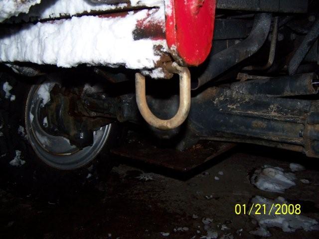

Here's my 2 cents for what its worth. I transport my 2615HST regularly on a 7K tiltbed trailer. I use 4 chains. In the beginning I ran the front chains over the loader frame that is bolted to the tractor. Later I welded on 2 d-rings (see pic) to the bottom of that frame and run the chains through them to the d-rings on the trailer with ratchet binders. On the rear I attached 2 grab hooks to existing holes in the lower lift arms and connect my chains to them. I ratchet all 4 corners tight and haven't had a problem yet. I have made a few panic stops where idiots pulled out in front of me and the tractor never moved.
When I put the tractor on the trailer it's in low range, in 4 wheel drive and the brake pedal is locked.

I ordered 12,000 lb forged d-rings to weld on the front of the tractor and grade 70 clevis hooks to mount to the open holes in the lower lift arms just like George2615 did. I also ordered extra d-rings to weld to the trailer so it fits my load verses using the existing trailer pockets. I have 4-20 foot sections of grade 70 5/16 truckers chain that I will cut for each one of the 4 ends and binders. Called in on a favor from my brother in-law to use his welder. The working load of the 5/16 chain and clevis hooks is rated at 4700 lbs and I'm only going to be around 3200 lbs. That should be enough to get the job done and be secure. The grade 70 stuff is CA DOT approved and I guess if you can use it there, I should be able to use it in 'the sticks' here in Idaho..ha

Just to follow up I did the same as Marty. Once I placed the tractor on the trailer where I wanted it, I welded the larger 12K rated D-rings on the trailer for securing points rather than use the stake pockets. The two I welded to the tractor frame are 5K rated each. The chains I used were 2 - 20' x 3/8" lengths that I cut in half and added clevis hooks to make 4 chains.
