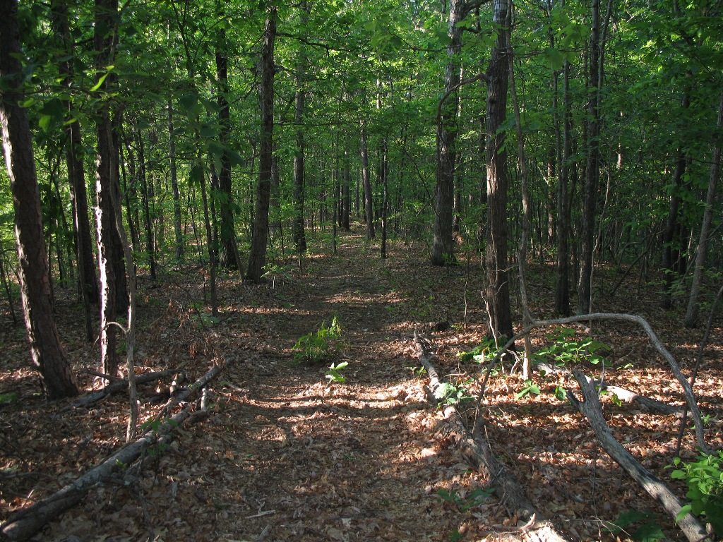

Here is a pix of a trial I cut in pre-tractor...I used a chain saw and a machete.
I am going to try the brush hog method next time...I have almost all big woods so it's
fairly open except for some small stuff here and there.
TC29, your woods looks similar to what I'm trying to cut a trail through. How much trail did you cut and how long did it take with a chainsaw and machete? I have started a section, but it's looking like it could be quite a project. I'm going around 60-70 acres.

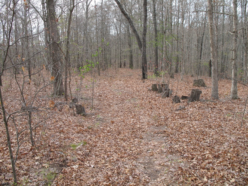

I have about a mile of trails so far. I flagged the trials path by walking down the top of my ridges marking with orange tape while staying away from the big stuff. I tried to stay on the top (more level) but the ridge really dictated where I went, I tried to stay on a fairly straight line.
I cut all the little stuff iin the trail down to ground level with the saw and then trimmed the trees on either side with my machete to allow my four wheeler and me a clear ride. It took me 1 day to do the first trail, about 1/4 mile. I didn't take anything down bigger than 3". Make sure to have more than one chainsaw chain, if you hit dirt (you will) it will dull the chain in a heartbeat.
I would chainsaw for a while and then rest by dragging off the cut stuff. I piled it up near the property line and have 3 nice brush piles. Honestly, it was more fun than work.
Attached is a pix from last spring...shows more of the same...I am lucky, my woods are pretty open with lots of large pines, oaks, walnuts, hickories, etc.
In this case I reclaimed an old logging road.
I have since gone back and grubbed out a few small stumps that were in my tires path...the rest are slowly getting loser and should disappear over time.
Sorry for the long winded answer. Make sure you have lots of water...and have fun!
