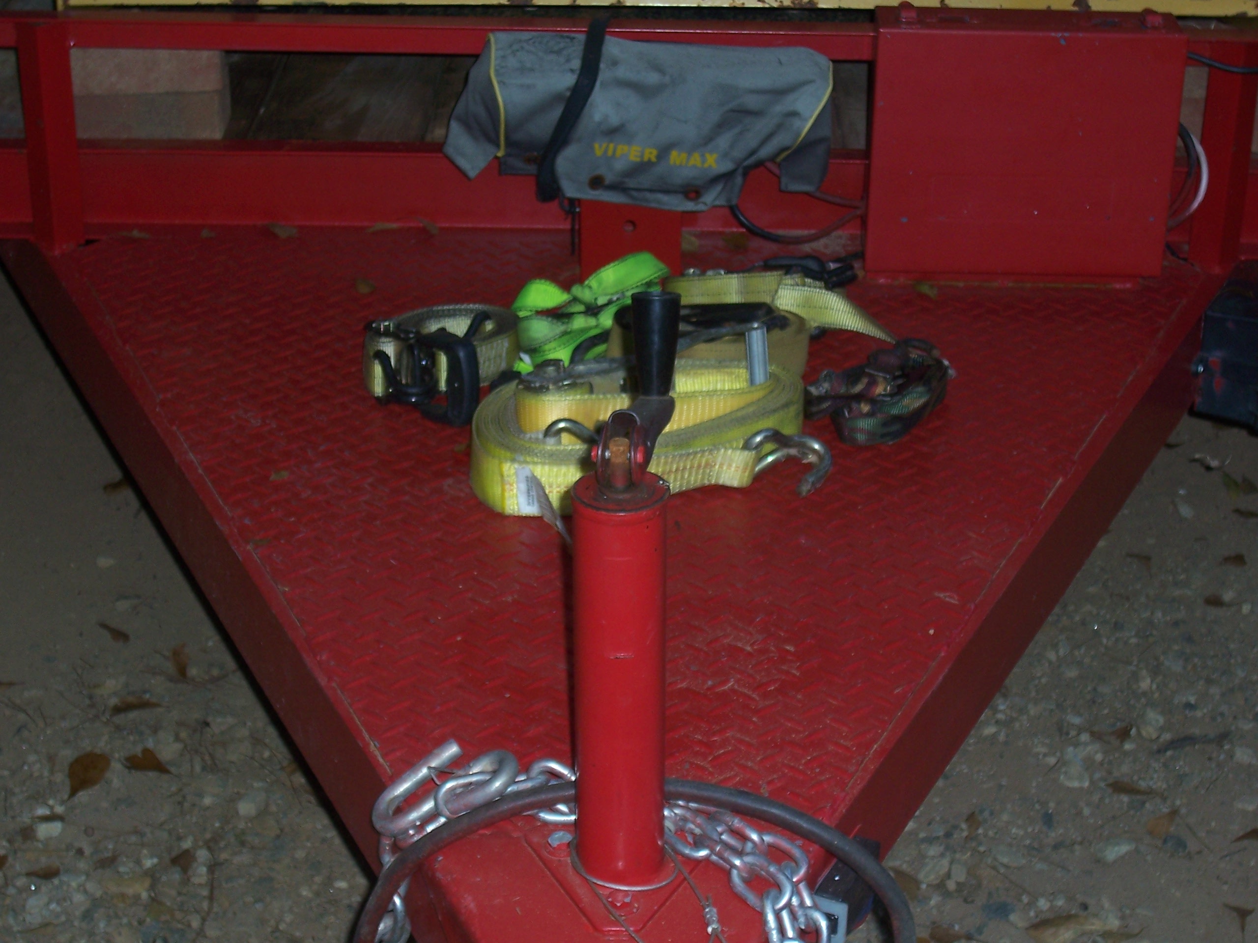

I'm with jgrreed I had a feeling were this was going to go after making a post/reply early. Esp. since I am Known to show up on Trailers and transportation forum. Hopefully everyone is down to the final shakes by now in this peeing match.:laughing:
To be honest I use both. If I'm staying local I will just strap everything down real good. It won't scratch everything up which I keep carpet scraps as a buffer for the chains. Since I'm from WV. lived in Md. and go through Va. regularly and know the Roads and Highways all to well. If I'm pulling a tractor on the Trailer I'm bringing out the chains. If I'm traveling from Ga. with the speed limit 65 mph. Thats way to fast to secure down equipment that weights a Ton+ with just straps. I have cut and broke straps and lost them trailering the 4 wheelers before. Not me!!!!! I have all kinds of staps If there would be a accident at highway speeds IMO. they will not hold that much weight down period. Implements may be a different story BB. Plow. Mower that doesn't weigh a few hundred Lbs. straps would likely hold. Plus I would rather keep up with a few chains when these straps aren't enough to tie everything down :(

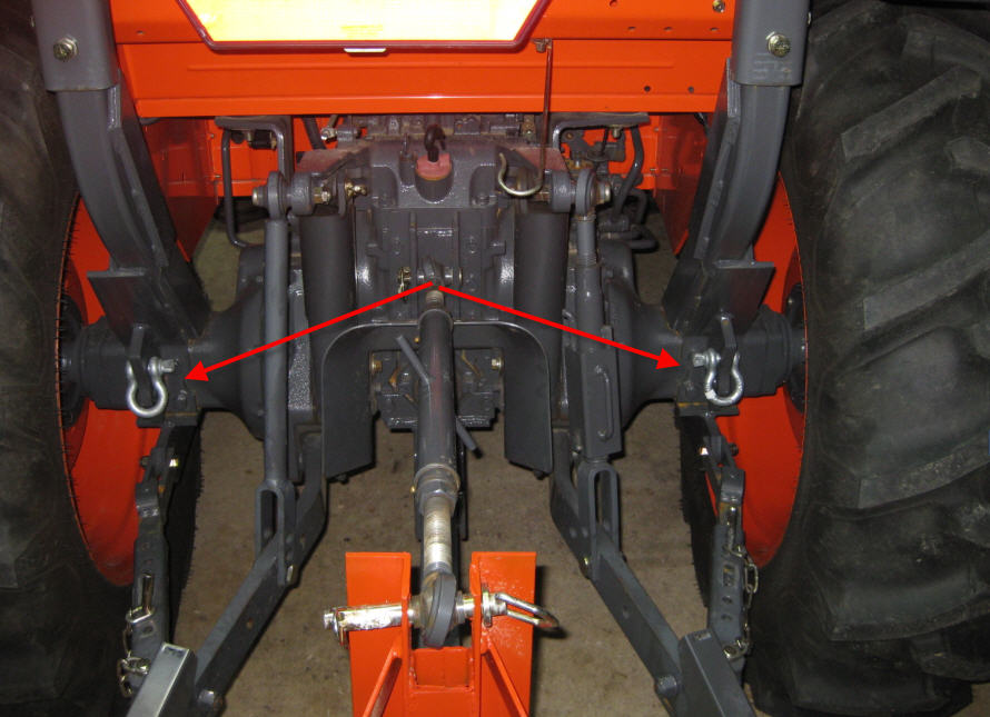

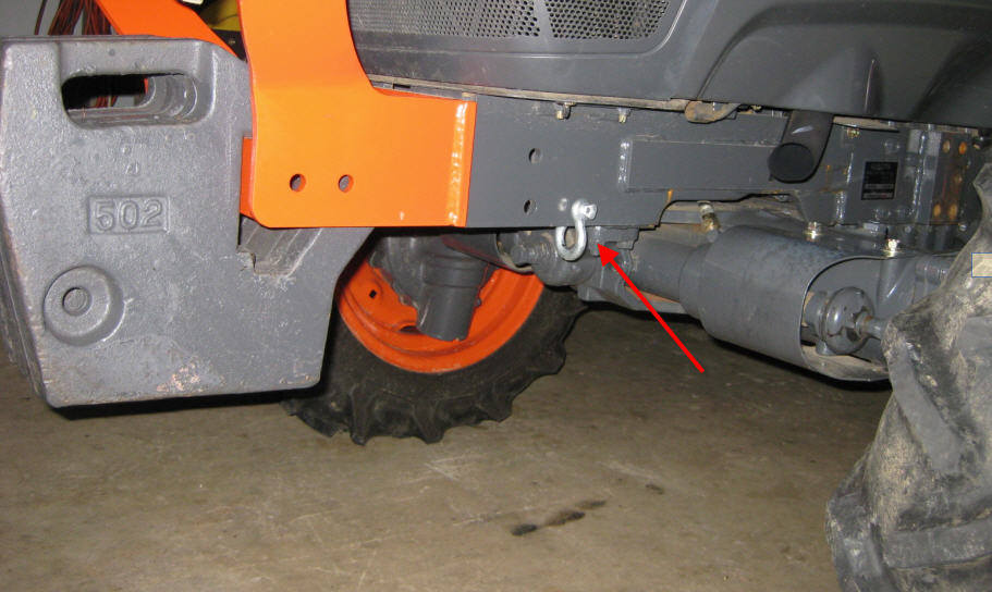

/ Trailering..... #27
This is what I found works for me. I use 4 racket straps on all four corners. Make sure that straps dont rubbbb anything. I have a clevis on each corner makes it easy to hook to. Straps are 4,000 lbs breaking strength and 1,600 load. So 4 holds my 3500 lbs tractor in place. Pics are where I put the clevies.. I trailer my tractor everytime I use it... :thumbsup:
AndyG
