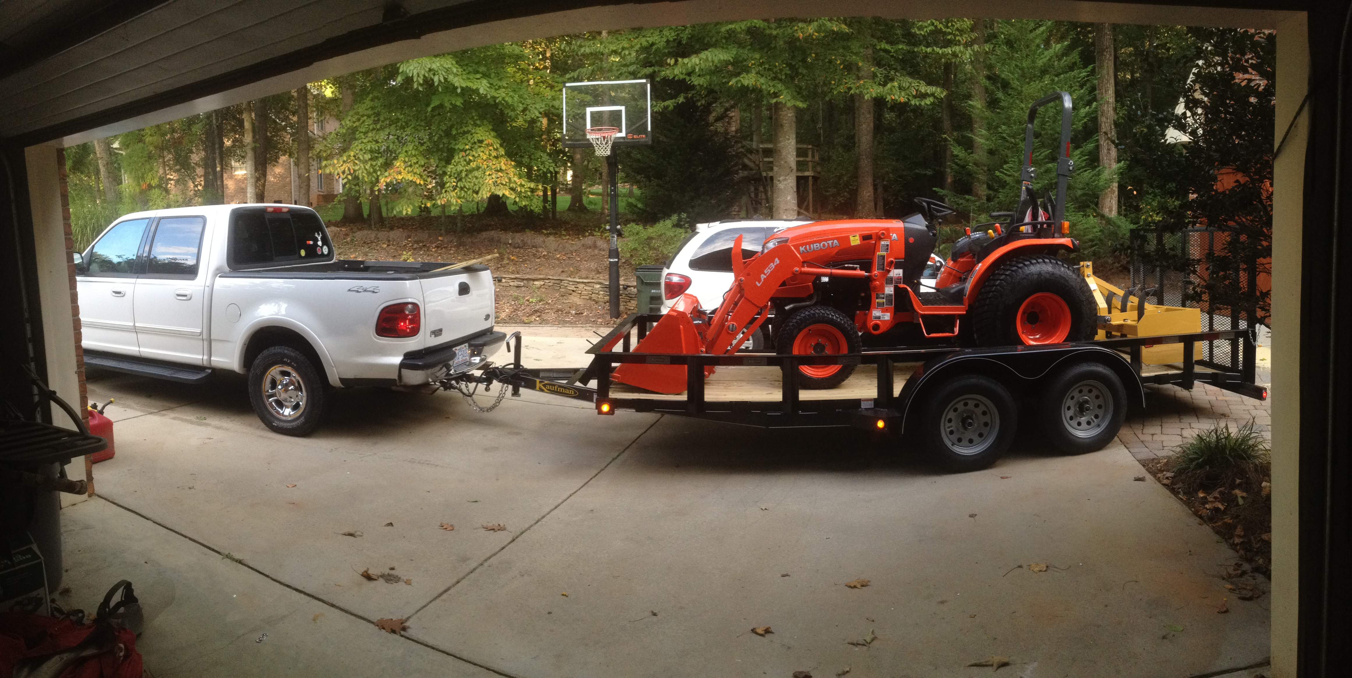

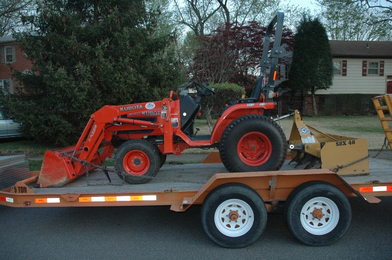

Just picked up a freshly built tandem 7000lb GVWR landscape trailer at the factory just south of us in Lexington, NC (Kaufman Trailers). I was wondering about tie-down chains / straps to use when transporting a compact tractor like the B2650 with loader and box blade shown? In the pic below, I don't have it tied down yet. It was the first time I put it the tractor on the trailer. Very easy to load and unload. If you all have any recommendations on how and with what to tie down a tractor of this type, fire away. I'd appreciate it. IMG_9653.jpg

I have a similar tractor, but with a BH. What I did was buy two 20' 5/16 grade 70 tow chains from Lowes (best price around at the time). They were cut in half with and a clevis grade 70 hook added to each cut end. Add 4 chain binders and attach one to each corner of tractor frame to the trailer. The FEL and BH get a heavy duty strap.
There is a weight limit which I believe your tractor and mine is under (I forget the number) that I believe only one grade 70 chain on front and back would be legal, along with proper securing of FEL and attachment. But 4 chains made more sense to me. I am sure others will chime in with more specifics on weight minimum requirements. It has been discussed many times and if you do a search you will find many threads on this topic.
Anyway, that is what I do and I feel quite secure towing with this setup. I have a 7k 18' car hauler with brakes on both axles. If I had it to do over I would have gotten a 10k and probably 20' long trailer. But I did do a few mods on trailer for convenience and overall the set up works well for me as long as I don't buy a larger tractor!
Your gate/ramp must be pretty well reinforced to hold up to the weight.

I use to chain my tractor down and used ratchet binders DOT says it has to be bound on all 4 corners with separate tension device. I then bought some weld on 1/2 D rings put 2 on each bucket corner and on loader at pivot point and on both sides of quick hitch then bolted lashing winches
that take a 2 inch strap with a slip hook on end the winches have spring loaded locking device and you tighten with a 1 1/8 wrench much faster than chain and binders

Gate is rated at 3000 lbs. which is just about what the tractor loader and box blade are. What they told me was if the wheel base is longer than the gate (which it is) then the full load of the tractor will never be on the gate. It gets partially distributed to the trailer once the front wheels hit it. I wanted the gate. The trailer will be used for much more than just hauling the tractor. On tying the tractor down on four corners with independent chains - the dealer delivered it using just 2 chains. I'll dig into this deeper in the next few days. The first time I have it scheduled to work outside my property is in 2 weeks. By then, I should be all set up for travel.

If you go by DOT regulations you need to chain/strap the tractor at 4 points AND chain/strap any implements (including the loader). I think you are only permitted chain (not strap) if you are hauling machinery or metal (potentially sharp or cutty) over 10 or 15k lbs.
While a 3pt or loader frame is more than capable of stopping the tractor dead, its a flexible joint & serviced by hydraulics. Generally you shouldn't trust hydraulics with your life, they leak down, hoses rupture, etc. Your 3pt doesn't have down pressure, so that implement is just being held down by gravity & you can't trust gravity in an accident.
I'm not a CDL but try to stick to the DOT regs if I can. The regs are there for a reason & it will keep cops from getting nitpicky.

If under 10,000 lbs, it looks like two tie-downs are the minimum under the Federal Motor Carrier Administration rules in section 393.128 (rules for securing automobiles, trucks and light vans) Regulations Section | Federal Motor Carrier Safety Administration....
(a) Applicability. The rules in this section apply to the transportation of automobiles, light trucks, and vans which individually weigh 4,536 kg. (10,000 lb) or less. Vehicles which individually are heavier than 4,536 kg (10,000 lb) must be secured in accordance with the provisions of ァ 393.130 of this part.
(b) Securement of automobiles, light trucks, and vans. (1) Automobiles, light trucks, and vans must be restrained at both the front and rear to prevent lateral, forward, rearward, and vertical movement using a minimum of two tiedowns.

(a) Applicability. The rules in this section apply to the transportation of heavy vehicles, equipment and machinery which operate on wheels or tracks, such as front end loaders, bulldozers, tractors, and power shovels and which individually weigh 4,536 kg (10,000 lb.) or more. Vehicles, equipment and machinery which is lighter than 4,536 kg (10,000 lb.) may also be secured in accordance with the provisions of this section, with ァ 393.128, or in accordance with the provisions of ァァ 393.100 through 393.114.
(b) Preparation of equipment being transported. (1) Accessory equipment, such as hydraulic shovels, must be completely lowered and secured to the vehicle.
(2) Articulated vehicles shall be restrained in a manner that prevents articulation while in transit.
(c) Securement of heavy vehicles, equipment or machinery with crawler tracks or wheels. (1) In addition to the requirements of paragraph (b) of this section, heavy equipment or machinery with crawler tracks or wheels must be restrained against movement in the lateral, forward, rearward, and vertical direction using a minimum of four tiedowns.
(2) Each of the tiedowns must be affixed as close as practicable to the front and rear of the vehicle, or mounting points on the vehicle that have been specifically designed for that purpose.

Well, you've got all the rules, 4 points chained and implements strapped, but WHERE do you position the tractor?
Try and figure out what ancillary equipment will be hauled and maybe put ON the trailer. Stuff like fuel cans, chain saw, brush cutter, come-along, winch, etc. You might want to put a tongue box on the trailer that you can put that stuff in (except the brush cutter) and store the chains and binders in when NOT traveling. Also - do you have a spare trailer tire?.
Once you figure where everything will go check the tongue weight. You might have to roll the tractor or turn it around for correct weight distribution to get the about 12.5% (+ or - 2.5%) on the tongue. Then when you've got your "full rolling package" mark where the tires are so you can put it there again quickly.
