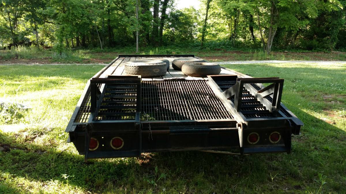

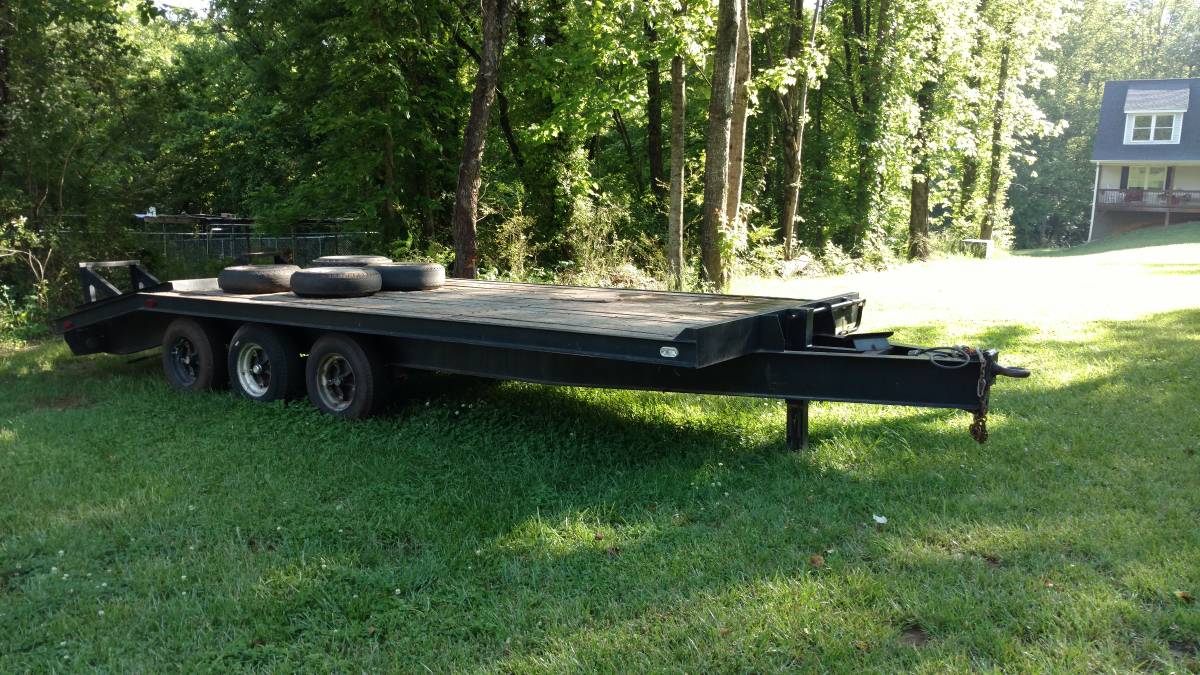

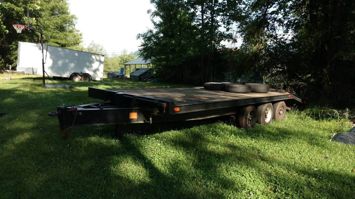

I am going to look at this trailer later today...
No title purchased in South Carolina...
Brakes on two axles...
All lights work...
No issues...
Owner stated that it was too big for him...
Any input would be appreciated...

Is that an old trailer house frame and axles? If it is, that would be a red flag for me. There is no title, so it is probably home made but why didn't the guy get a salvage title for it? If I could buy it really cheap and use it off road, on the farm I would. Other wise I would walk away.

I would look into the process of obtaining a title and registration for your state prior to buying it. Some states make it very expensive. The axles are a red flag for me as well. Load rating, have they been shortened...

Thanks for the help gentlemen. In NC you can register it as home made. The process is straightforward. It occurs quite often since South Carolina does not require a title and some folks buy SC trailers. I know those axles could be mobile home axles. Quite a few of Hudson trailers utilize this type of axle but they are Dexter heavy duty trailer axles. It caught my eye too. IMHO I want trailer axles but I know lots of guys around here running mobile home axles with no issues.
The owner stated that the trailer was heavier than he needed. No issues other than that. If those axles check out and the price is OK I may bring it home. It is 16' with a 4' dovetail. As well as it is built, if it was homemade, why would someone utilize mobile home axles unless they just had them available.

Went and looked at the trailer this afternoon. It is nice. It has two new tires on it, brakes on two axles, 10" I beam main frame, 20' total including 4' self cleaning dovetail. Got him down on price to what I consider reasonable. He would even throw in the adjustable pintle receiver. I don't really need this heavy of a trailer but my 4610 SU tires are set out is too wide for a 82" trailer. Had to do that to facilitate the ROPS. Still debating to buy or not. If it was titled it would bring a whole lot more. His asking price was 2K.

What were the axles? If MH I would walk. If Budd type trailer axles I would give $1500 and convert the hubs to standard 6 lugs. That would cost about a grand for 7 tires, 7 wheels, and 6 hubs.

That is what I was thinking Chris. I asked him if they were MH axles or trailer type and he did not know for sure. What type of ID would I look for on the axle to show that is a trailer axle? I had that exact number in mind Chris and we got really close to it. I''m going to give him a call tonight to confirm the axle type.

Get underneath and look at how the brake backing plates are attached to the axle tubes. Usually, welded on means MH axle, bolted to a flange means HD trailer axles.
A weaker clue would be the tires. They may say "For mobile home use only." Some states won't register one with MH tires, as you are violating one of the equipment restrictions, just like having a 5K coupler on a 10K trailer.
Unbraked axle: Many states require brakes on all axles if the gross trailer weight is over 3000lbs.

Just found out that the axles have not been cut. Owner will check hub backing plate tomorrow. One thing that I noticed was that on the front of the frame you can see where an manufacturer ID tag was attached. It was not on it so I don't understand why it was not there. The rivets were still on the frame. The trailer has the build quality of a factory made unit.

A couple years ago I bought a new 20 ft PJ equipment trailer 14k rating 8 lug LRE tires brakes both axles dovetail ramps, for $4100. $2000 for no-VIN, no-registration, no-name axles is too much. A 10 inch I beam frame is huge overkill on 16 ft trailer unless hauling maybe uranium or gold.
