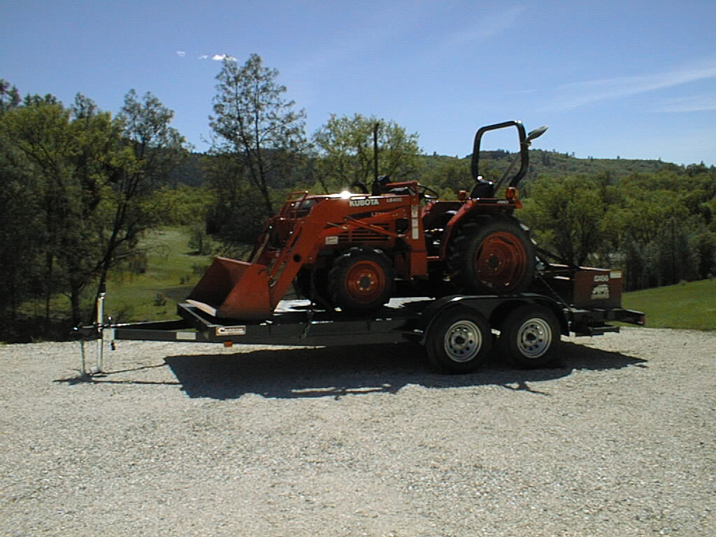

tdenny, I have a 16 ft. duel axle rated for 7k with brakes on the front axle only. (see atachment) I use my wife's Jeep GC to pull the tractor to my antique shop about 12 miles away a few times a year to cut the grass in the back. Never have I had a problem with this set up, even got my Zamboni home on this trailer with the jeep pulling it! Thank god, it was only 10 miles! Was way overloaded, but we made it!/w3tcompact/icons/smile.gif

Turfman, if your stake pockets are welded on to the outside of your outer rail as opposed to cut into the outer rail, I have a suggestion for you. I didn't think I had enough tie down points on my trailer (does anyone ever think they have TOO MANY? /w3tcompact/icons/grin.gif ) so I decided to add some.
I took some square tubing with an outside dimension of 1 9/16" and cut 2" lengths of it. I then welded those to the outside of my rails (vertically). Then I added 2"x1/4" flat stock horizontally around all four sides of the trailer. I now have attachment points literally anywhere I choose around all four sides for rope, chain and hooks of any type. I also have the proper spacing between the side rail and my new outer flat stock to accomodate any vertical 2x dimensional lumber for stake sides. /w3tcompact/icons/clever.gif/w3tcompact/icons/wink.gif/w3tcompact/icons/smile.gif/w3tcompact/icons/grin.gif

The builder welded the pockets to the outside of the frame. I have about 5 or 6 on each side and use these pockets for tie downs when the D rings are not in the right place. This trailer was a custom order from a local manufacturer that is a friend of my son's. He really put me together a nice trailer. 16 footer, lots of stake pockets, 7 D rings, heavy jack (like on a semi trailer) mounted in the center front of the trailer, spare tire and 7 foot ramps that would carry a tank. He says that he hates driving equipment up short ramps, because he can't see what he's doing.
We have hauled a few big loads. I don't over load it, but it is solidly built.
Thanks for the tip.
