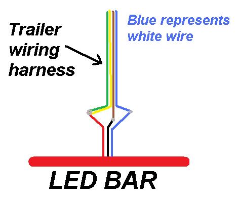

I've been rewiring my 16' utility trailer and I'm adding an 9 LED light bar on the back of it. It has 3 wires, Red, Black, and White. I know that White goes to ground on the trailer and the instructions state "Attach the Black wire to operate the dimmer illumination of the light.Attach the Red wire to the Stop/Turn circuit to operate the brighter illumination of the light." So I attach the Brown harness wire to the Black LED wire. But the Red wire on the LED bar has me confused. Should I connect both the Green and Yellow harness wires to the Red wire? Or will that mess up the turn signals by doling that? I've attached a drawing showing the proposed wiring as described.

Does this light bar have each side flash with turn signals or just get brighter with the brakes? Thinking it should just have a ground and power from your parking lights. If they are designed to come on brighter with the brakes, then you would have to attach the same wire as your brakes (either red or blue). You may have to go back to the axles to get the brake wire as I have seen them switch to the three wire behind the axles to cut costs. If the light bar flashes with your turn signals, then you would have to attach to turn signal wire for each respective side.
Kind of depends on how the light is supposed to function after being hooked up. Need more info!
/ Trailer wiring question #3
To use this you will need to connect the green and yellow wires to the red wire with a diode on the yellow and green wires (a diode is like a check valve, it only lets power flow in one direction) OR you will need to tie the red wire into your electric brakes.
If you connect both the green and yellow wired directly to the red wire as shown, you will flash all three lights with either turn signal.
Thanks,
Mike
If you connect the green and yellow to the red, your turn signals will operate like hazards when you signal left or right. You need to isolate them with diodes as others have mentioned.

OK this is meant to be a left or right S/T/T, not a clearance marker/3rd brake light. You can use it that way I suppose, but again you will have to use the diodes.

Even if you hook the center light up with diodes, it's still going to flash when you use either turn signal. The only time it won't is when you brake while you're applying the turn signal.
My suggestion... Connect the black wire to your marker circuit and forget about the red wire. Problem solved. You have a clearance marker light on the back and you don't have to worry about isolating the turn signals from each other.

The problem here is that trailer wiring doesn't usually have a brake light option. There are marker lights and there are "signal" lights. The same wire runs the turn signal and the brakes. If you apply the brakes, both lights come on. If you apply a turn signal, only that one side comes on (and blinks). The challenge is how to illuminate this center light when the brakes come on, but not blink when a turn signal comes on.
I don't see a good way of doing it. Even a 7-way trailer plug doesn't have a dedicated brake circuit other than the electric brakes. I agree with others that tying into the e-brakes is a bad idea. You could run an extra wire, but I couldn't even tell you where on the truck to pull the power from. Your signal lights on the rear of the truck are likely wired the same as your trialer (i.e. no separate brake circuit)

Is there a way to wire this center light so that it only illumintates when BOTH signal lights are on? This way when both signal lights come on (i.e. when braking) this center light would come on. When only one is on (i.e. when applying the turn signal) the light would not come on. I'm sure there's some kind of relay or something that would require two inputs in order to energize the output.
Oh, Dang! That still gives you a blinking light when you apply the brake while you're turning.
Nevermind. I'm back to just wiring this center light as a marker light and leaving well enough alone.
