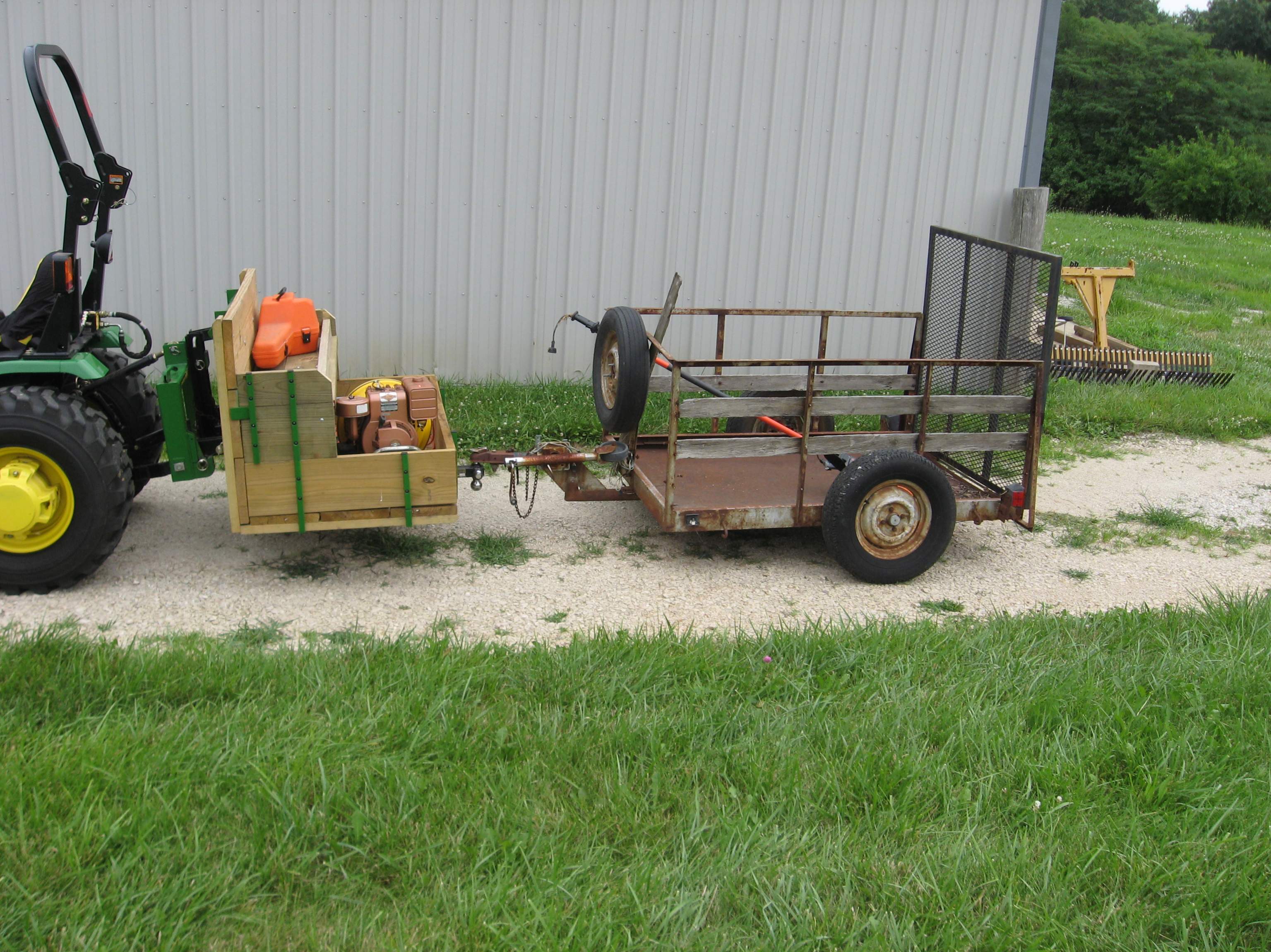

I have a low-boy that my Dad built about 40 years ago. More of a cart than a trailer, but it is licensed and I have used it for years. As stated before, it's not too bad with low air pressure and a load, but is off the ground half the time when it's empty.
Now, I use it primarily as a yard cart, but it still does see occaisional street use to haul non-breakable stuff.
That being said, I would not pay money for a trailer without springs to be used on the street.
