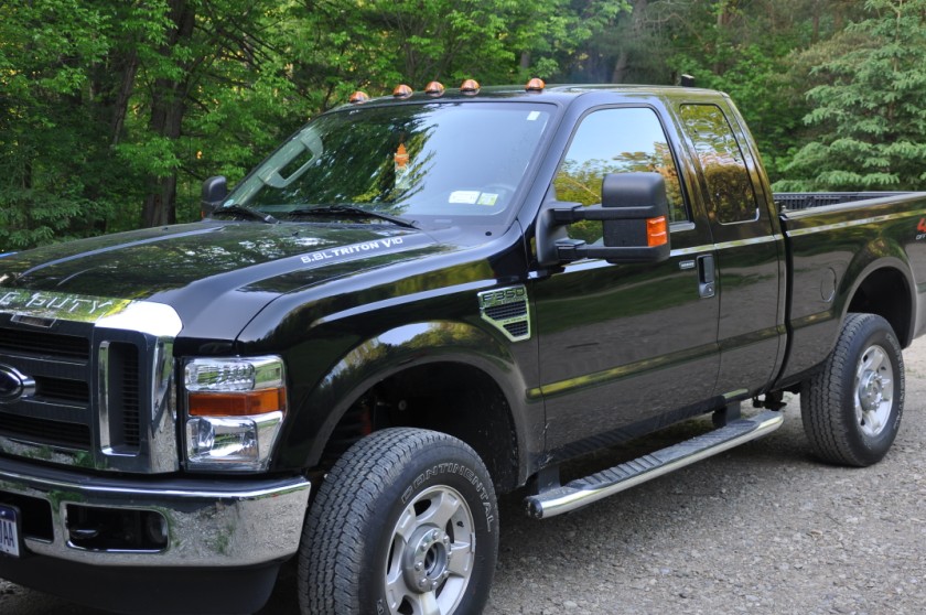

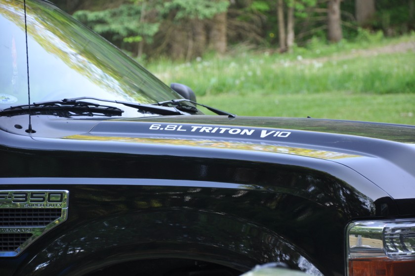

One other thing. If you are considering a gas truck hurry up and buy a F-350 with the V-10. Its the only gas offering with any balls still out there. Ford is making a big mistake and canceling it after 2010 and opting to take the same route as Dodge and GM and going with smaller displacement higher revving gassers. Great for race cars but not for trucks that need low end grunt like the V-10 makes. Dodge did away with its V-10 gasser a while back when they went Hemi crazy and GM canceled the 8.1L monster 2 years or so ago now forcing you to have a pig or drop another 8 grand or more for a diesel.

That's what I'm talking about. I had a 5.4 in a 250 and it was terrible. I have a F350 w/ V-10 and gets better mileage on the highway and tows great..
