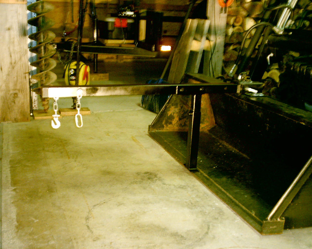

For the money my WalMart has a weather tight Rubber Made box that is about 24" long x 16" wide x 14" tall. I have one on the tonge of my car haul trailer and have put about 1/2 dozen on boat trailers for customers. I have 8 2" ratchet straps, 4 6' long chains, gloves, controller for my winch, a jack stand, 8 strap corner protectors, and 4 axle straps in mine. Its stuffed but works great for the $15 or so it cost.
You can kind of see it in the background of the picture I took of my FEL boom pole.
