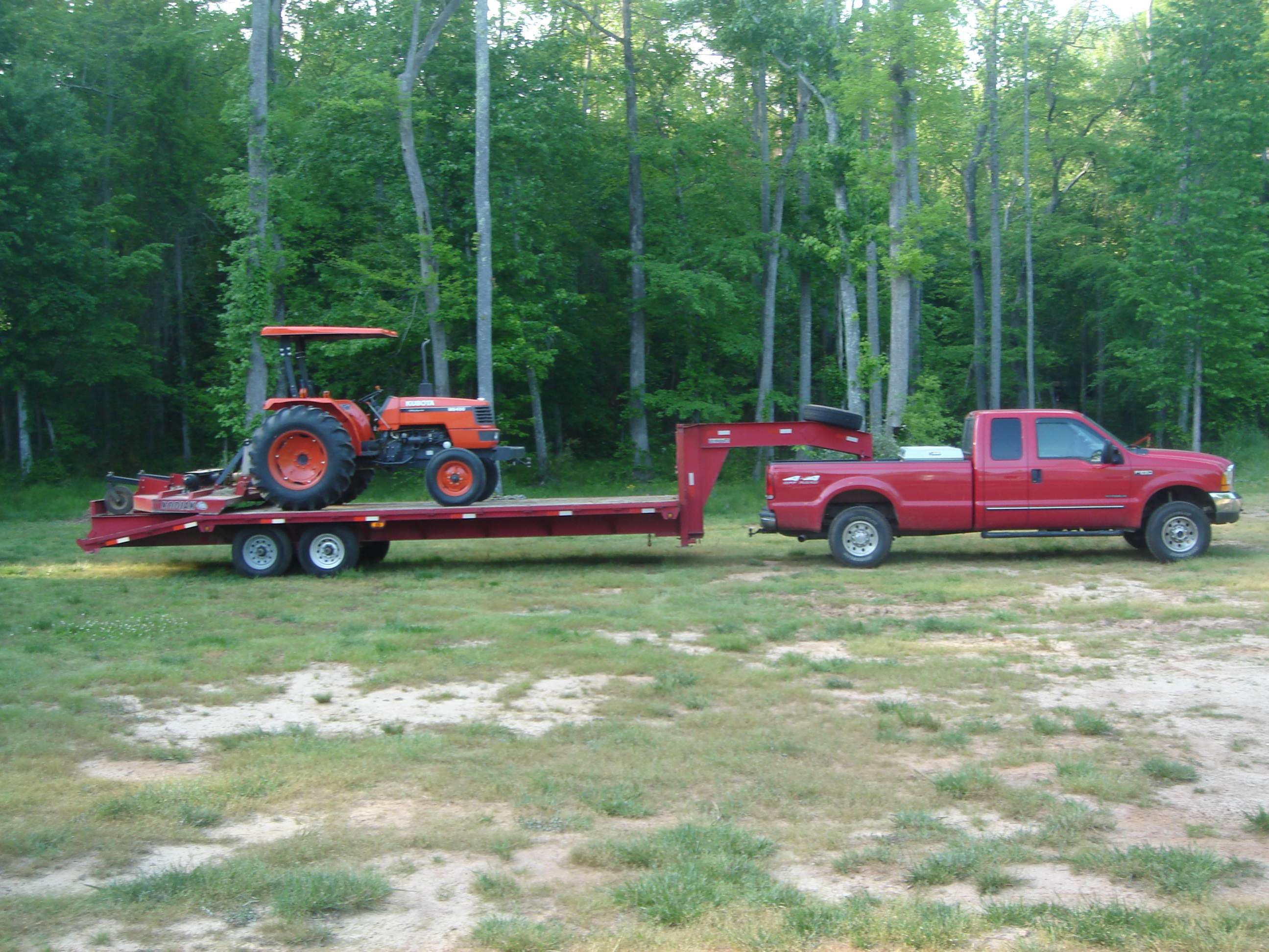

Not enough trailer. Kubota's website lists that tractor at 3,620 lbs. dry weight The front end loader on my TC-45 weights 900 lbs without the bucket, so we can assume somewhere in that ballpark. Let's assume 300 lbs for the FEL bucket and 300 lbs for the box blade. Grand total is 5120 lbs. Trailer capacity 7,000 lbs minus trailer weight 1,500 equals payload of 5,500 lbs. Only 380 lbs of margin. We haven't added fuel, chains and binders yet. Also factor in not enough room to move tractor fore or aft to balance the load.
I fought this problem for years until I bought a gooseneck. I'll never go back to hauling that much weight on a bumper pull trailer.
I tow set up in picture all over North Georgia and Eastern Alabama. Tows smooth as silk on the interstate at 65 to 70 mph.

Your picture preempted my usual suggestion, which is "weight too far back".
Here's something that MIGHT work;
Keep the tractor right where it is, but raise the height of the hitch ball.
This will increase the load on the ball AND increase the load on the REAR axle.
G_E_N_E_R_A_L_L_Y this will lead to a more stable trailer.
Many folk don't realize that the hitch load actually decreases as the truck springs compress, so what you might measure at 19 inches or so if you rig it up to check the load on the hitch won't be the load on the hitch when the truck has dropped 2 or 3 inches.
/ Trailer Sway #31
Ooops, I guess I only glanced at the pic and ASSUMED that it WAS backed on, e.g. truck at left of picture.
Now I'm ASSUMING that your rear tires are loaded, that could make a 1,000 lb or more difference.
The way you have it, the box blade probably makes it worse too.
Yeah, get the C of G slightly ahead of the front axle, by backing it on or by folding the bucket differently.
CHECK the tongue load AT THE ACTUAL RIDING HEIGHT, as I said "where the truck squats to".

you might try backing it on (as has been said) and/or putting the boxblade in the bucket, that will move some of the weight to the other end of the trailer and may be enough to even the load on the trailer. Just make certain you have it well tied down.

I tow bumper pull, tandem axle trailers a lot both equipment and RV.
1) A W/D system is almost always required for tractor towing since the standard receiver hitch on our pickups is only rated for 500 tongue/5000 trailer without one. The W/D system allows you to legally tow your trailer. If you had a better hitch, such as a mobile home hauler, then you could skip it.
2) A W/D hitch is not sway control. It is not intended to reduce sway and is not a crutch for sway. The W/D hitch simply distributes tongue weight to both axles of the tow vehicle. This is greatly helpful for steering, breaking, and comfort issues.
2a) They make a bandaid device that is a frcition sway control device that is intended to limit sway. The folks that use these devices are admitting defeat at not being able to properly set up their load.
3) A standard tandem axle trailer has a funky linkage between the two axles that compensates for the trailer being unlevel. Meaning it doesn't really matter if the tongue is high or low since each of the trailer axles will have the same weight on them. Of course, this is only within a reasonable range.
4) The OP's trailer has 5 lug wheels so is at most a 7000# trailer. The tractor looks heavy, my 30 HP tractor with loader and BB weighs 4500#. I can't imagine the OP's load being within the ratings of that trailer but maybe it is. Worth checking.
5) GN trailers suck at making tight corners. The trailer tires track way inside the truck's path. They are slow to react when backing as well. Can't haul big loads in the bed either. I hear that they are super smooth when cruising down the road though.
I recommend trying the load backed on. GO to a scale and verify that you can get 10-15% tongue weight. Also verify that the trailer is not overloaded. If that fails then get a longer trailer with two 5200# braking axles. If you are doing hauling this machine to side jobs and are underinsured then it would be wise to be conservative with your ratings.
