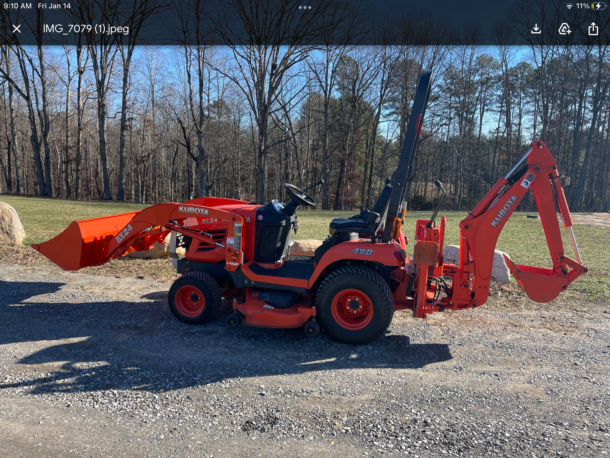

Hey guys,
I’m excited as I have just purchased a BX24 TLB and I’m looking wondering what trailer works best without breaking the bank. I’m very familiar with tongue weight, weight distribution, strapping the tractor down. I also understand the difference between the axel, payload and gross weight. I can compare the specs on the tractor and make sure the trailer is big and strong enough. I have looked at a bunch of forums on here already. My question is can y’all please recommend the make and model trailer that works well for the Kubota BX24 TLB?

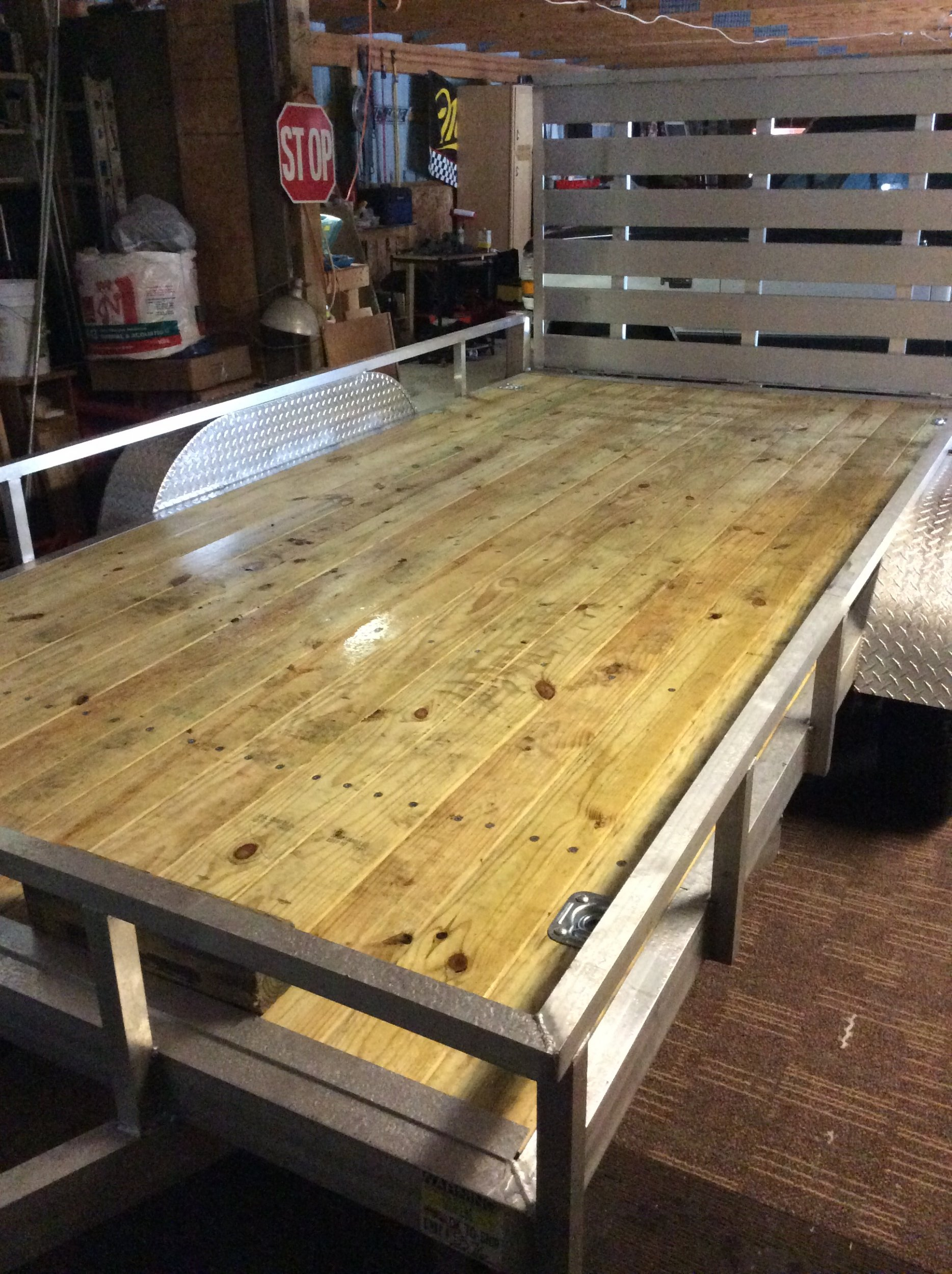

I use a 14' aluminum trailer. 5k capacity for my BX25. It has brakes.

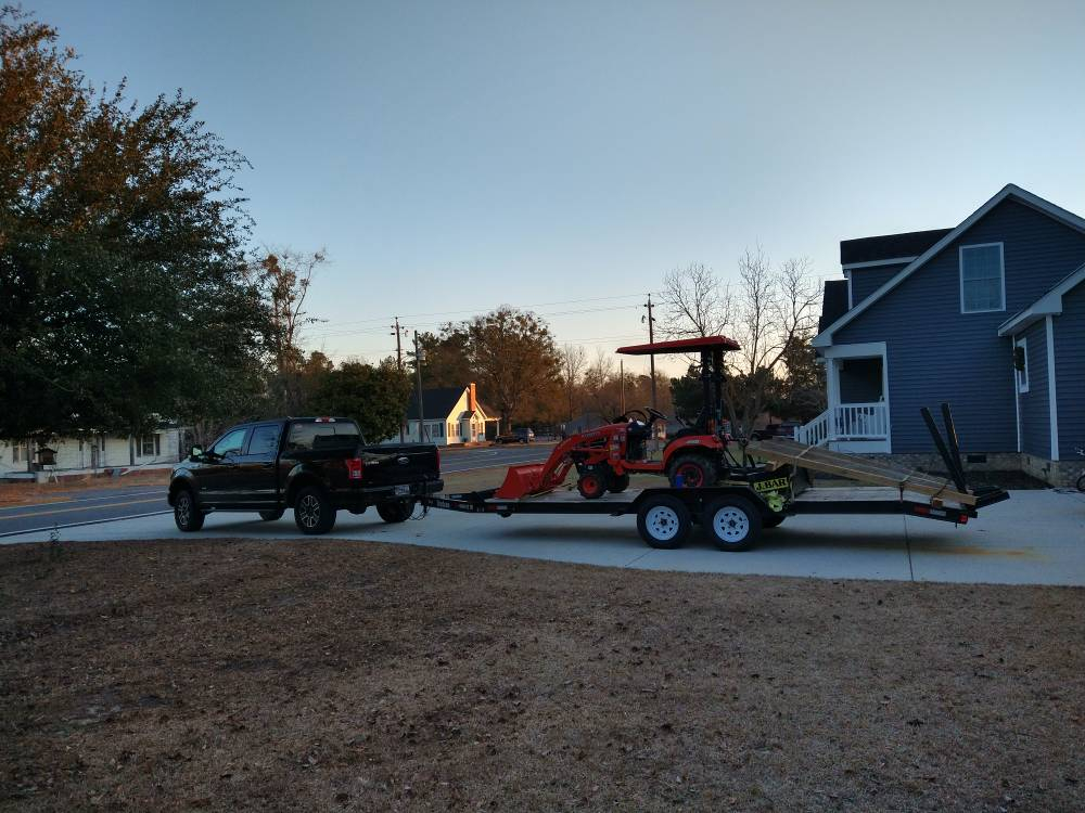

I have a BX, and bought a 20' trailer to haul it with 2 3500 lbs axles. The trailer is a good match for my half ton truck, and will max out my truck's capabilities.
I'm in the same boat as mewmaxowner.... after going through several trailers I finally bought a 20' 10K Kaufman for my BX. Tow vehicle is a 1/2 ton GMC rated for just under 10K.
The additional deck space has come in handy... I mounted a toolbox at the front of the trailer that holds ratchet straps, binders and chains. With FEL and brushog the tractor pretty much takes up all of the deck space... with just enough room to load balance. That 20' trailer also comes in handy a couple times a year doing double duty as car hauler to get family vehicles to the mechanic.
Do I lose some weight capacity with a heavier trailer? Without a doubt, and I'm not necessarily advocating everyone overbuy on trailer weight ratings. Everyone's needs and preferences are different. However, and this is a huge thing for me, that 10K Kaufman pulls like a dream compared to the lighter and shorter trailers that I previously owned.
Nothing against a 20' trailer, if I could fit it in my available space. My 16 can handle my BX24 w/FEL and Hog - with the tail wheel just hanging over the end. Weight is perfectly balanced.
Put a trapeziod tool box on the triangle tongue with enough room for all my tractor-related clobber, and fabricated a spare tire holder that sits between that and the trailer deck.
Just some alternatives for those of us who can only aspire to a bigger rig ;)
