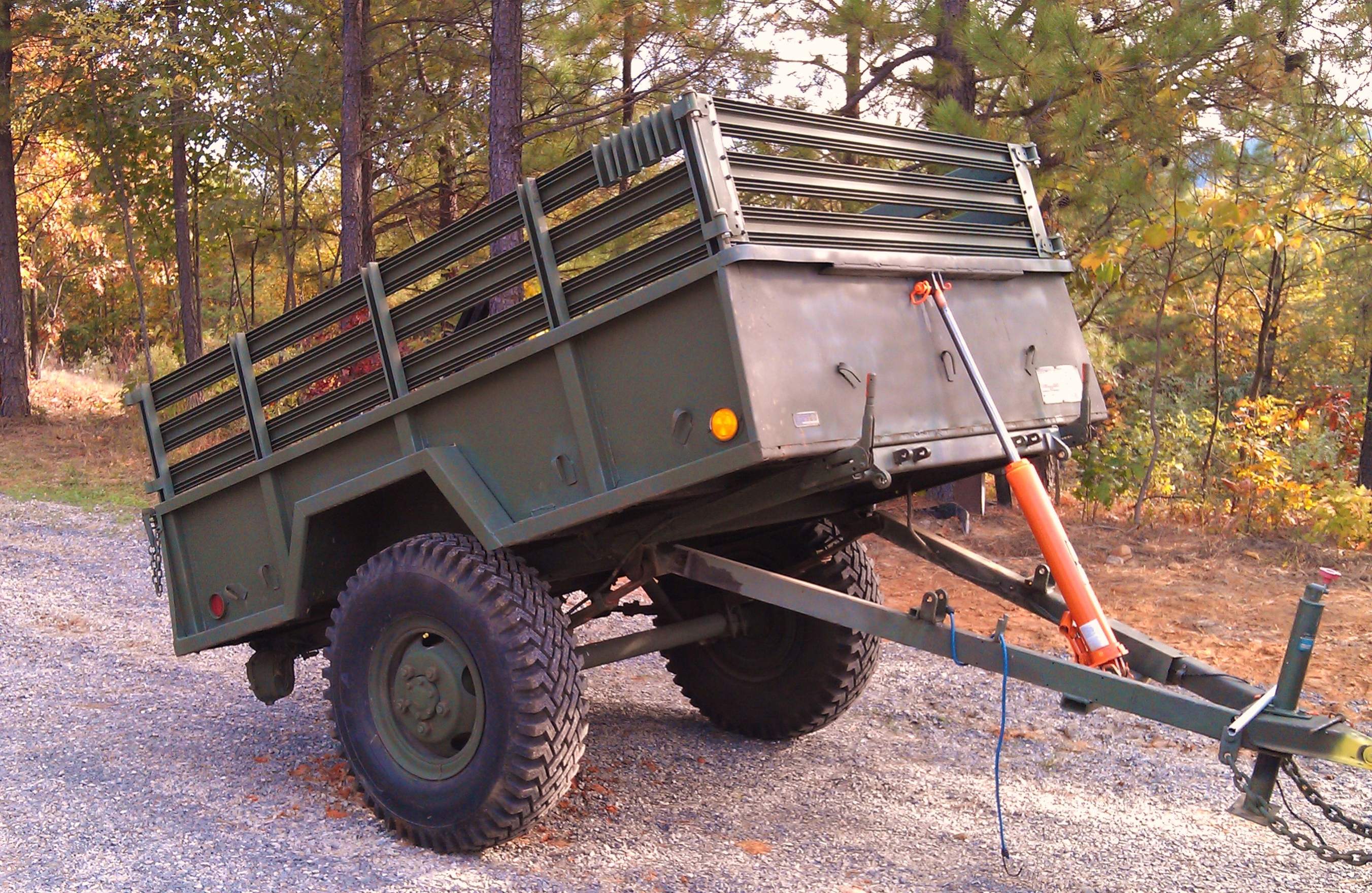

[I]Good for you, the kids will love it. I have open "pickets" with 6" boards on my ARMY trailer. I think your own suggestions are right on. I would build it about one foot HIGHER than a hay bale.....or two bales if you're going to stack them. That way a rambunctious kid can't roll off onto the road. 2X4's should be fine. I would use PLYWOOD NOT OSB.....Ply can take moisture better and will not produce sharp splinters or delaminating strips to hang up on skin or hay. Some rainy, tired day you might leave the hay on board and it gets rained on.....be nice if it didn't ruin your panels. Have fun, you're a good man :thumbsup:[/I]

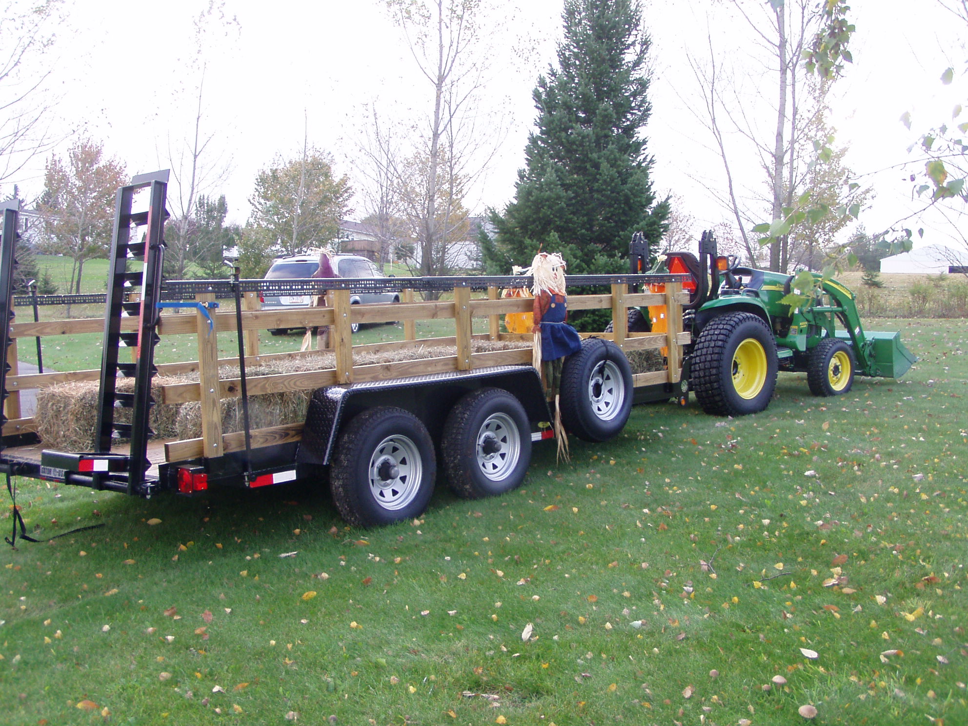

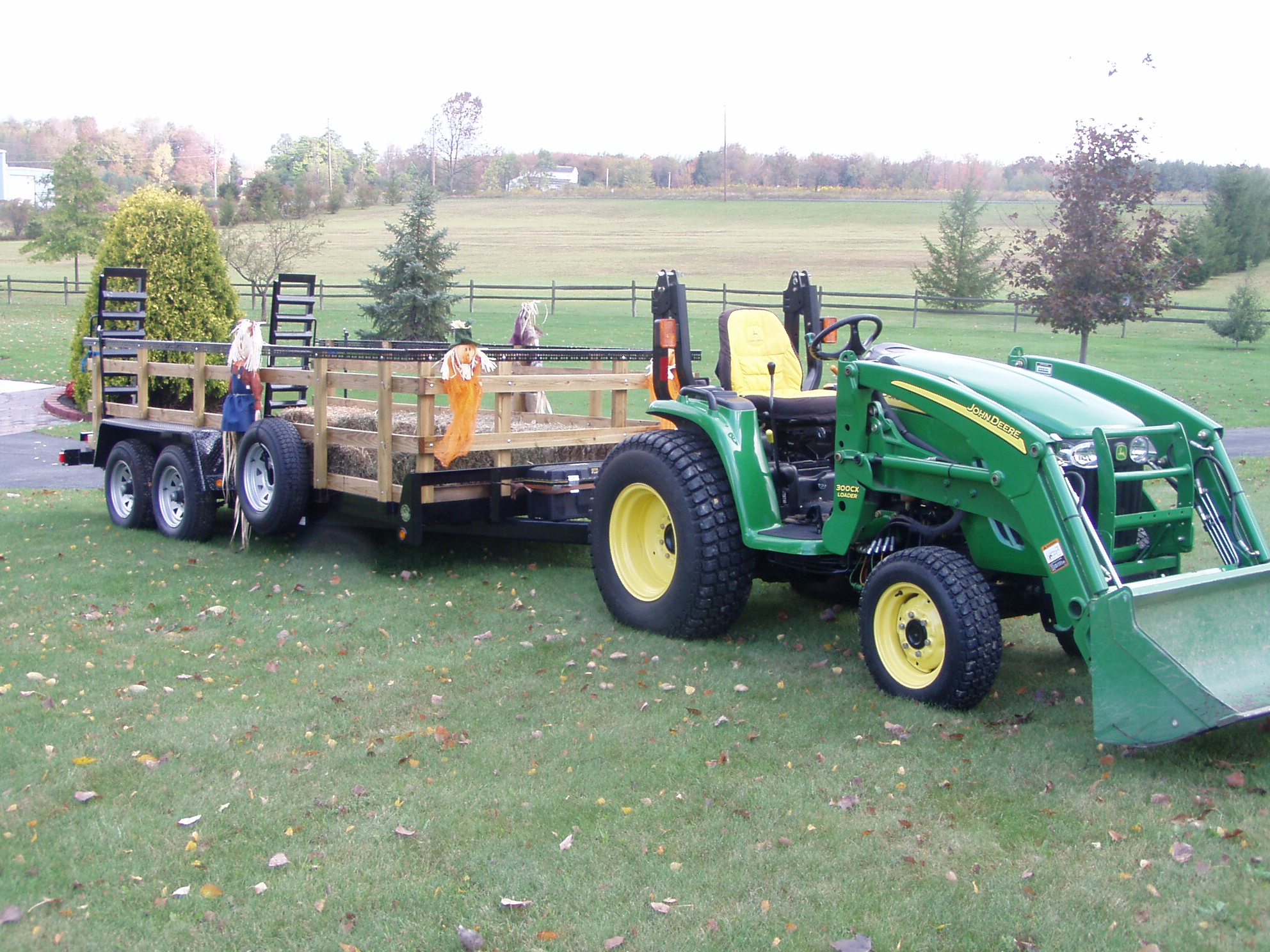

Here are some pics of the trialer I use for the same thing every halloween. First post, glad to among you all. Den

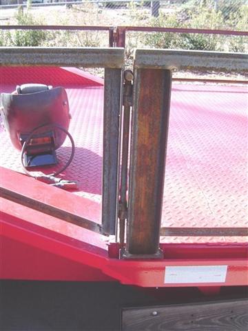

Here's some pics of how I did my 20 foot trailer when I first got it. I made the sides in two pieces connected by a metal rod, since handling a 20 foot side would be too hard to handle. I used carriage bolts and treated 1x6's. I made the sides 18 inches high. I am satisfied with that height.
Also...frustrated with this picture uploader on this site...I wanted all six pics to show as thumbnails, but they won't.
