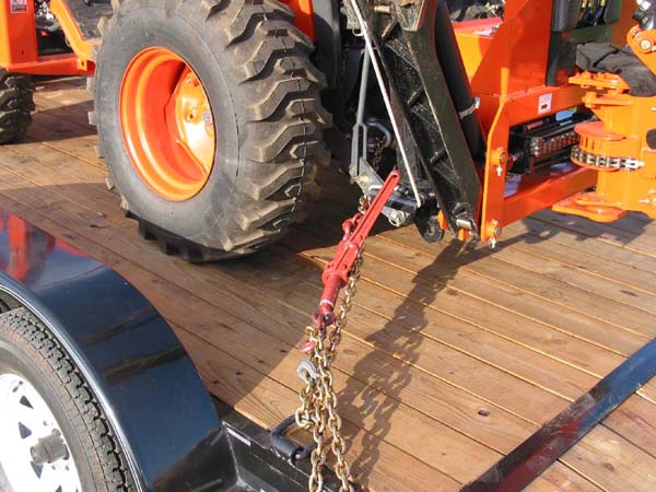

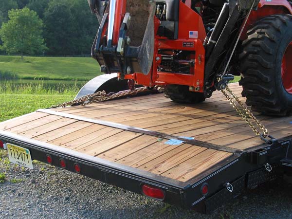

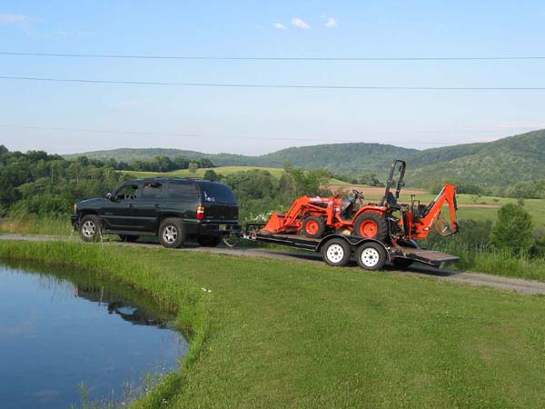

Well, we finally had a clear weekend in this area so I made my maiden trip with the tractor in tow. In appreciation to all who helped me with their advice in this thread I am posting a set of pictures of my rig. I took the pictures at the end of the trip, 110 miles. Except for a four mile climb up a mountain on Route 17 the ride went smooth. I just tucked into the line of over the road trailers going up the long hill, if I tried to go over 50mph on the hill I was going through too much shifting between gears, even with the tow lock engaged.
Thanks again to everyone for their help, the D-ring placement was on the money, the tractor balancing wasn't difficult with the instructions given and using chains and binders was very reassuring. I stopped twice to check the tension, I chalked the tractor tire and trailer deck and that puppy never moved the entire trip. She was locked down solid. I used two tie downs plus a security chain that was set beneath the FEL and around the front axels just for extra safety.

Great pictures - keep them coming as you improve the system. Do you have a sway bar on the hitch?
